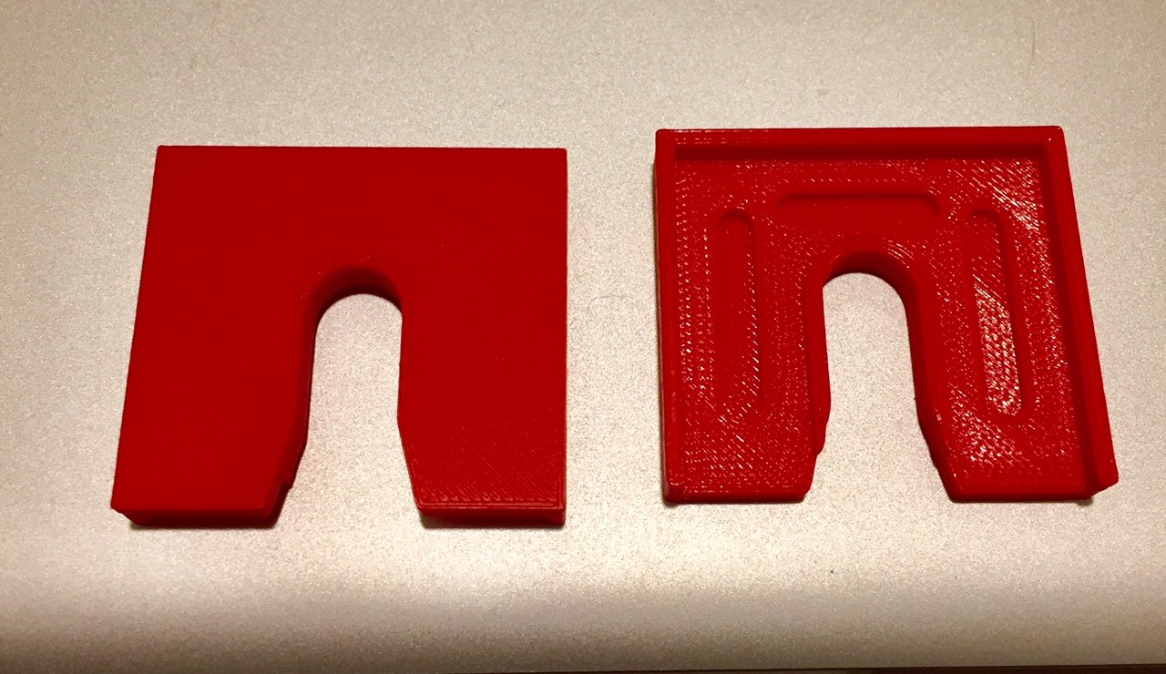

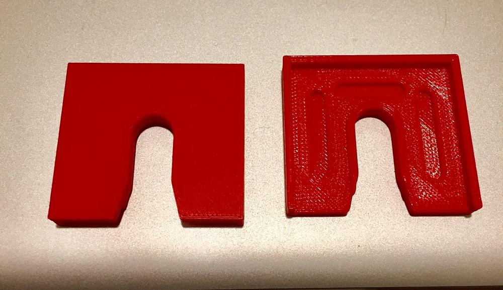

                        Dahawk:
                        Thank you for sharing the file on the Avanti Nose Brace. I'm not a 3D printer guy (yet....), so I clicked your link and ordered three RED braces from Print A Thing (I ordered two for spares - hopefully I won't need them). I got in on the pre-order for the RED Avanti, so I hope to see the jet later this month - can't wait!! Anyway, Print A Thing charged me $1.89 each, plus a $4.50 printer set up fee, and a $4.50 shipping fee - total for all three pieces was $14.67 (plus $1.00 for a tip as recommended on the site). I ordered the braces on Friday (8/31) and got them today (9/4). I can't wait to receive my jet and get the brace installed. The picture shows the top and bottom view of the brace, and of course I will drill the holes for screw access. My sincere thanks for sharing the file for us non-3D printer guys. If we ever meet, the drink is on me!

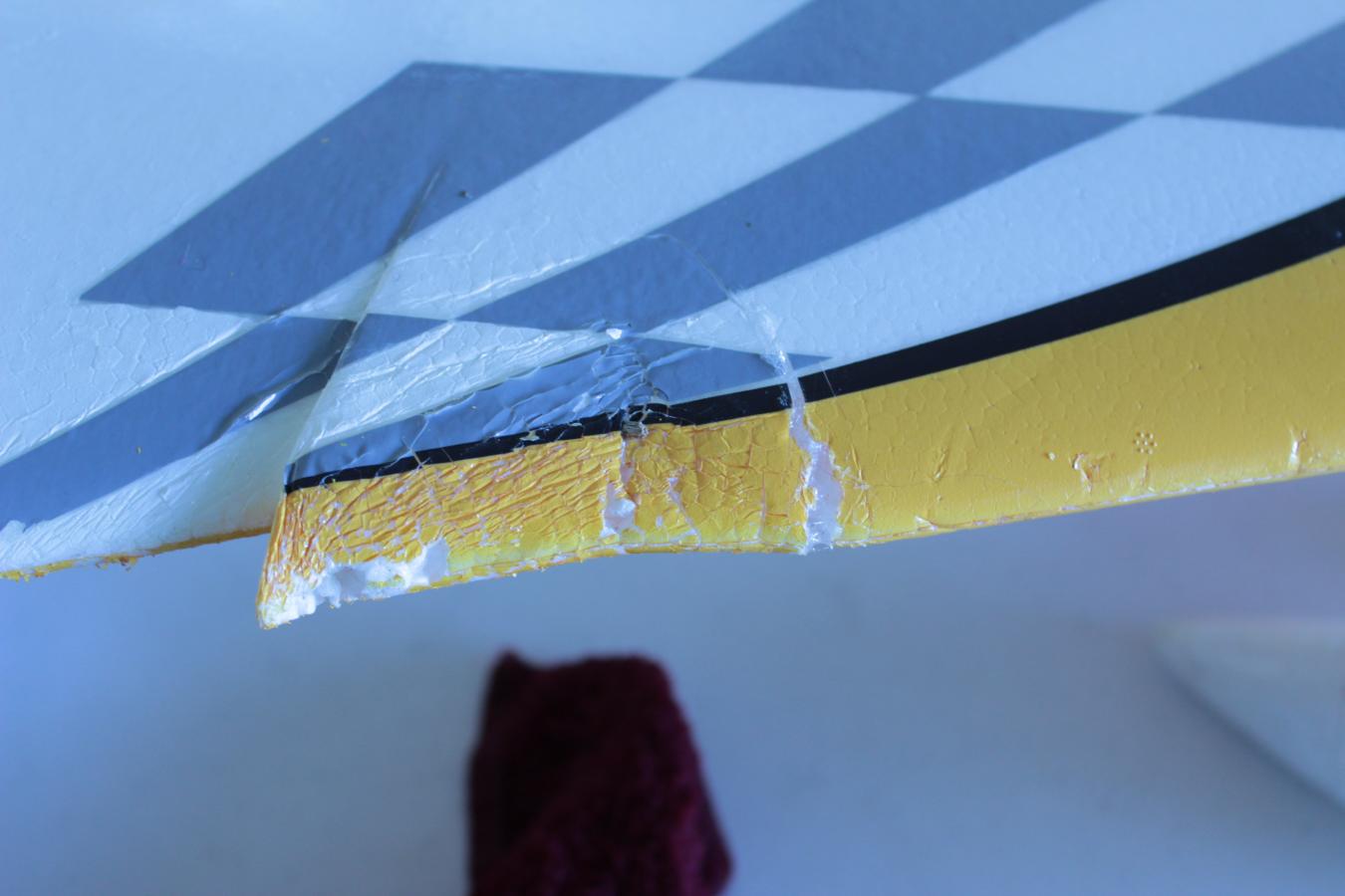

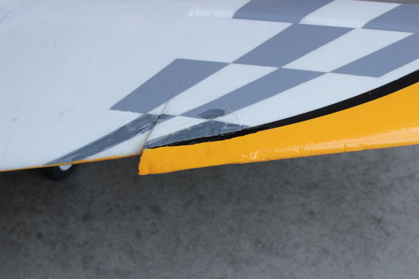

                                    My Avanti had an argument with a sagebrush. the result was the leading edge of the wing got dented in. At first I was just going to get another set of wings, but then I considered it a challenge to repair her.
                                    First step was to lay a soaking wet towel over the damage and heat the area with a hair dryer
                                    this is after the steaming:

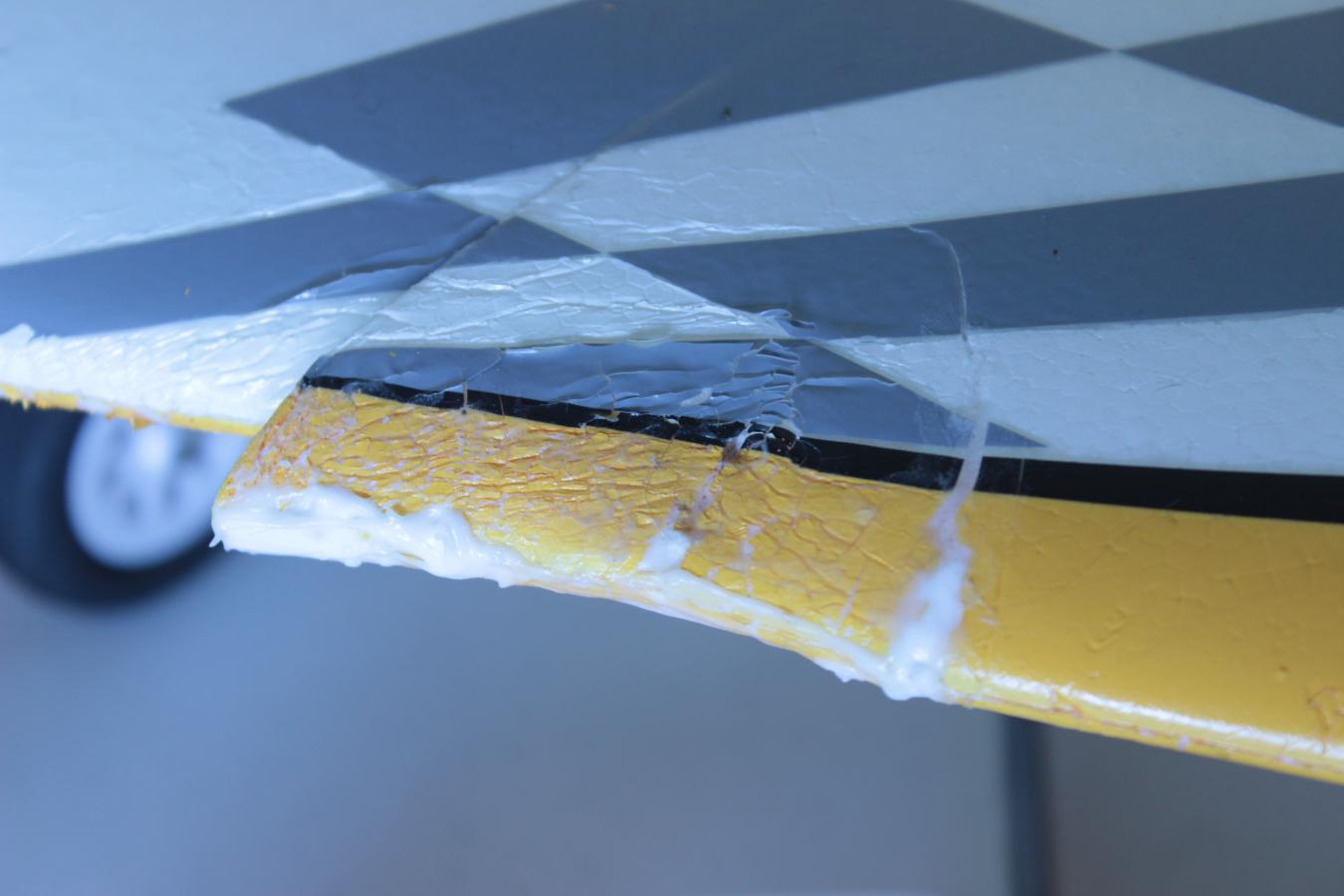

                                    Then I started working it out and used Foam-Tac in the cracks and Foam Filler on the leading edge to regain some of the strength.

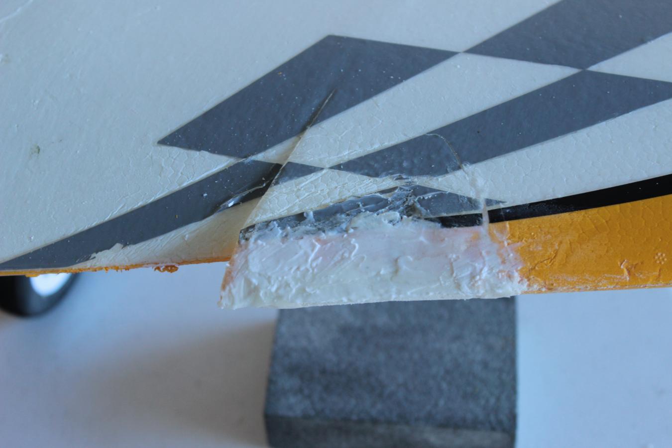

                                    Afterwards, the whole surface was covered in Foam Filler and sanded several times Click image for larger version
                                          I'm not familiar with foam filler at all.
                                          What is is like, what is some brand names, and where can you get it?
