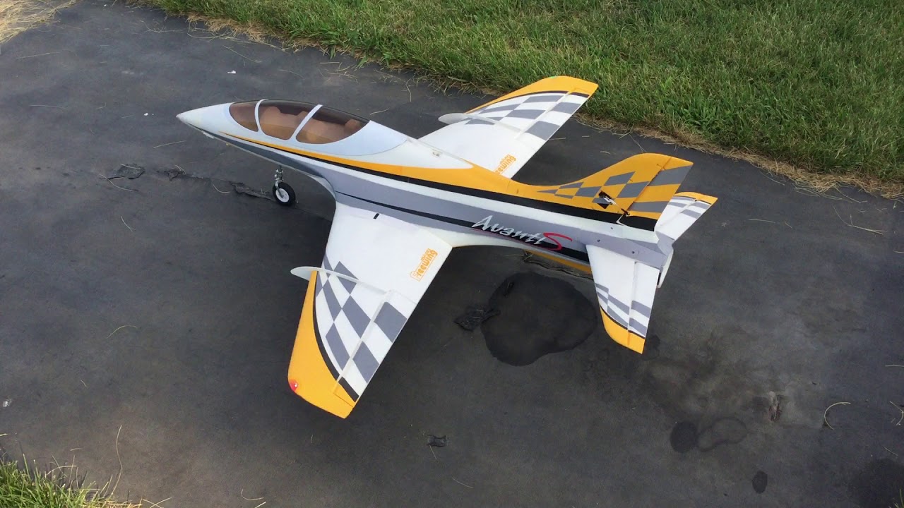

A few days ago a buddy was flying his Avanti, he liked to do bounce and goes on the runway or grass, that's a high speed touch and go with the gear UP. :)
Anyway he wasn't thrilled with the plane and he preferred his Stinger 90 so this plane was for sale. On the last flight he attempted a bounce and go and it went poorly, the nose dug in and the plane came to a halt very quickly. The nose cone popped off and some foam on the nose was damaged. I looked over the damage and decided to buy the plane anyway, I could put a new fuse on it and have a practially new plane for less than the cost of new. We could not find the missing piece of foam in the grass from the nose or the second magnet that holds the nose cone on.
Last night I took some foam from a wrecked F-86 and made up the part for the missing foam on the nose and I pulled the grass that was in the engine inlet out and cleaned that area up. I sanded the foam down so it had the right shape and since the magnet was lost I decided to glue the nose cone to the fuse (I plan on replacing both pieces anyway). I test ran the engine for a few seconds to calibrate the ESC and it seemed fine. I got everything set up in my transmitter and the CG marked, I was ready to fly. I figured I'd fly it this way since the replacement fuse it out of stock for a few weeks.
Tonight I went to the field to fly the plane, Terri was taking the video. As soon as I advanced the throttle I heard a bang and the EDF did not sound right, in the video you'll see it spit out a few small pieces of foam. I started it again and it did not sound right so I abandoned trying to fly it.
Someone suggested that it sounded like the fan was missing a blade, sure enough when I looked at the fan it was missing a blade and another was damaged. Behind the plane in the grass was the chewed up foam from the missing nose piece AND the magnet. The noise you hear when the engine starts is the magnet being sucked into the engine destroying it.
I found that the fan blade is $17, a whole new EDF assembly (minus the motor) is $22. It makes sense to order the entire assembly, now I have spare parts if I ever need them. I hope the parts are here on Friday so I can try to fly it again this weekend. To repair the EDF will be an easy and straight forward job.
I should have inspected the plane better than I did since we were not able to find the part that broke off, it never occurred to me that it could have been hiding in the plane.

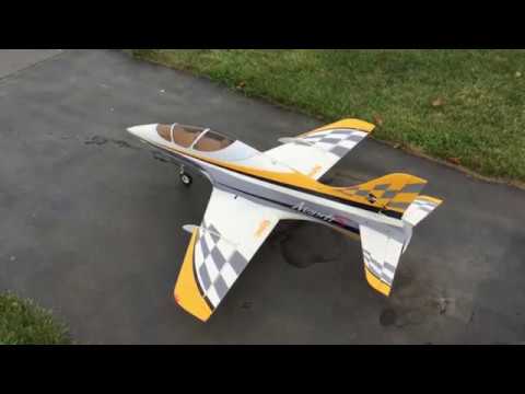

After my post a above about the EDF problem I had I now have six flight on the plane.
This is a sweet flying plane, on the second flight I reduced the aileron throw another 10% from the suggested low rates and I liked that better. I'm running 30% expo across the board. As you'll see in the video I can in to hot, on the second flight I did a few touch and goes and the final landing was spot in speed wise. She is a floater if you have a little extra speed.
