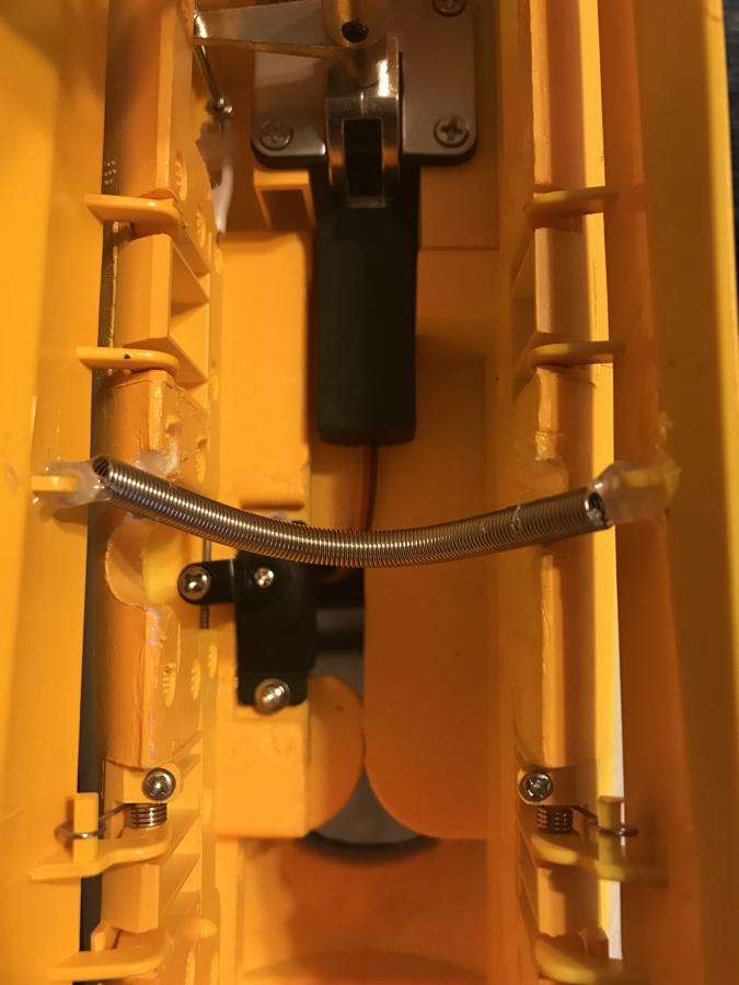

                                  Over the time period of all those flights, below are some things I’ve had to maintain. I’ve always perform the typical preflight inspection before I take it up in the air such as check all the screws, mounts, control surface directions, hinges, etc. I also keep an eye out for when I need replacement wheels as I fly off a paved runway and that naturally wears them down. The lights have continued to work, the control box works as it should, all the original servo’s funtion fine, and the retracts and landing gear are still original. This Avanti has really required minimal maintenance :).
                                  As for small details on fixes of abnormalities, there are just a few.
                                  - I’ve had only a few main gear hang-ups, when one of the main gear strut covers isn’t positioned right, not from being loose, but likely from the strut spring wearing a tad over time, just enough to not allow full retraction. Barely trimming the main gear strut cover fixed that issue instead of buying a new spring or gear. The retracts and wheels still fit fine in the wheel well, so there is not a need for me to get new retracts or struts yet. I’ve had some nose gear hang-ups as well, but that was due to the spring, which is described below.
                                  - This is not a fix I did, but it could be one if it bothers the owner enough. The nose gear doors are made of a very flexible plastic and can sometime come slightly distorted from the factory and don’t perfectly align. They can either be very gently bent to the proper position, although it is not going to be perfect, or carbon rods (or preferred material) can be glued to each inner nose door side in an aligned manner that allows the doors align near perfectly.
                                  - This next one to me is more important than the nose gear doors explained above. The nose gear door spring over time moves too often, and into a position that does not allow the nose strut to retract fully or it provides too much tension on the nose retract and the nose gear doors. You may see the spring rotated so much that it hangs down toward the ground, and that is what you don’t want to see. It was a very simple fix. I noticed the nose spring was able to rotate freely almost circular, allowing it to fall into an abnormal spot, so I extended and retracted the nose gear with the plane inverted several times to take note of the position of the spring in the best spot to eliminate hang-ups and overly taxing of the nose retract mechanism. With the spring in the proper position, I used hot glue where each side of the spring attaches to the nose gear doors to lock the spring into place and inhibit any rotation of the spring out of its proper place. Once I did that, I checked if the spring needed to be barely stretched at the ends to reduce stress on the retract mechanism, yet still allow mine nose gear doors to close fully. My spring tension was okay, so that wasn’t needed. A picture is attached below to show the hot glue on the nose gear door tabs and spring.
                                  What a great jet! It never gets old to me.

                                    Simple fix with the door spring , I did the same a few months ago but i used a dab "Goop" Then my grass field took care of the doors a few times so now i fly with the doors off
