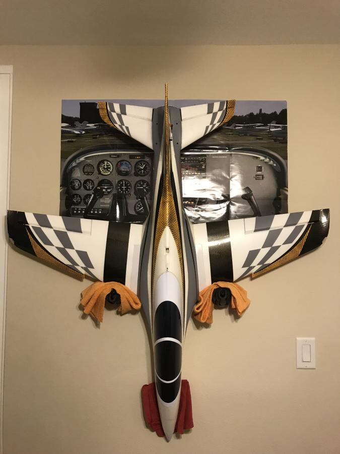

              • After flying over the weekend and still seeing more and more new Avanti’s at the flying field (I think we may be at about 9,000 now LOL), a little painting and design was in order (some carbon fiber accents done a while ago and airbrushed a checkered/carbon pattern in pearl black on top of the yellow paint). This should help ensure I recognize my own plane at the field and take mine home when done, and so nobody else thinks theirs is mine and takes it instead :Scared:. I’m looking forward to seeing the red Avanti’s at the field to make it even easier. Ha-ha
