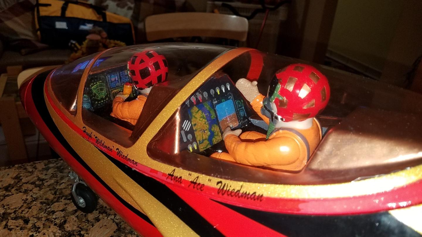

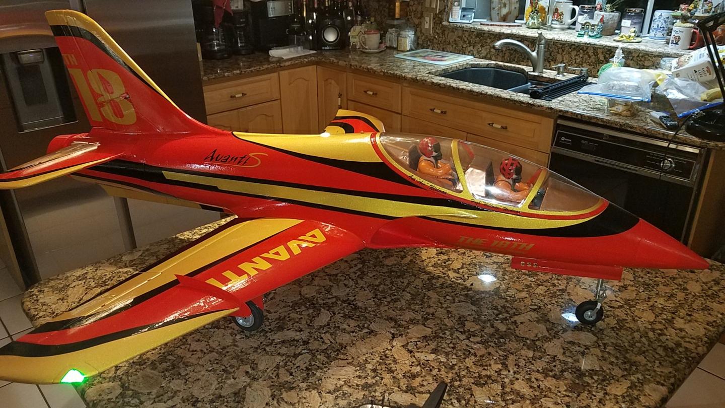

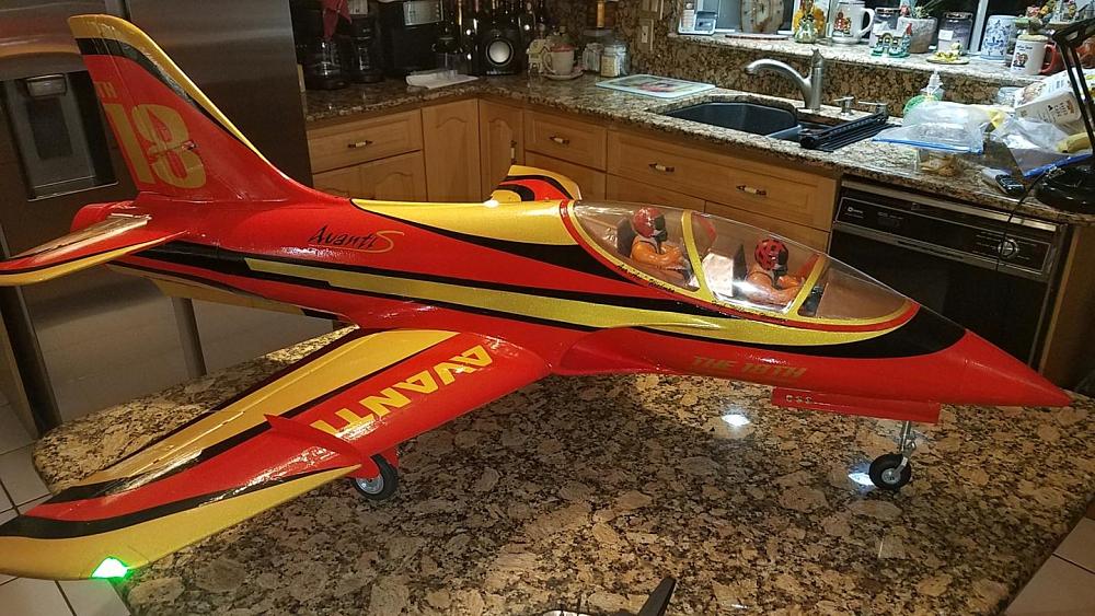

        • Here’s my painted Avanti.
          • Originally posted by kenbry View Post
            That my friend, is OUTSTANDING!!!

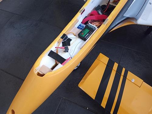

                  • It breaks my heart to have to say this and causes no little amount of embarrassment as well. I lost my brand new Avanti due to a stupid mistake on my part. In an old guy moment, I placed the receiver right beside the battery. I know I know, as I hear the collective sigh!!
                    Of course, at some point, I lost connection and she augured in, expensive mistake.
                    So, what I'd like to see, for my interest and I bet several others as well, is just where you guys have placed your rx's for best results.
                    • Mine is under the battery tray but I have long coax antennae with one going forward to the very front of the battery area and one aft to the very aft and a satellite under the hump aft of the canopy.

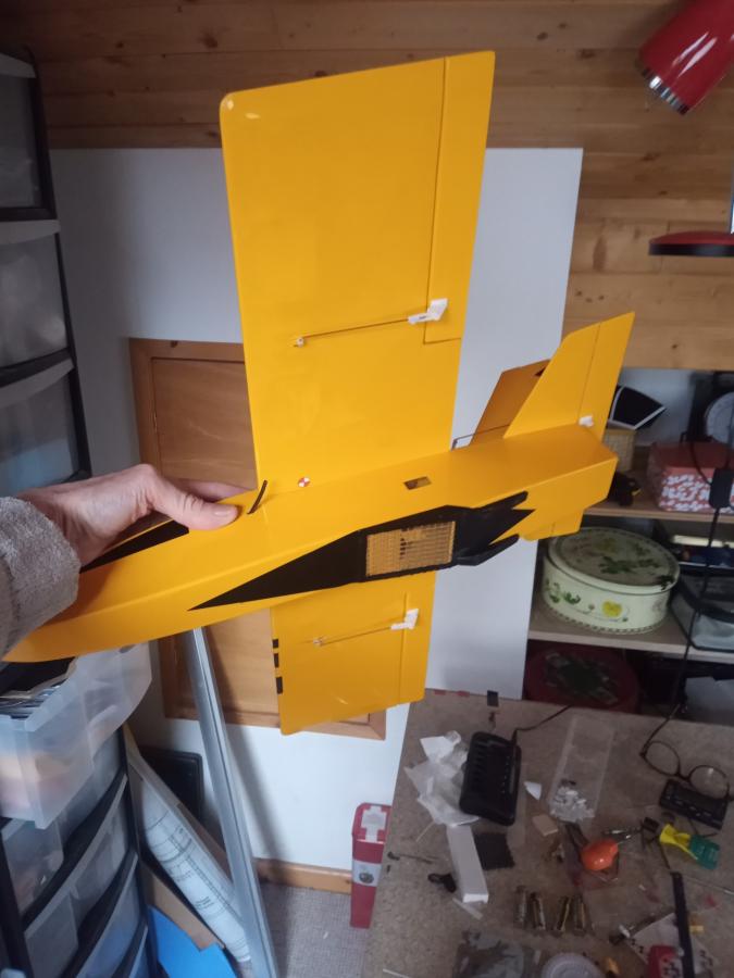

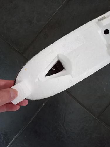

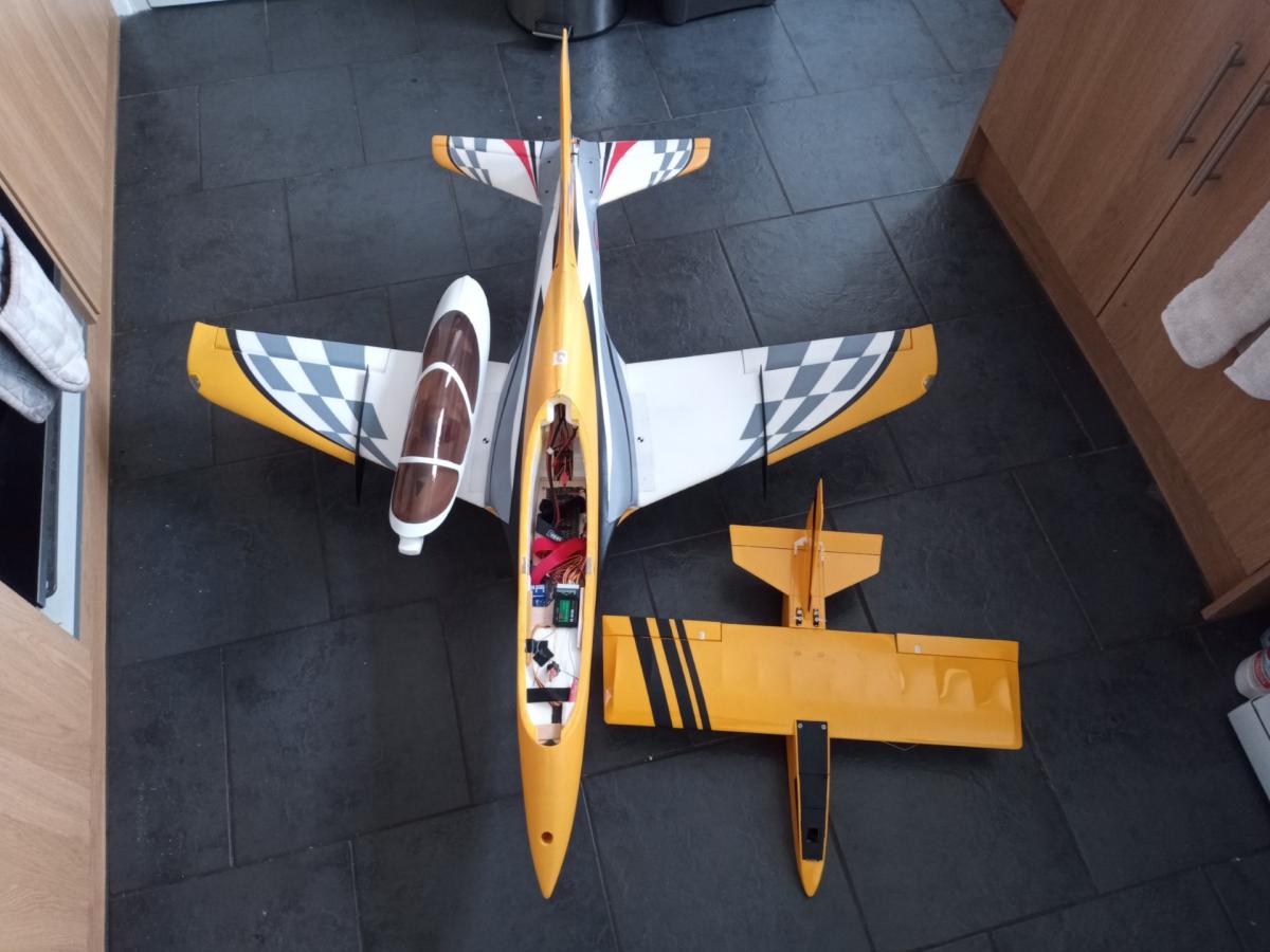

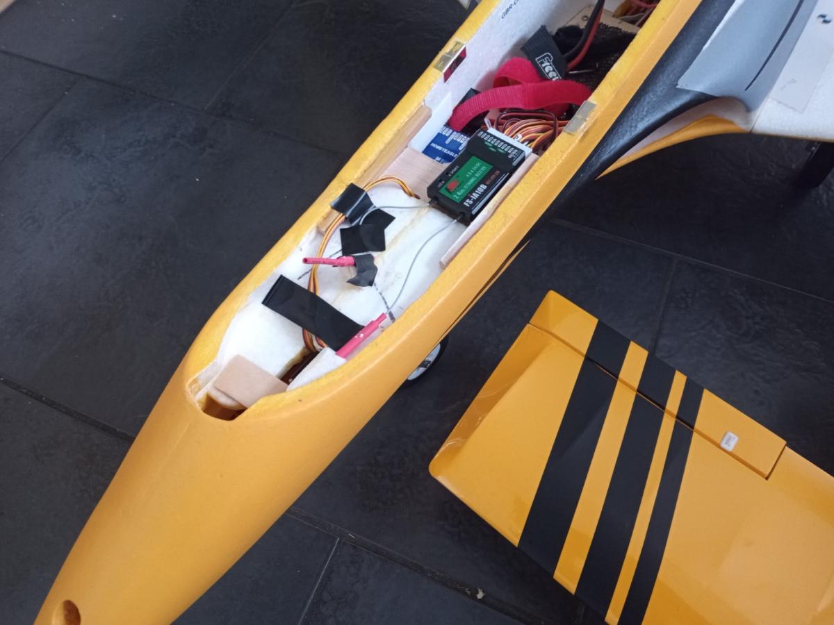

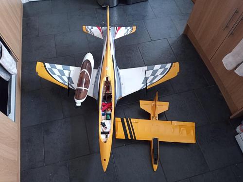

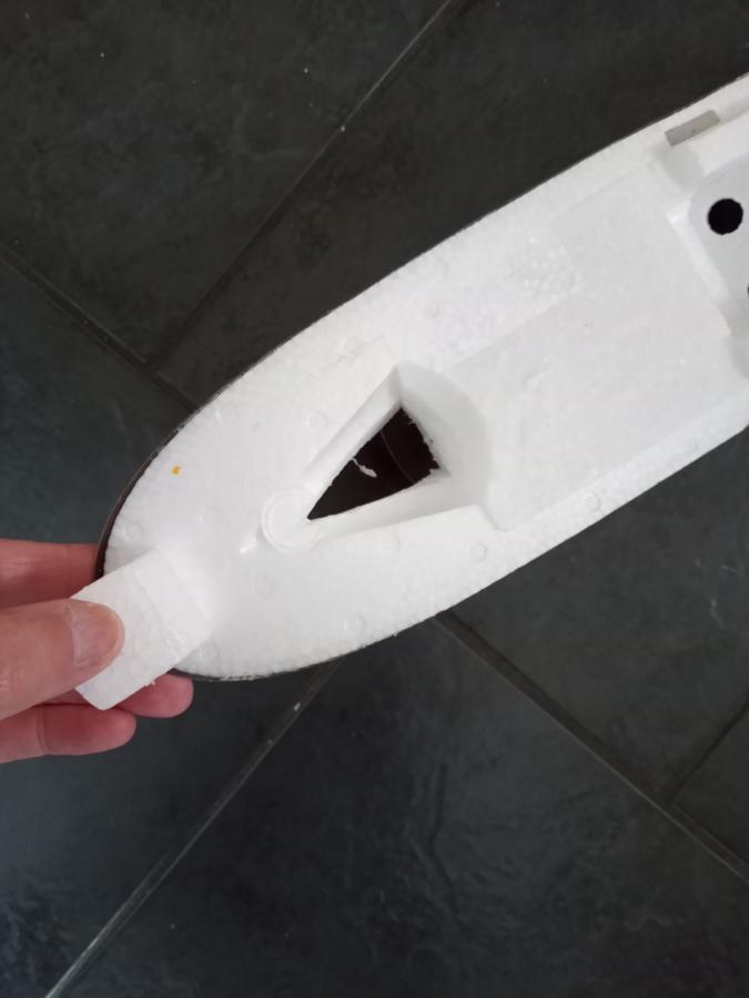

                        This is my rx layout, needs some foam cutting. RX location is at front of canopy, need to cut some foam level where the rx goes. ( Zoom in to canopy top on stbd wing to see hole through tinted canopy. One ariel points forward, the other ariel upwards into cut hole. The little plane is my scratch built 630mm edf with 40mm 12 bl 4s XFly edf and gyro with auto level which I have been using for hand launch at our main field which is still too wet to cut the grass short enough to cut and roll !!!
                        Click image for larger version  Name:	Avanti ariel 3.jpg Views:	0 Size:	98.8 KB ID:	403715 Click image for larger version  Name:	Avanti ariel 2.jpg Views:	0 Size:	94.7 KB ID:	403716
                        Click image for larger version  Name:	Avanti ariel 1.jpg Views:	0 Size:	33.9 KB ID:	403717 Click image for larger version  Name:	630EDF photo 2.jpg Views:	0 Size:	82.4 KB ID:	403718
                        Click image for larger version  Name:	630edf fod guard.jpg Views:	0 Size:	56.2 KB ID:	403719

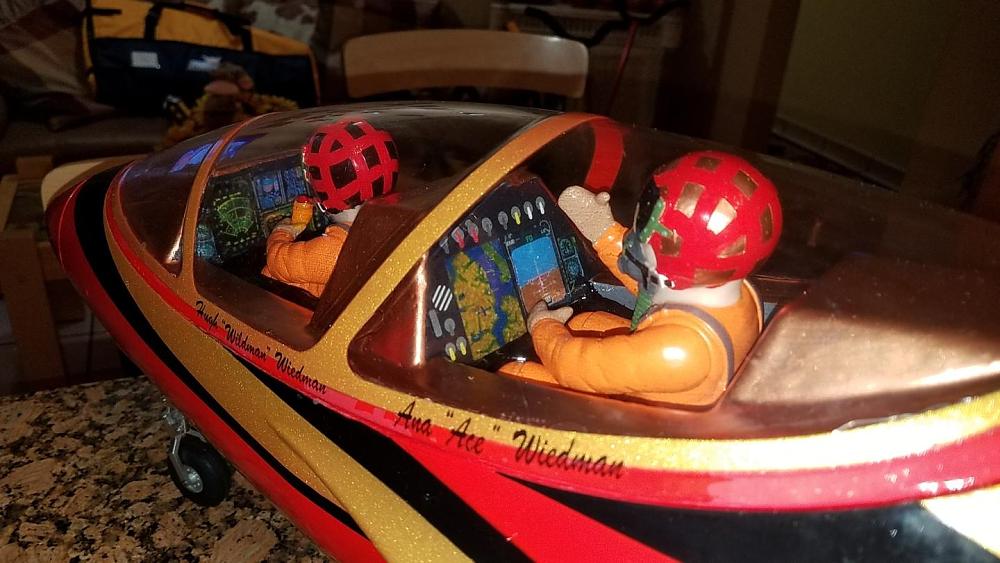

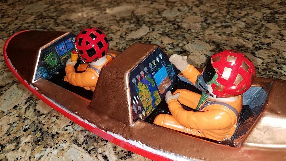

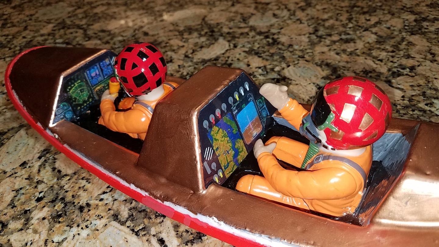

                                          Built out the cockpit with 2 "Clint Walker" size pilots and applied 4 coats of clear gloss exterior Spar Urethane for durability. She's a sweet ride!
