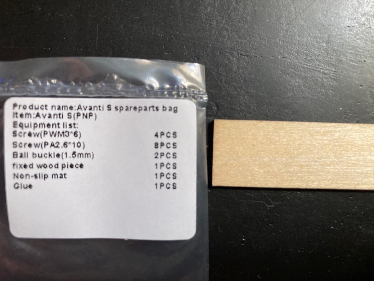

                        Thanks for the reply. Also, there is a small piece of plywood included in the small parts bag but there is no mention of it in the instructions. You can see in the attached photo that it is listed on the small parts bag label so it was meant to be there. What is this piece of plywood for?

                          That piece glues in the open slot at the rear of the battery tray. Provides rear support to push battery all the way to the rear.

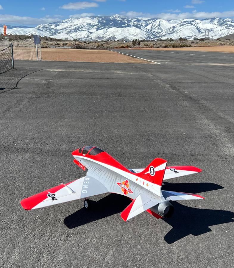

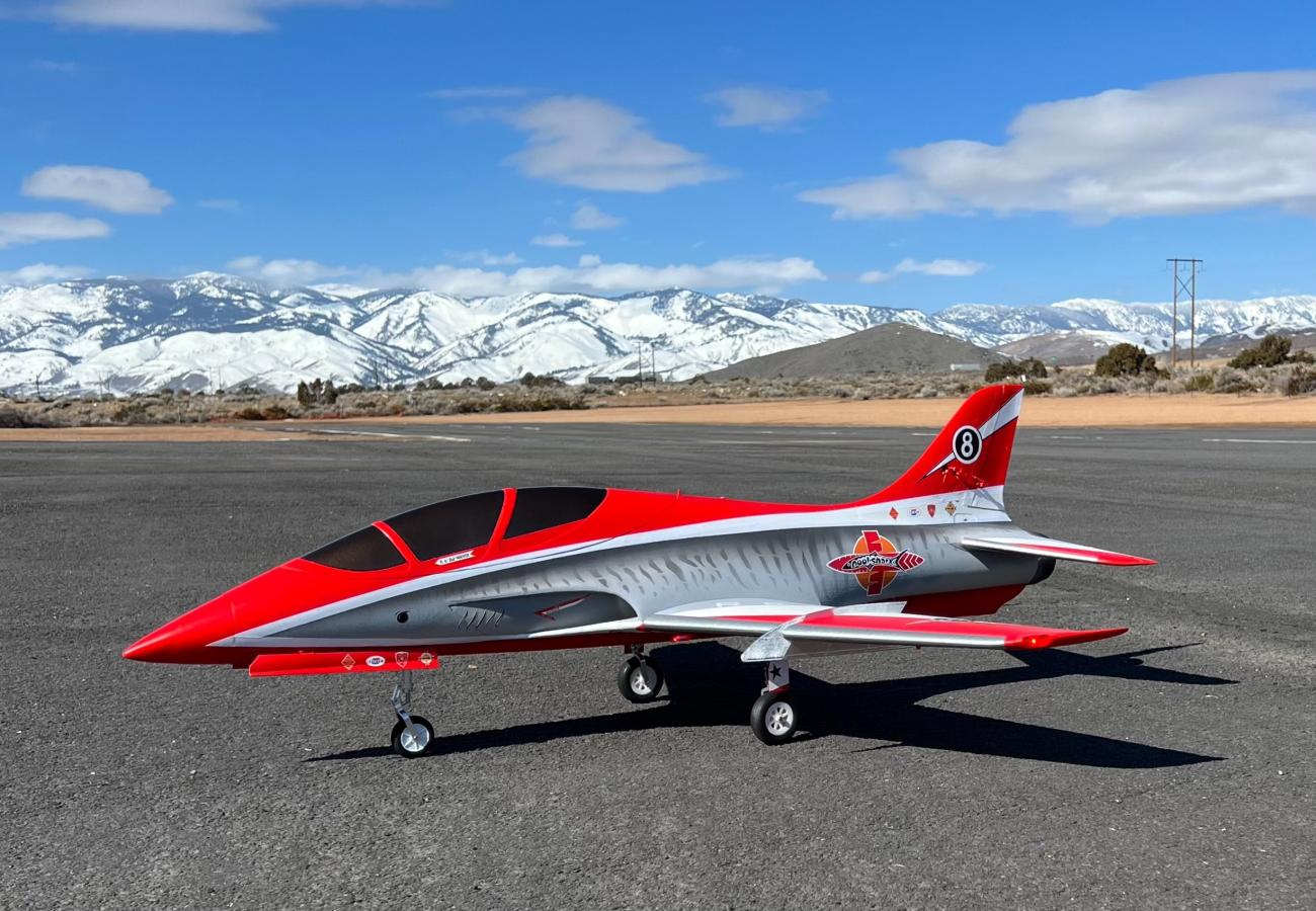

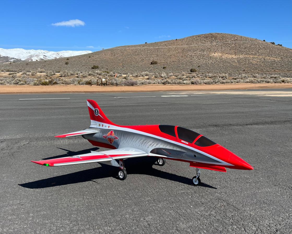

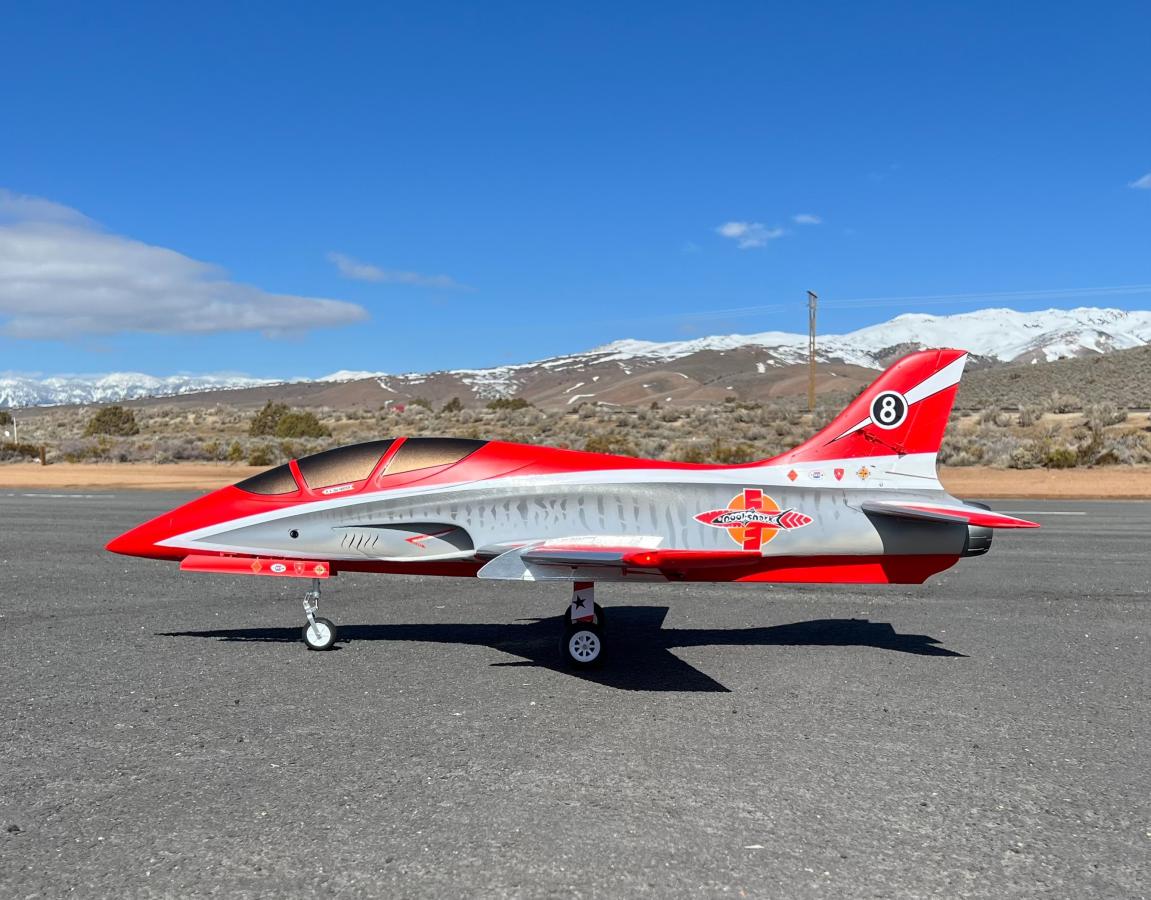

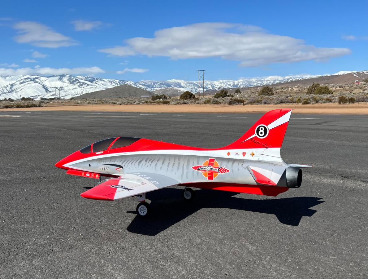

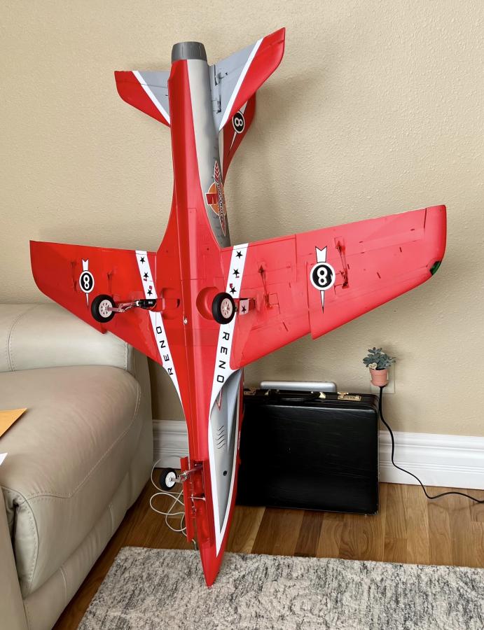

                            I painted my new Avanti in a custom scheme and set her up for 125mm CG using my 6300 and 5300 HV packs. She flies even better than my first Avanti because she is red ;) And also because I sealed the flight control bevels and cleaned her up with little mods here and there and she has the newer stock power setup. Love, love, love these Avantis! Even on stock inrunner power. I have a JF80 ready to install if I feel the need later but so far I do not. My blog page on the RCG site has all the ways I set up the paint scheme and mods, documented.

                              Looks badass, great job my friend. I'm gonna check out your mods
