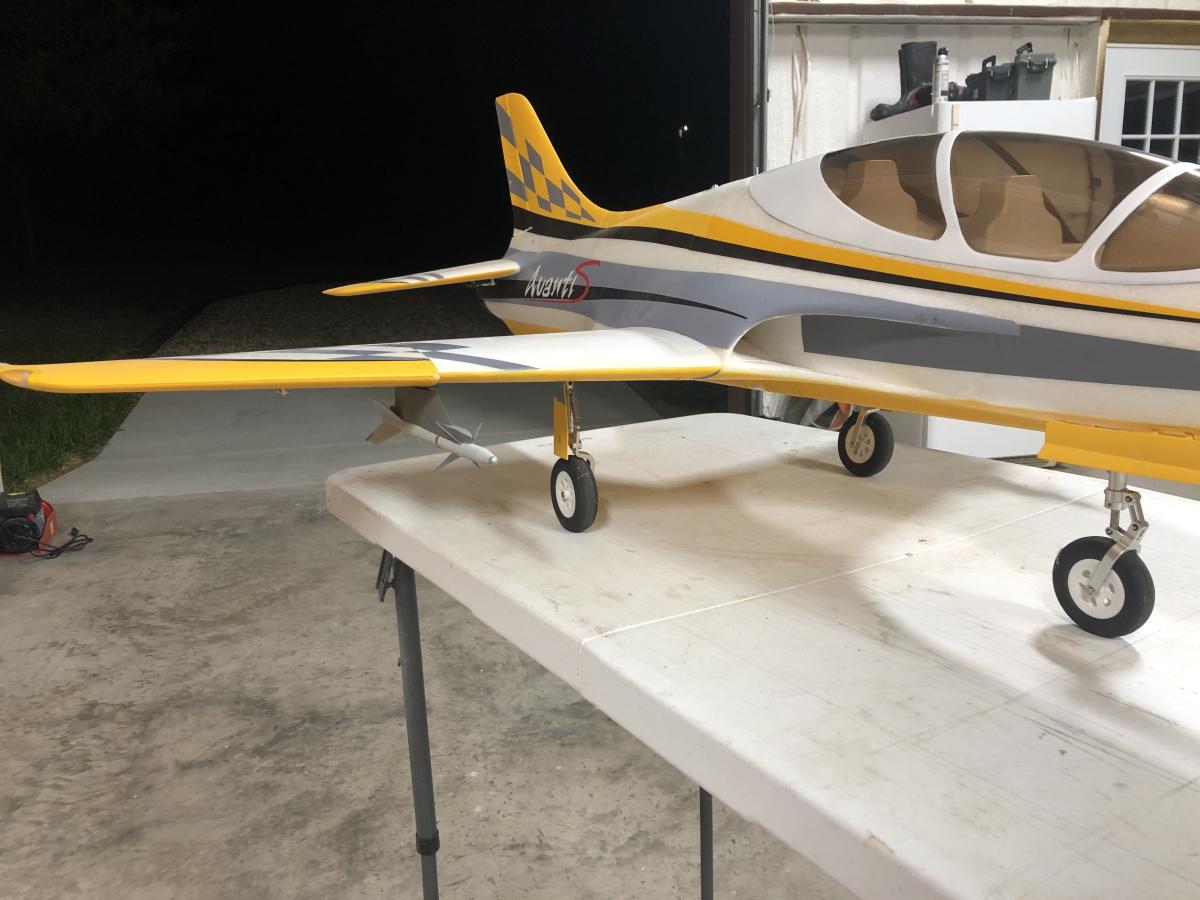

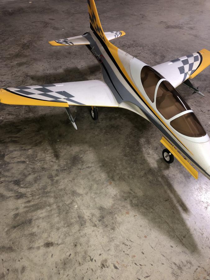

    Well, this is just proof that you CAN teach an old dog new tricks. Installed an A3L in the Avanti, on the starboard side under the forward end of the hatch, set her up to use the knob on the radio for gain, like all the other planes I have (Did a count and the Avanti is the only flying airplane that didn't have a gyro! Go figure) Flew her today and WOW, smooth as butter! The gyro just makes an airplane so much nicer to fly. The Avanti was never a difficult airplane to fly, just getting her back on the ground was the challenge for me. She sat for over a year as my skills definitely improved, thanks to my F.I RV 8! Best airplane ever! Now she's fun to fly again. Thanks guys!!

        Sidewinders!

          Originally posted by Ps2727
          Sidewinders!
          Cool, now you can shoot down those pesky Havoks and Vipers.

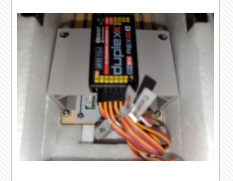

                            ​First of all, many greetings to you all. As you can see, I am new to the forum.
                            Can I have a little quick help?
                            A few days ago I bought my first EDF, of course, Avanti! :-)
                            I started reading the topic about him and I can see that it will be interesting.
                            I saw an interesting thing somewhere, but I can't find it now,
                            it is the RX/Gyiro tray for the Avanti EDF 80mm. It looks like a great solution for the avanti.
                            Question and request for help?
                            Does anyone have a link to thingverse where I can download that file so I can print it on my friend's 3D printer?
                            Thank you all in advance for help and I wish you all many happy landings!
                            Pero1969
                            Croatia.​
                            • Stirstik
                              • May 2022
                              • 3
                              #3374
                              Maybe something like this. https://www.thingiverse.com/thing:5147716
