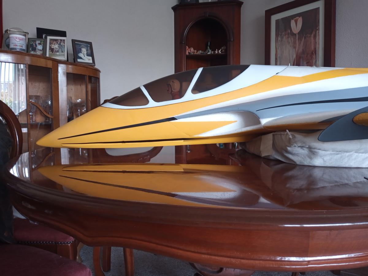

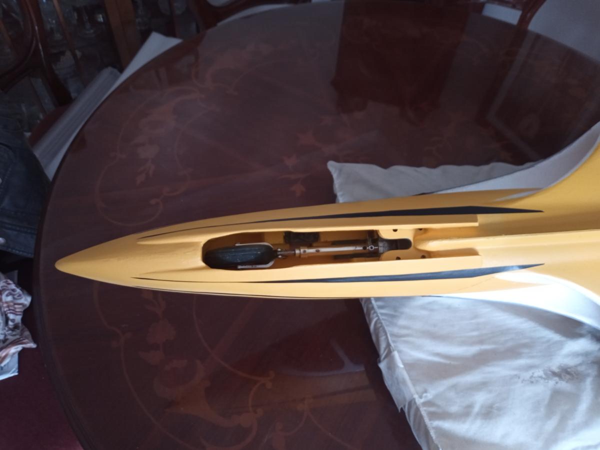

      If you have thin guage piano wire to match the existing spring then you can stick a drill bit in a vice( a drill bit that goes in the loop of one of the remaining wires) bend it round the drill bit then cut off both ends to match the length of the others. It worked for me. Use a longish length of wire to make it easier to bend around the pin. Having said that I eventually gave up on my gear doors and took them off as below Click image for larger version

        Having said that I eventually gave up on my gear doors and took them off Click image for larger version

        it s also a solution, no more springs to loose ...

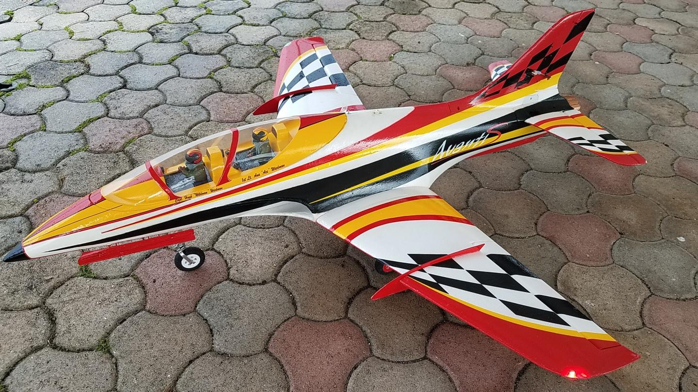

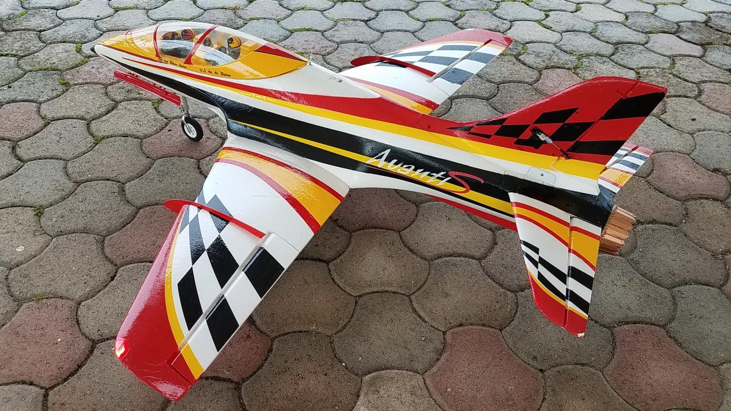

              Got my Red Avanti V 1.9 (V1 but with upgraded 12 blade 2150 Kv inrunner) out again and it's a new girl! Drop in fit and no need to change the ESC (but doesn't have thrust reverse-I like flying in a forward direction ). Been using the SMC HiV 6200 before, which weighs in at 848 gr but this time used the new SMC HiV 5900's which weigh 100 gr less at 740 gr. It's much quicker, flies lighter and I really didn't lose any flight time. It's definitely a worth while upgrade assuming your V1 is in decent shape. Had an issue with the first fan as it must not have been perfectly round and the blades almost immediately ground into the inside of the fan and seized up. I noticed the clearance tolerance on this fan is extremely tight, probably more so than on their previous fans. MRC sent me a new fan/blades, which I changed out, balanced, and it worked perfectly, although I really do hate balancing EDF's. Kinda like the new V2 paint scheme, but couldn't justify dumping the old one, even after 100 flights.

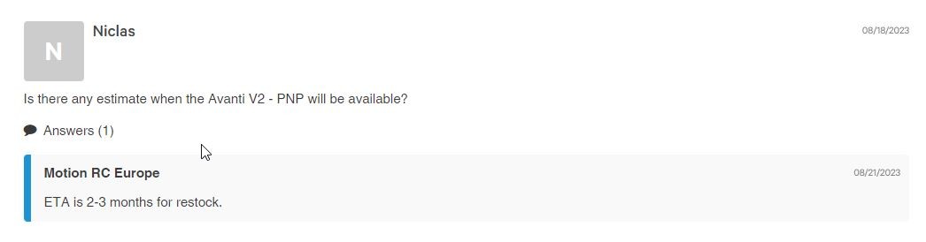

                      Just when I wanted to get into the "Avanti club", Motion RC says the estimated backorder delivery is 2-3 months... geezzz.... I was hoping to have it still this year :)
                      Interestingly, Freewing website says it's available.... well.. waiting time :)
                        • 5398
                        #3551
                        When I look at both the US and EU Motion sites all versions, new, old, ARF, PNP, all show out of stock. Where are you looking?
                          On the EU site in product questions (PNP version)
                          Click image for larger version  Name:	2023-09-01 13_13_31-Clipboard.jpg Views:	0 Size:	19.9 KB ID:	385572​However, this is the information on the Freewing website. It says clearly "in stock" (but the price......)
