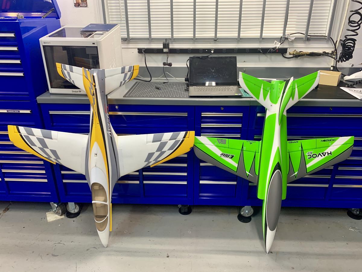

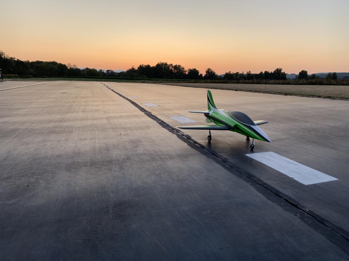

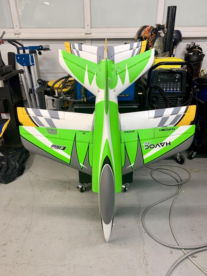

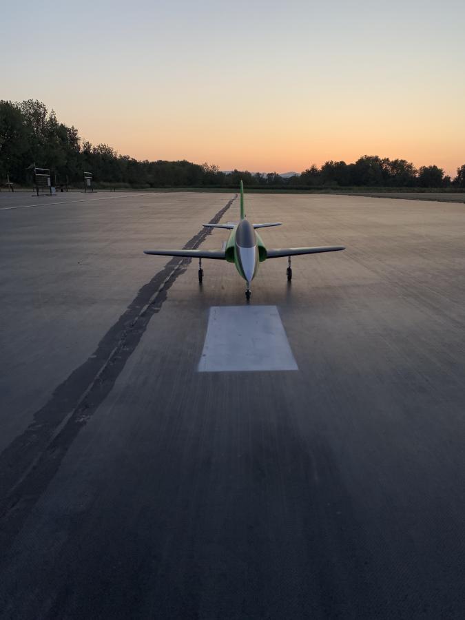

I did a little write up on the comparison between the Havoc and the Avanti on RC groups this morning. I will re-post it here, might be interesting to some of you guys that hang out here.
My BNF Basic Havoc arrived Friday and first flight was Aug 4 2019. I have been flying the FW Avanti since it first was released. I had so many flights on (over 200) her I picked up a second one since she was starting to get a little rough around the edges. The new Avanti has probably 10 flights now. I have tried many batteries but keep going back to my tried and proven 6S5000 Turnigy HeavyDuty packs. I flew both planes back to back with these batteries.
Initial thoughts, the Havoc is a little bit smaller and lighter. RTF my havoc weighs in at 5Lbs 14 ozs. RTF my Avanti weighs in at 6Lbs 5 ozs. The Avanti has quite a bit more wing area than the Havoc. Interestingly the Havoc looks to have more surface area of its horizontal stabilizer. The landing gear legs on the Havoc look a bit nicer than the Avanti. The tires on the Havoc are smaller than the Avanti so grass operations should be a tiny bit easier with the Avanti and its larger wheels. I fly off 550' Geotex so it doesnt matter to me, The Havoc does not have lights, gear doors or a clear canopy so there was some cost savings there but you can also say weight savings. All the control rods on the Havoc come pre-connected to the control surfaces unlike the FW stuff. The Avanti has split flaps, the Havoc has flaps with full range of moment that can move up and down like an aileron if you want. Split flaps have the advantage of a cleaner wing and more accurate alignment when retracted which means more accurate roll trim especially at higher speeds. Full travel flaps on the Havoc means you can add functions like full span ailerons (high roll rate) or crow (Speed brakes). The down side is possibly less accurate roll trim. At the moment it looks like you can pick up an Avanti for $339 free shipping and a Havoc for $369 free shipping.
Notes:
The Havoc Length: 49.25" and Wingspan: 41.0"
The Avanti Length: 51.20" and Wingspan: 48.6"
Flying back to back there did not appear to be a huge speed difference between the two birds. I would imagine the Havoc may be a bit faster than the Avanti with its shorter wing but it wasnt obviously much faster. Vertical performance was roughly the same with both aircraft. I need to get some more time on the Havoc to really get a feel for her.
The havoc slowed down nicely and did not show any tip stall tenancies or weird stuff on landing. The Avanti can still float in slower than the Havoc.
Some of the things I did not like about the Havoc:
While connecting the servos and setting up the radio I noticed quite a bit of play in the control surfaces especially the ailerons and flaps. After a bit of investigation I noticed that Horizon mounts their servos in a little injection molded servo box that is glued into the foam. The servo box has a cover with two screws that allows for servo access. The servo is not screwed into place it is just held by pins inside this box. On both aileron and flap servos I could shuck the servos around probably 1/32" to 1/16" in its mount. This forced me to lift up all the servos and put a dab of hot glue in there to keep them from moving around. Do not use CA this will wick into the servos and mess them up. I secured the elevators as well although they seemed ok. I also noted the Havoc servos might ever so slightly not center as reliably as the servos on the Avanti.
I need to get some more time on the Havoc before I can really say much more about the flying characteristic of her. The wing to stabilizer incidence appears to be good, there was not any unusual elevator trim required. I will report back after a week of flying the Havoc. Overall the fit and finish on the Avanti could be argued that it is a little nicer. Also I would say the servos FW is using on the Avanti seem nicer and center better than the servos Horizon uses on the Havoc.

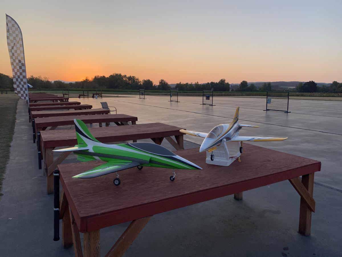

I now have 6 flight on the Havoc. Last night I made 3 flights on the Havoc and 3 on the Avanti back to back. Here are my thoughts.Originally posted by Turbo442 View Post
Keep in mind I am I have the NON AS3X version of the Havoc.
I generally trim the aircraft for neutral flight at 50%-75% power settings.
With the Havoc, during high speed passes from a dive, I get a slight climbing input that appears to increase with airspeed. I am assuming the airfoil is generating a bit more lift at these higher speeds causing a pitch up moment. On some passes I also can detect a slight change in roll trim with airspeed which is annoying. I am assuming AS3X might mask both of these traits. The Avanti is completely neutral pitch and roll in these high speed ranges. Its easy to forget how nice she fly's until you try something else.
The Avanti is quieter than the Havoc. The motor on the Havoc has a higher pitch whine that is not present on the Avanti. Not huge but noticeable. The Havoc air frame its self is a little nosier at higher air speeds as well.
I did catch the Havoc dropping a wing on a slow landing. It recovered but it certainly lands faster than the Avanti. I would not recommend floating the Havoc in like you can with the Avanti.

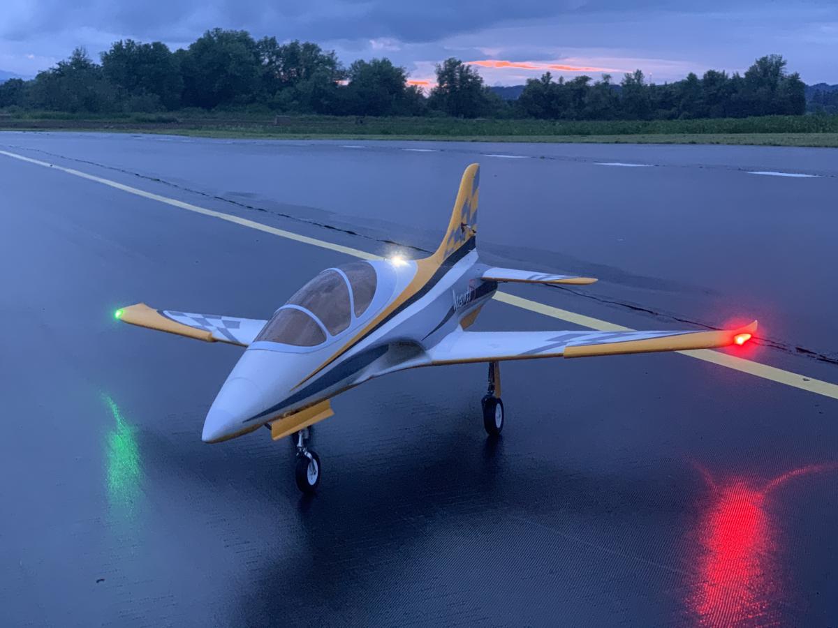

I put 6 batteries in after the sun set last night. It was still light out, but as it got darker I had to concentrate more with the Havoc. Eventually I switched over to the Avanti, the lights are a real bonus and very functional at dusk. I would have kept flying the Havoc if it had lights.
I need to take the Havoc out when some one else is flying an Avanti so we can do a direct speed and vertical performance comparison. Its very hard for me to tell at this point, they both sound quite a bit different in the air.
I am trying to be as impartial as possible here.
If I crashed the Havoc tomorrow I probably wouldn't run out and replace it. If I crashed the Avanti I certainly would replace it unless something better came along. At this point I have not found it.
