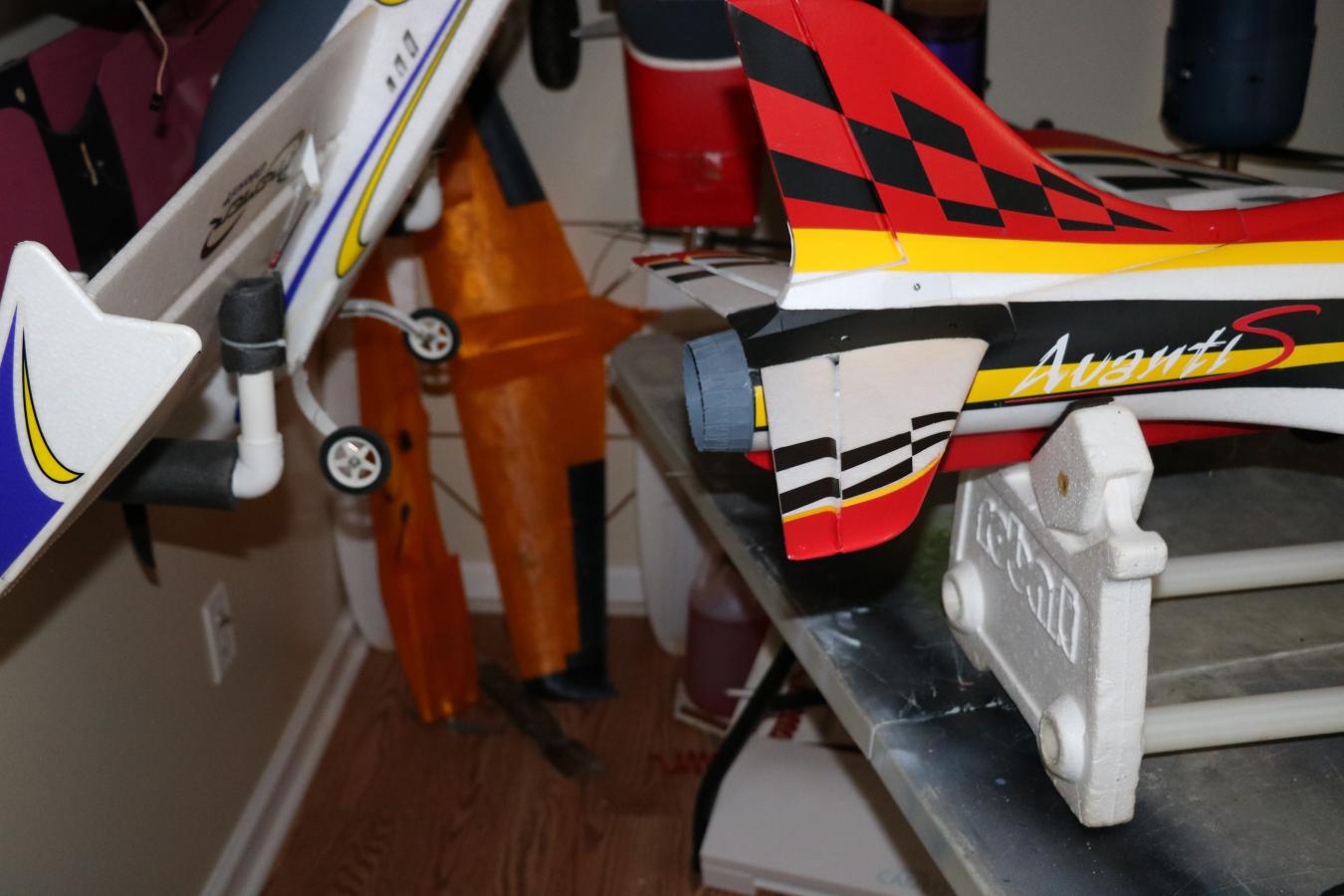

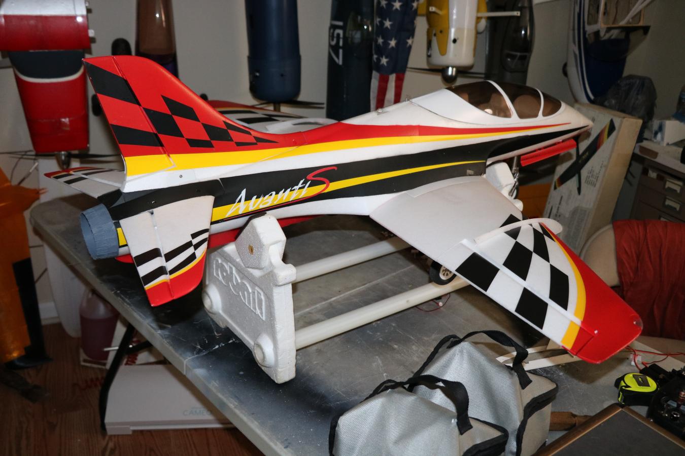

            3D printed an exhaust nozzle for my Avanti. I like it, it makes it fly faster Lol
            • Mach9
              • Jun 2017
              • 123
              #2666
              I-fly-rc-aircraft What 3D printer do you use?
