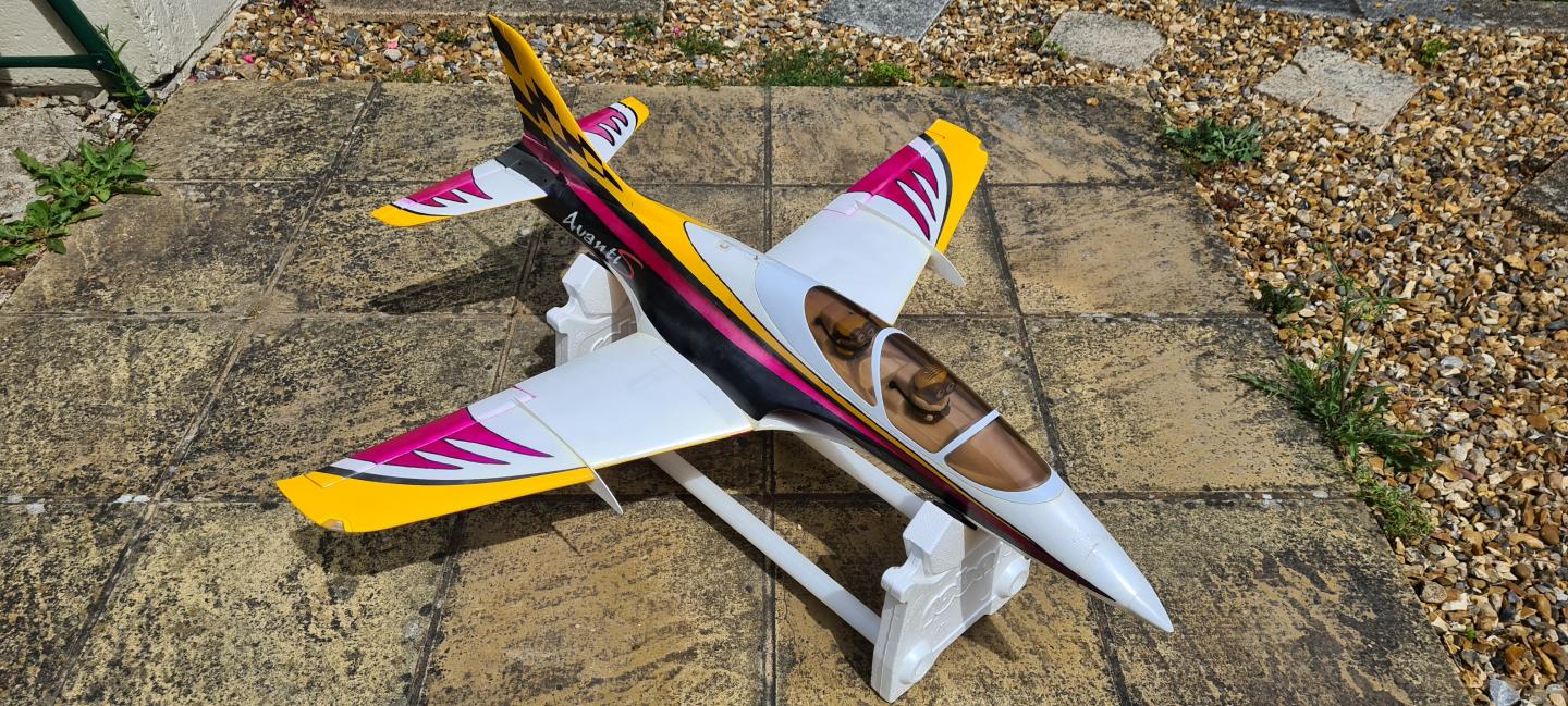

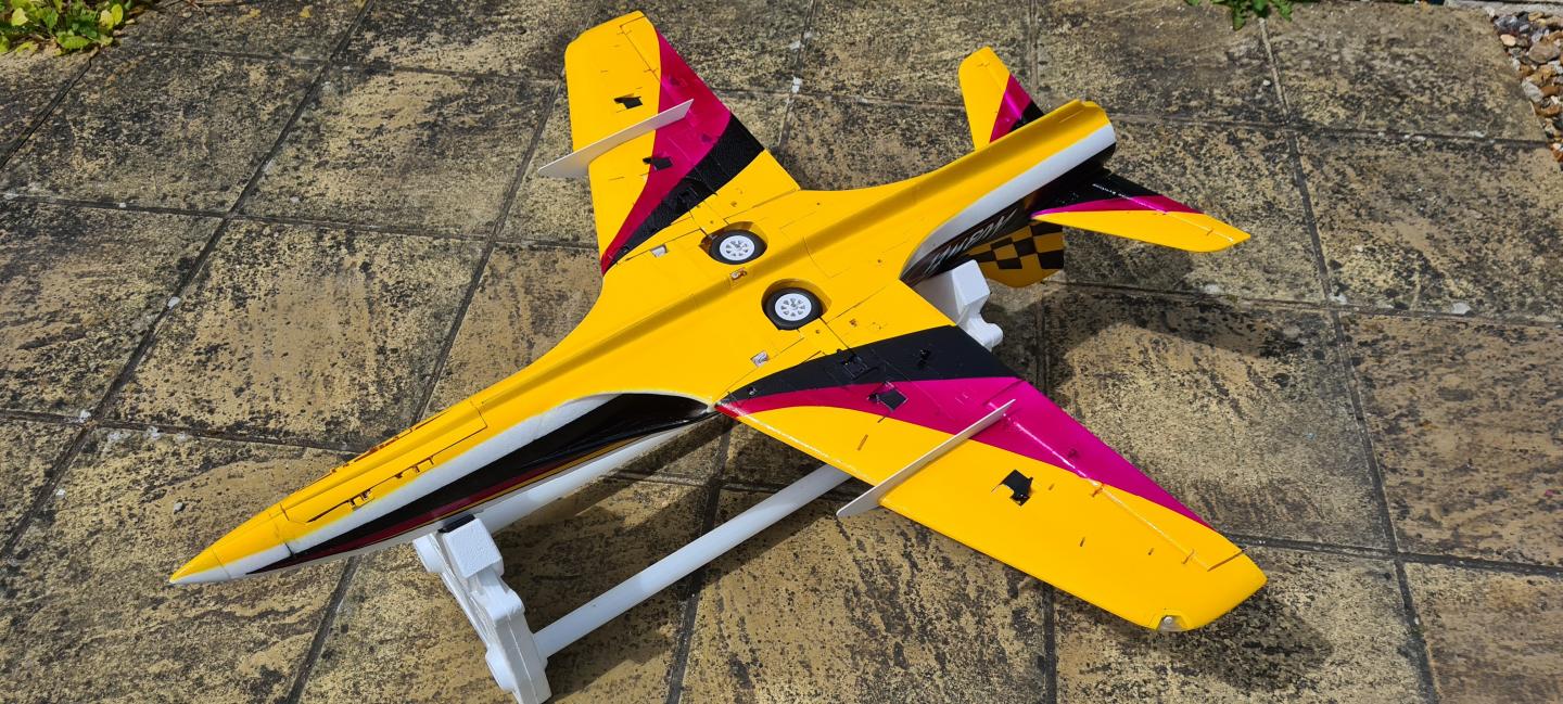

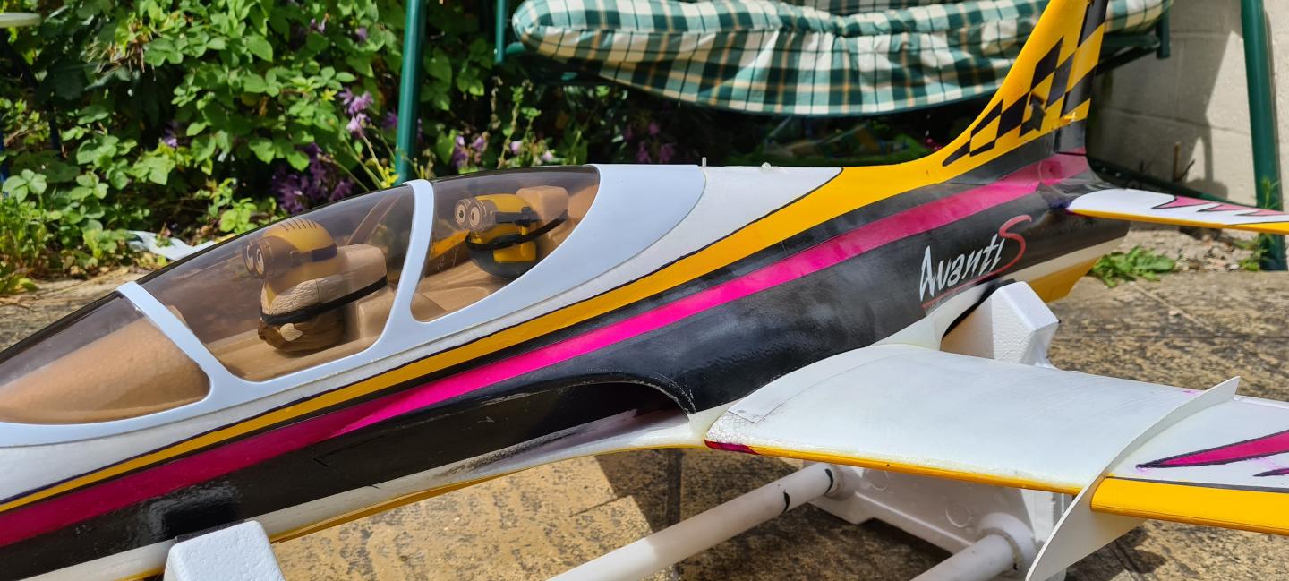

    Freshened up the paint job with subtle changes for better visibility and installed the new in runner

      Nice work, love the pilots!
        Thank you. Had those in there a couple of years now. They are old McDonald's toys borrowed from my boys lol

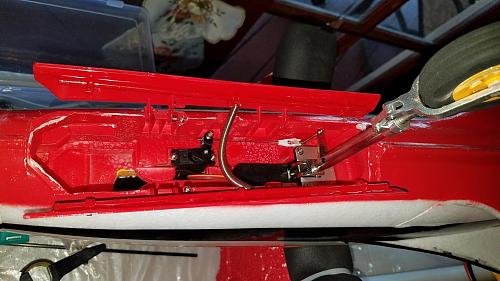

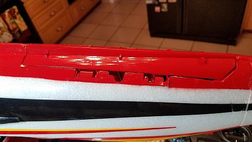

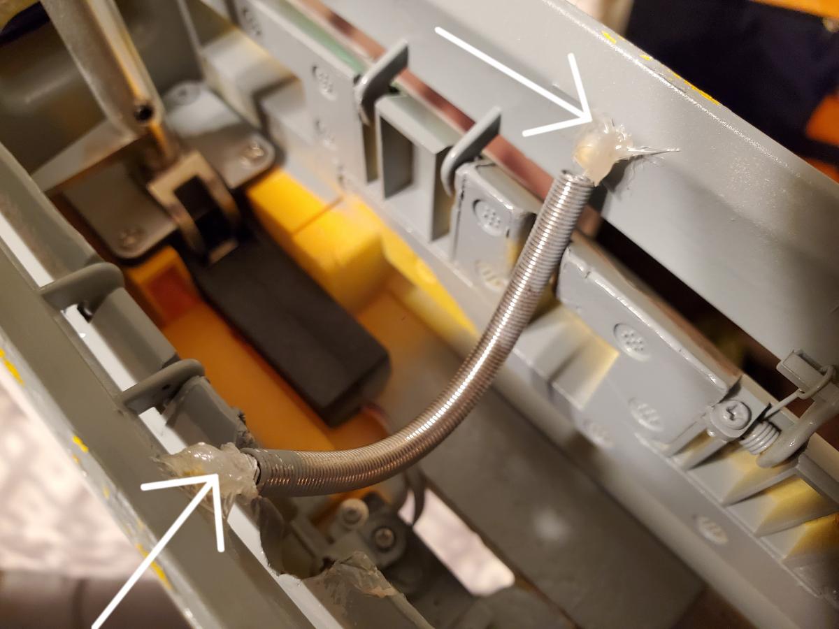

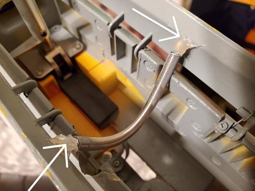

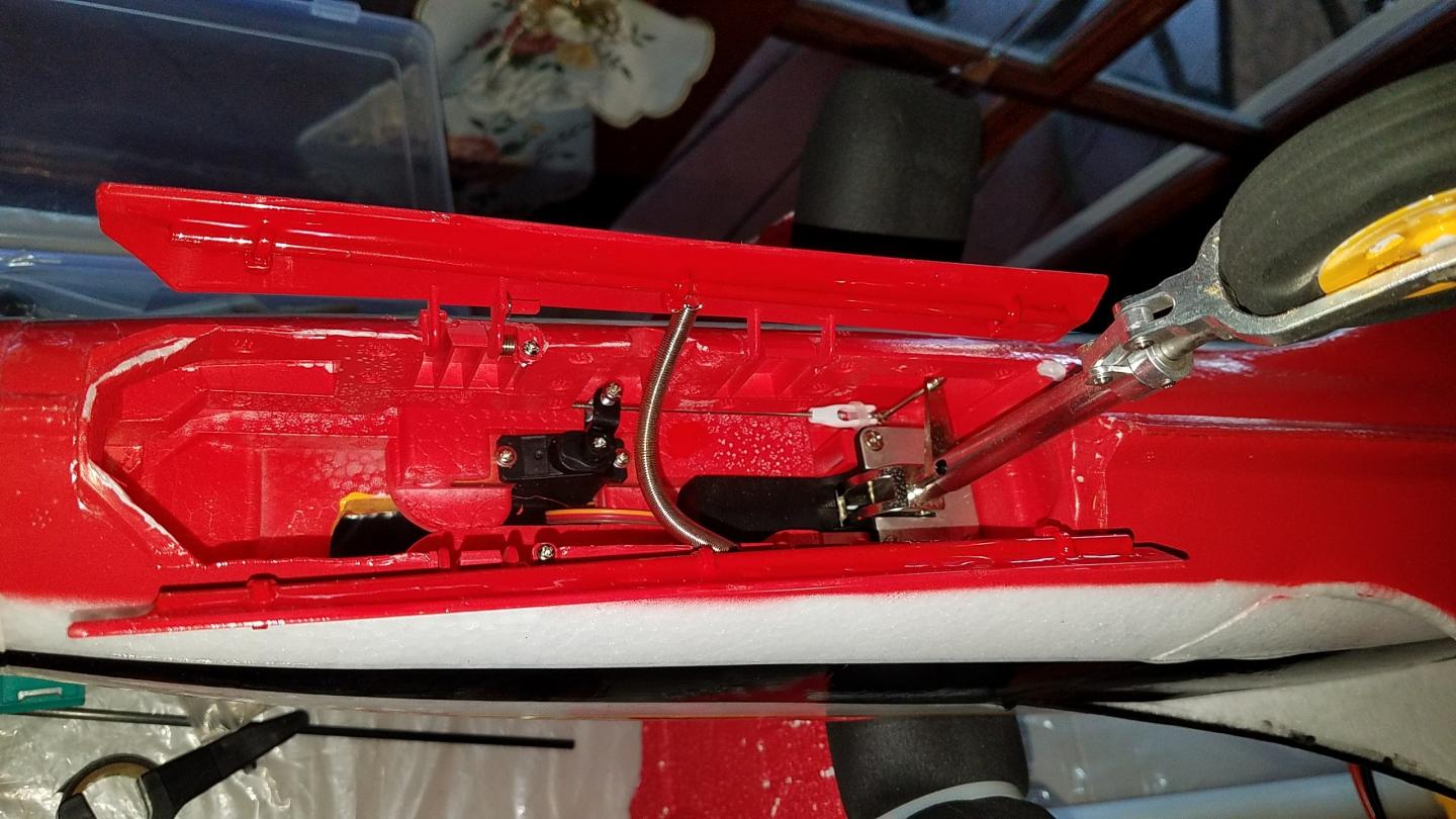

            Out of the Avanti my friends and I have owned, over time the nose door spring may stretch a tad and develop slack at each side. This causes the spring to rotate 180 degrees around and hang lower than the doors instead of sitting the opposite way tucked inside the fuselage. The doors and nose gear can therefore get stuck, not close fully, etc.
            People have come up with various ways to remedy the issue such as a rubber band around the spring tethered to something, and more ideas. I found it easiest to simply add glue to the attachment point of where the spring meets the door on each side. This traps the spring ends so they can no longer rotate to an improper position. Hot glue has worked perfect for me, even during summer months, and it takes minimal time to do this modification. I've done this modification to my friends Avanti's as well and all have worked well. Before gluing, just make sure the spring sits in its natural position allowing for full and proper closure of the doors (when the jet is inverted on the stand, I retract and extend the gear a few times to ensure the spring is where I want it). The attached picture shows what's I mean and the arrows point to it.
            Click image for larger version  Name:	20200104_164800.jpg Views:	0 Size:	90.9 KB ID:	258958

                Super sexy dude! She is gorgeous!

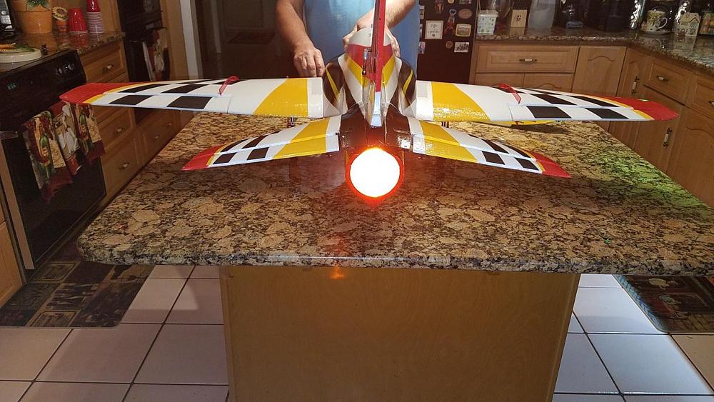

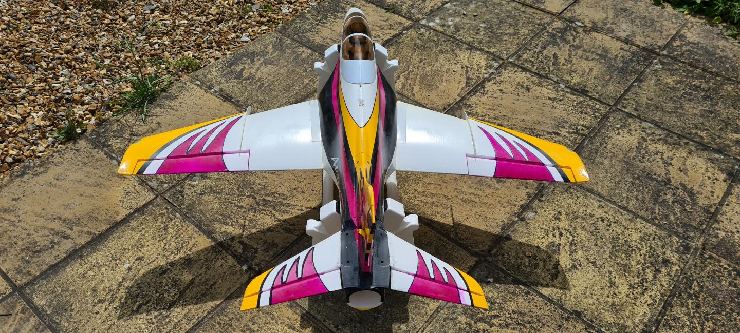

                      I liked the Freewing Avanti so much that I bought its big brother (Sebart Avanti XS). It is powered by a 17-blade 120mm EDF, on 12S. I just finished it last weekend, hope to fly it soon.

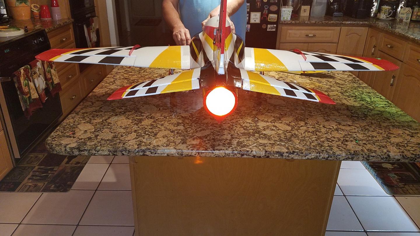

                        Instead of semi scale exhaust nozzles, why don't you add an after burner.
