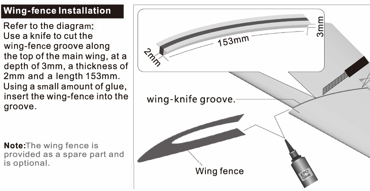

            I'm looking for some clarity on the wing fences. Do they or don't they improve flight characteristics? They are fugly so if they don't I'd just as soon leave them off. If I install them there is a wide variety of opinion on to cut or not to cut. Some say the new models have a wing fence groove which they do, and so there's no need to cut, but the manual shows this and says cut. A depth of 3mm and a thickness of 2mm. I will look on Amazon for laparoscopic hobby knives.
            So to recap, the wing fences are fugly. Do they provide a benefit that outweighs the fugliness? If so, to cut or not to cut with an aircraft that has wing fence grooves?
            Disclaimer: I don't think they would be fugly if they were made out of a nice material instead of bleached recycled toilet paper.

              A wing fence prevents the air from flowing sideways and keeps it flowing across a wing (in stall conditions). The location of the wing fence on the Avanti will keep the air flow going across the outside of the wing (and directly over the ailerons) in a stall condition helping maintain aileron control in a stall. Does it help in this model? I believe it does as it is almost impossible to stall the Avanti, in my experience, but when it does (flying at a snails pace), I noticed it still maintains aileron authority. Try flying extremely slow in a high alpha position with this Avanti, the first time I did, I was amazed at how slow it could go while still allowing you to keep the wings level with the ailerons all the while the nose is up at a 35 degree angle. I think without them, it would be almost impossible to keep the wing tips level, but that's just my thoughts. If you just fly around normally, then the wing fences won't do anything for you. And if you decide to install them, I don't seem to remember having to cut any grooves into the wings, they were already there on the red Avanti I got when the red one first came out.

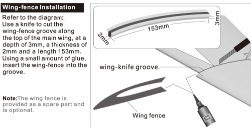

                It appears to me that you just cut through the decals on the top on the top of the wing and cut around the wires running to the lights on the wingtips on the bottom. Then you are free to glue them on. Here's an excerpt from the manual which appears to be wrong.

                  [QUOTE=Chilly Bear;n270232]I'm looking for some clarity on the wing fences. Do they or don't they improve flight characteristics? They are fugly ... [\QUOTE]
                  I have flown both with and without them. To me they seemed to improve flight noticeably. The main difference is that it can really slow down to a crawl on landing and stay perfectly stable. They also improve knife-edge a little. But the main difference is slow flight. I was also ambivalent about adding them, but now I really like them, and in fact hunted down wing fences mail-order from China for my 105mm HSD Super Viper.
                  You mentioned you don't like the material - I suppose they could be sanded and painted, covered with epoxy paint, etc. I agree they are funny looking, but I got used to it. Another thing I like is that I can throw it in the truck with the gear up and the weight isn't resting on the aileron linkages (and sliding around, banging back and forth with every turn, etc.)
                  Also I noticed you cited the manual above - I have owned an early yellow one, and it did not have slots for the wing fences pre-cut, so I had to cut them as shown there. However, I got a later red one and it did have the slots pre-cut. So there are two wing types in circulation. I don't know if all new ones have the slots pre-cut. It is not easy to get them perfectly lined up without the slots - measure carefully if yours doesn't have the slots.

                    I went ahead and installed the wing fences. They are much less fugly installed. Hopefully I can maiden tomorrow.
