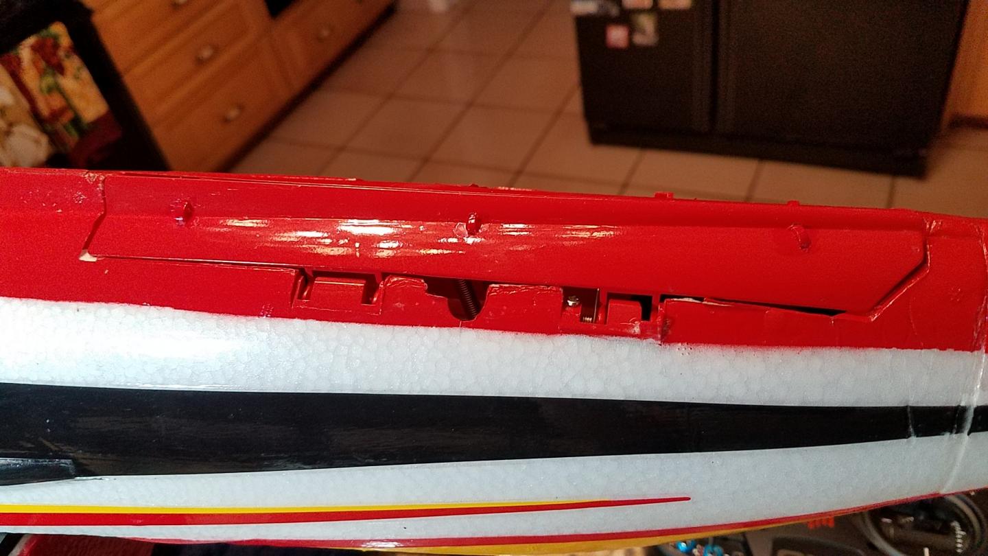

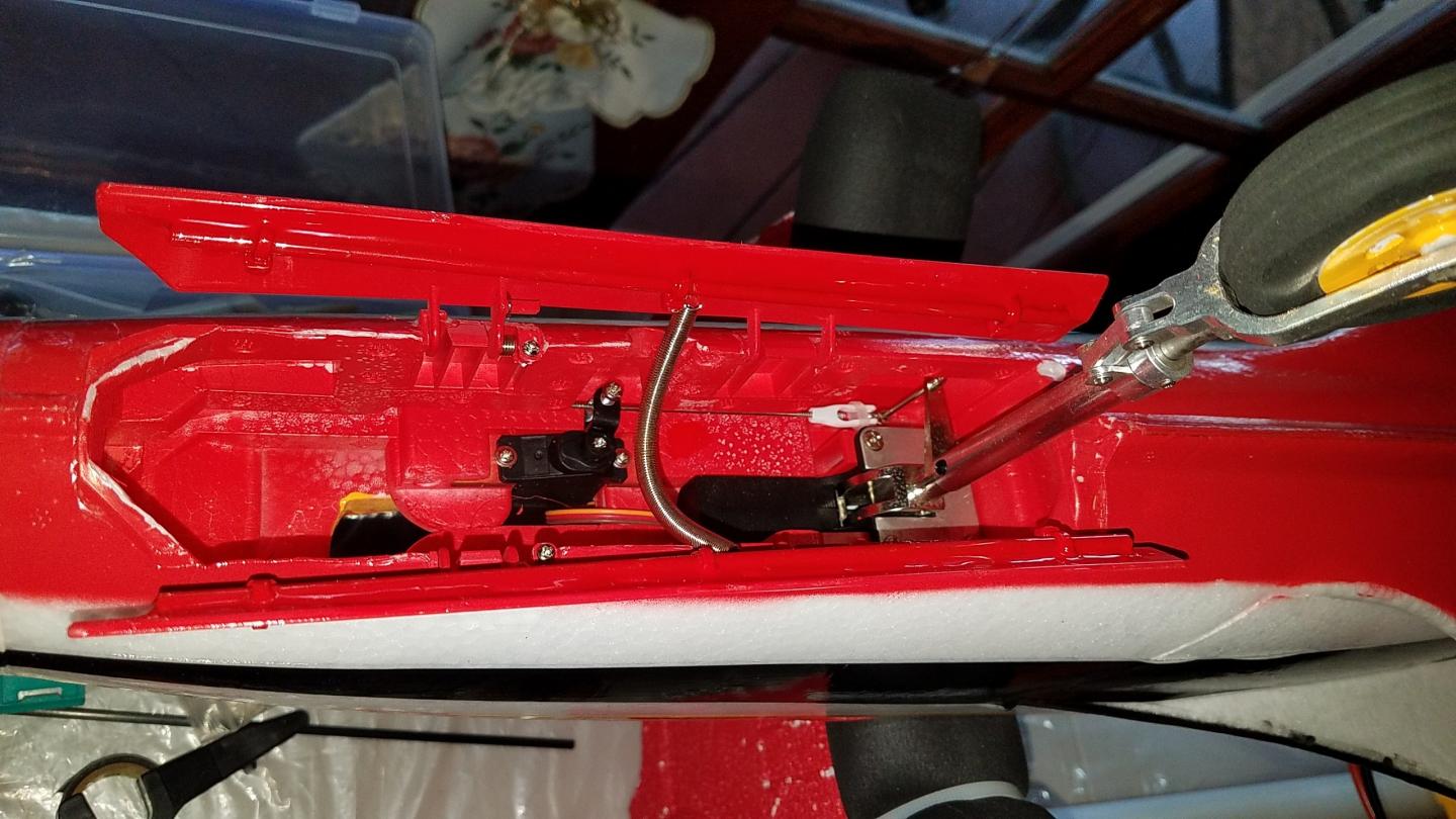

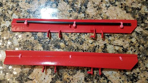

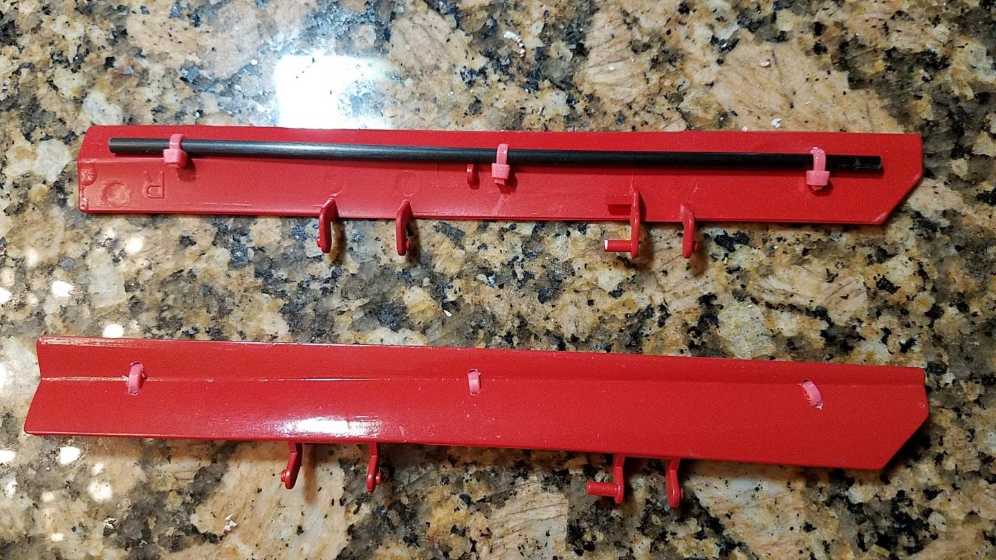

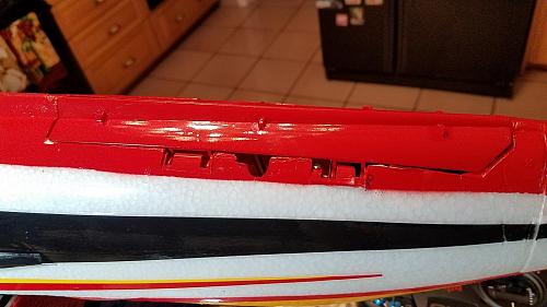

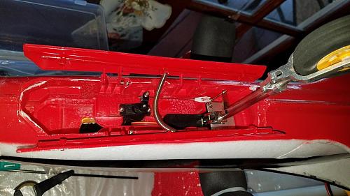

                    Tony, it sounds like you are saying that the canopy came without being glued on. That's odd, I've never bought a foam aircraft that it didn't come glued on already, including this one. I always have to remove them to upgrade the cockpit or change pilots so I'd rather they came unglued to begin with. No big deal if it came that way, just get yourself some ZAP 560 Canopy glue. Goes on white (looks like Elmers Glue) but dries clear. You will probably also have to put some masking tape on as well to hold it in place and down while drying (24 hours).
                    Regarding the front gear doors being out of shape, mine originally came in good condition but after several months, they developed a severe bow from being held closed in the middle by the spring. I installed some carbon fiber tubes on the inside to straighten them out and they have been fine since then, about a year and a half at least. So if MRC wants to send you new gear doors, I'd take 'em. At least you will have a spare if/when then eventually bow and you'll have a spare to fix. Unfortunately I didn't take a "before" photo, but they were bowed severely.
                      I think this is a characteristic of the design...many Avantis (including mine) have doors that look like Jewel's teeth. Good idea putting on braces, I might try that.

                        I was thinking of putting a stopper behind the doors when closed so they can’t be pulled out of shape.
                        Short term though I’m just going to store it either with the gear down or (more likely) with a block holding the doors slightly open.

                              I just purchased my Avanti after a couple years of hand wringing. Regarding the deforming doors -- do they deform because they are stored gear up? Would they deform if they were stored gear down? I ask this because I hang my aircraft from the ceiling, and storing gear up or gear down is all the same for me - but warped doors is no bueno.

                                I suspect it is from storing with the gear up, doors closed and held in place by the springs in the center. At least that's how I believe mine got so warped as I store them with the doors closed. If you hang it from the ceiling with the gear down, doors open, I'm fairly confident you will not end up with warped gear doors.
