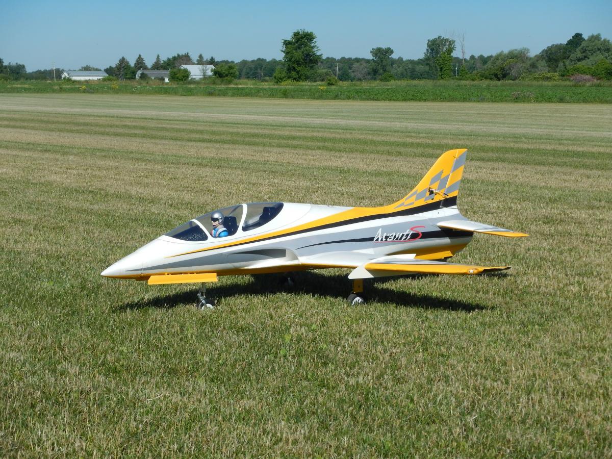

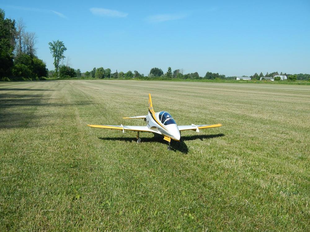

                          Hi Everyone,
                          Finally got some nice flights with my Avanti S. Love the freakin thing. It flies so smoothhhhhhhhh
                          Recently added the 3d printed nozzle which in my opinion completes this epic model.
                          Attached some photo's.

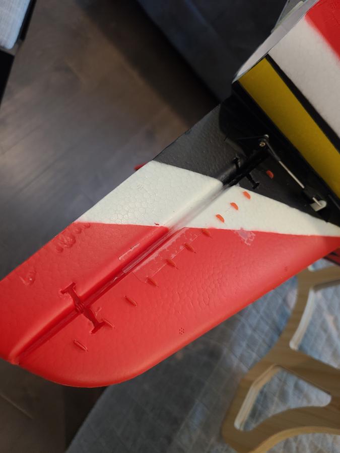

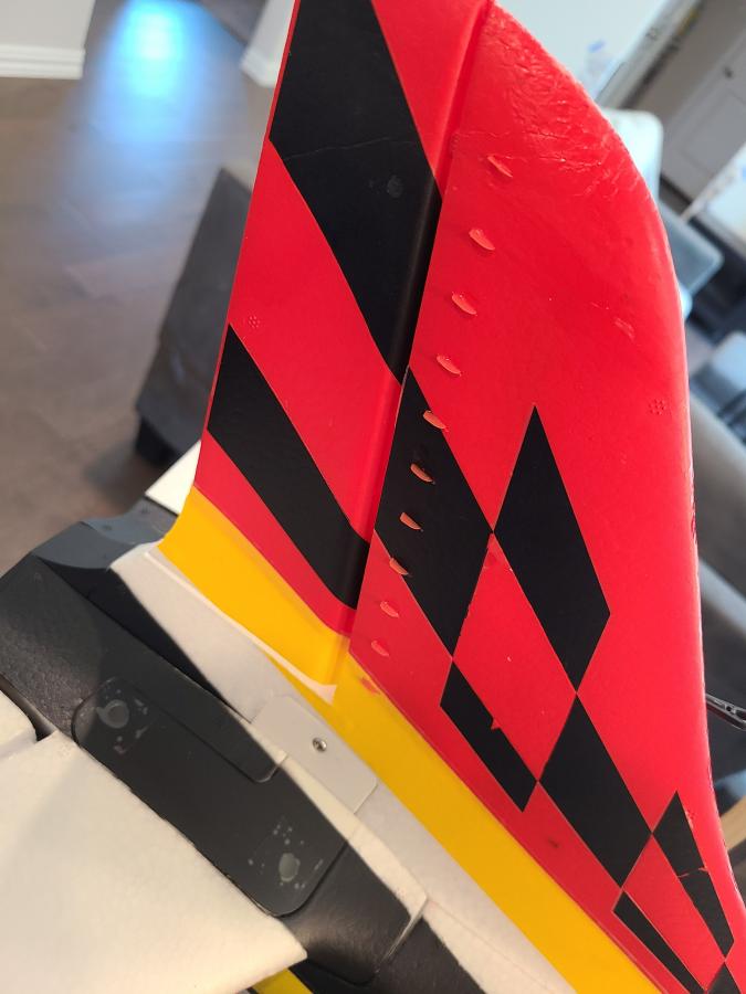

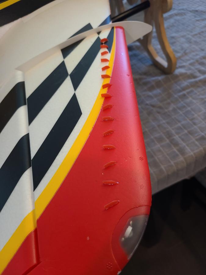

                                I made vortex generators for it.

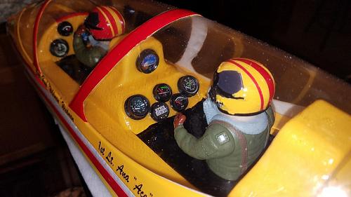

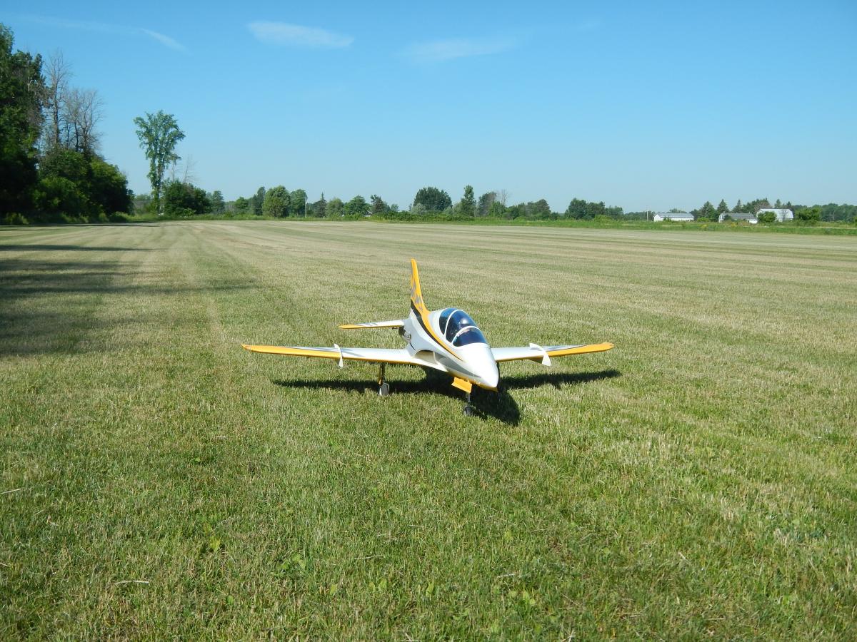

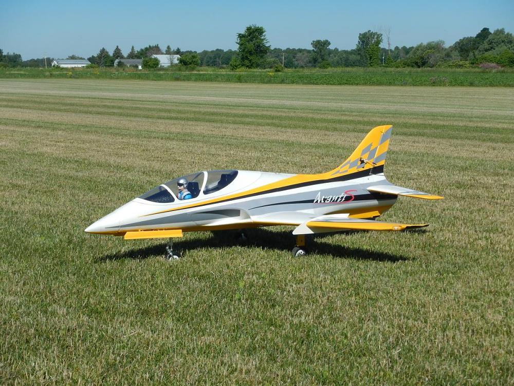

                                  Hey all, just wanted to share a couple pics of my Avanti S from this past weekend ... installed a clear canopy, pilot and blacked out the cockpit insert. I have 25 flights on this jet, the last 3 were on grass for the first time and despite sensitive steering issues, it took off and landed with ease! Absolutely in Love with this model and I have nothing but good things to say about it's appearance and flight characteristics ... Click image for larger version

                                    Probably shouldn't black out the cockpit insert. I can see the gatoring from here!
                                      Yes, I could have spent more time prepping and it is far from perfect - but the tinted canopy hides the imperfections, the clear one is being used for the on-board camera use ... I checked out some of your many posts, I can see why this detail on my Avanti would be annoying to see ... knowing you are an advanced builder takes the sting out of that comment, Ha ha!

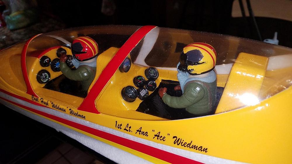

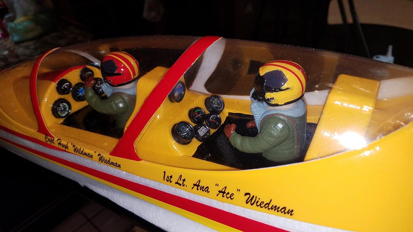

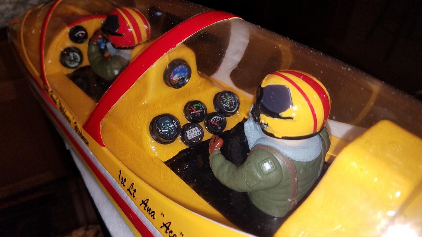

                                        I also changed my shaded canopy for the clear one after I did a little cockpit work. Just sanded and coated the foam with epoxy, then repainted it and added the pilots and some instruments from IflyTally. It's pretty basic, but better than the way it comes. It was tough to see inside with the shaded canopy, so swapped out to the clear one. It's been out in the Florida sun for some 200 flights and the smooth epoxy surface has endured, although I do not leave it sitting out in the hot sun when not flying, as I do with all my foam aircraft.

                                          Love those clear canopies guys, amazing how much it changes the look of this plane
