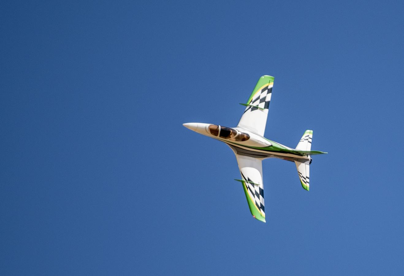

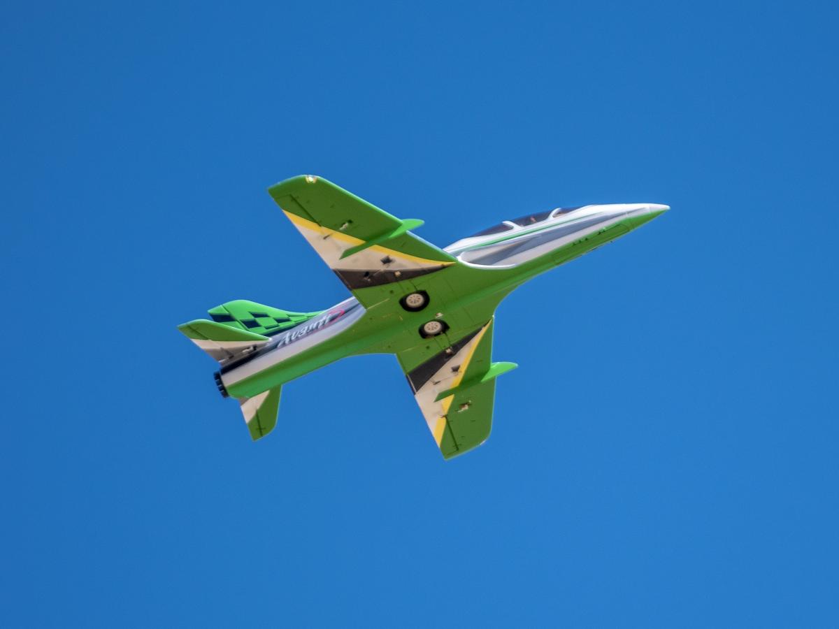

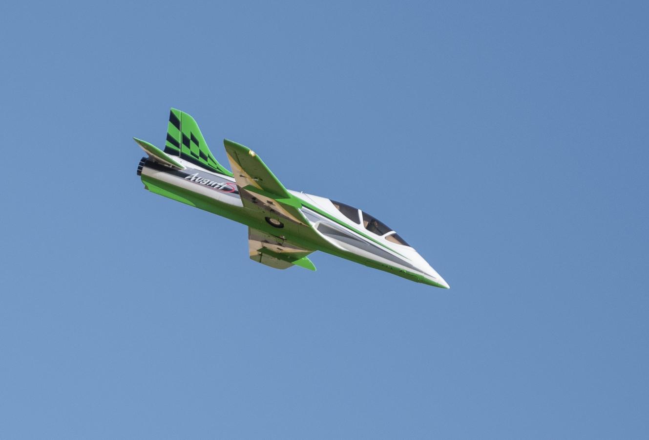

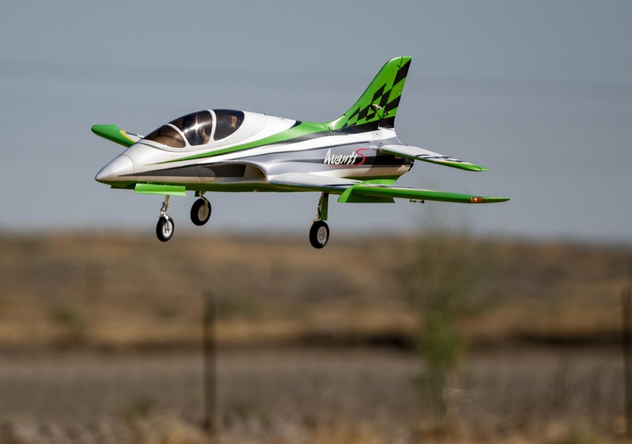

            I finally finished and maiden flew my Green Avanti. It has GPS for ground speed, Vario for altimeter, Cell voltage with low cell warning, Amp and mAh telemetry. Have the Afterburner with silver tape in the duct. This is #1 based on a yellow ARF, #2 is underway based on red ARF. I made two green because I got frustrated part way with #1 and was going to abandon the project and started #2. Then I corrected the issues with #1 so I have two. #2 won't have as many bell and whistles (at this time).

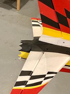

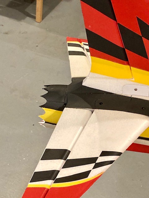

                                    Pic shows my 3DP "Chevron nozzle" (like the B787 has for noise reduction).
                                    Click image for larger version  Name:	IMG_6076.jpg Views:	0 Size:	68.1 KB ID:	320233
