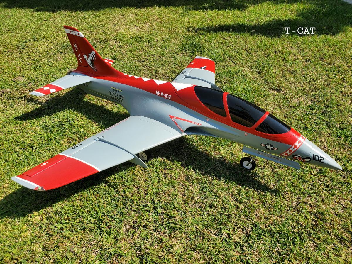

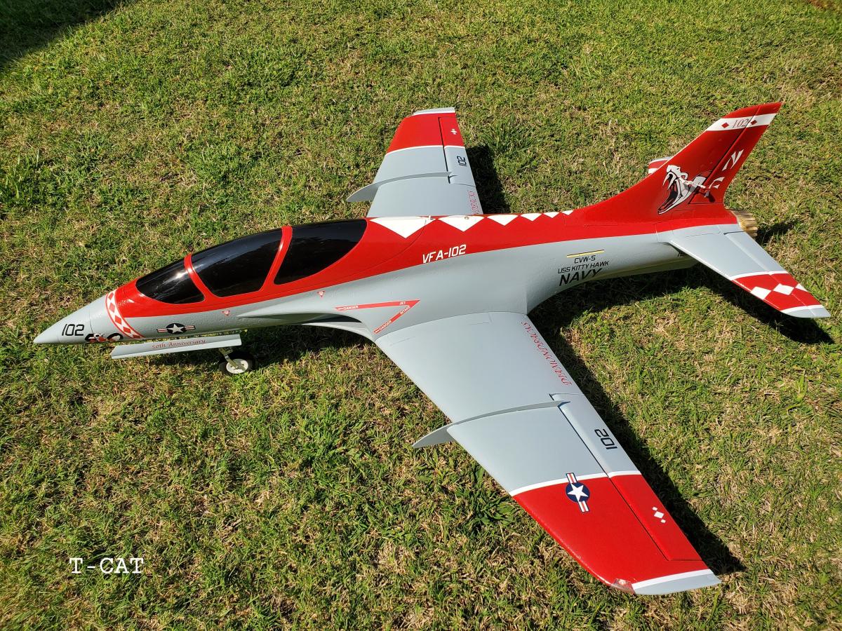

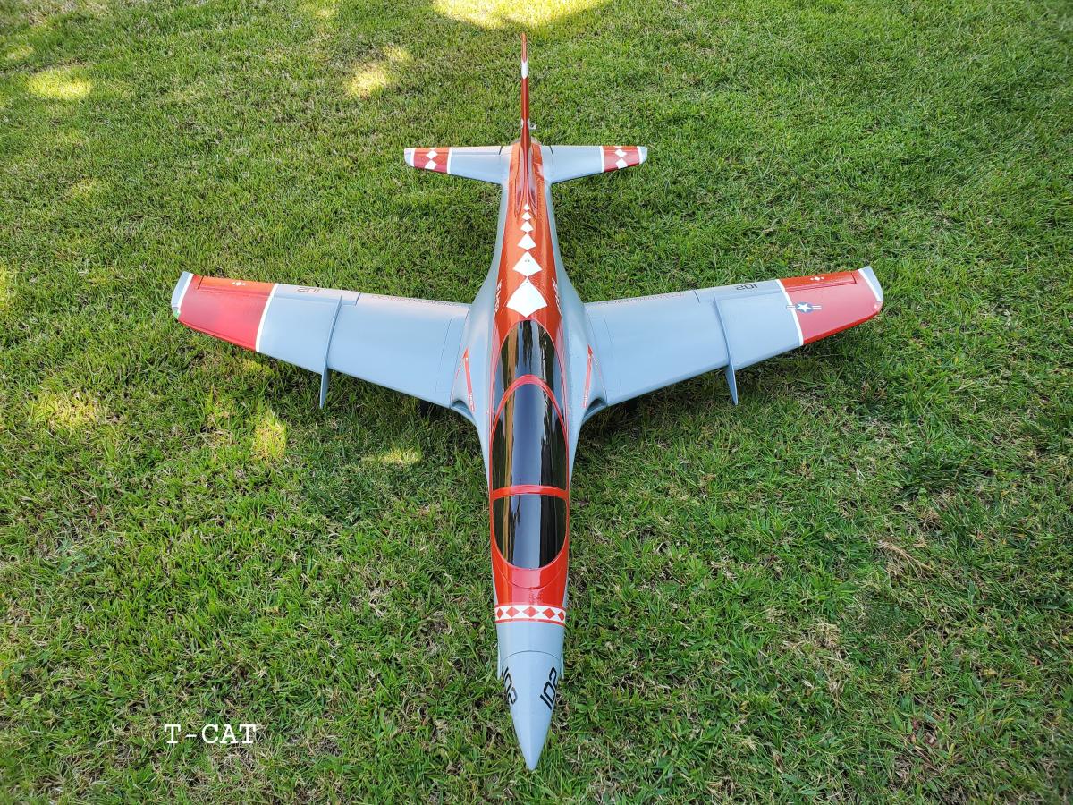

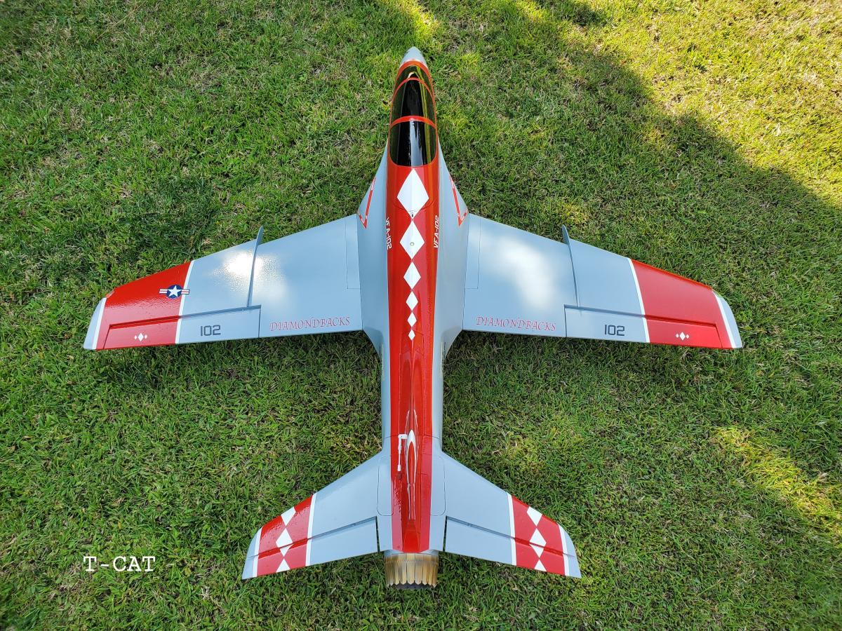

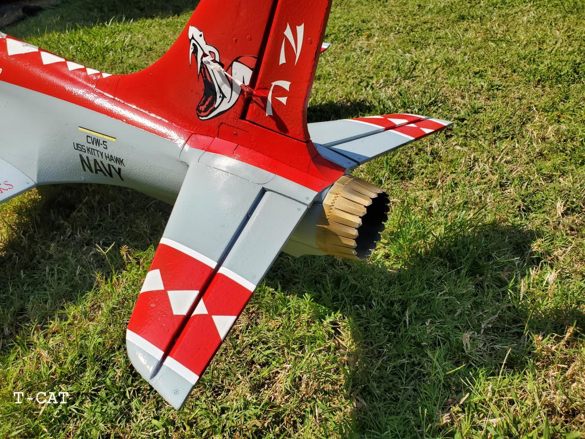

                                        It was time to give the Freewing Avanti S a makeover. My favorite sport jet look is one that rocks a scale jet livery. The Diamondbacks VFA-102 50th Anniversary is one of my favorites, so I knew that was the livery I was going to paint. If your Avanti jet is getting old, consider freshening it up with a new look.
                                        I also filled in the rudder hinge slots, concealed the forward screw holes of the vertical stabilizer and the four screw holes of the horizontal stabilizer, filled in some dents/dings, etc., and added a 3D printed tailcone that I painted (3D print was of Ken's great design as shown on this thread page above and offered on Thingiverse).
                                        This is still my favorite foam EDF jet from Freewing and it never gets old to fly.
                                        Alpha Since the Stinger 90 and Avanti S sold so well,, hopefully Freewing and Motion are considering another sport jet in the not too distant future to bring to market.

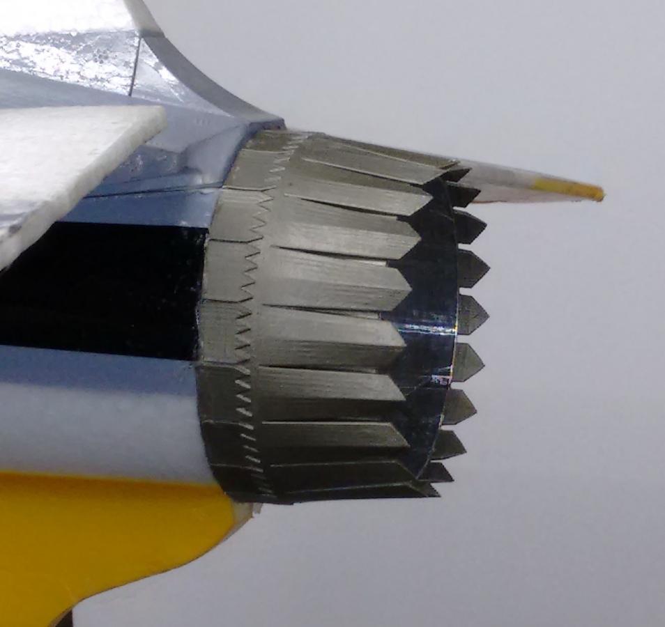

                                          Really outstanding, and I love your exhaust nozzle. Where did you get it?
                                          I agree with you completely, the Avanti S and the Stinger 90 are 2 of my favorite EDF's to fly, each with a couple hundred flights on them, and it never gets old. Actually it helps going back to them occasionally to get my confidence back after a slight mishap with any of my other EDF's. I already re-painted my Stinger 90 some 100 flights ago, but now you got me thinking of doing something with the Avanti. They both already have afterburners, but I would love to add that nozzle!
