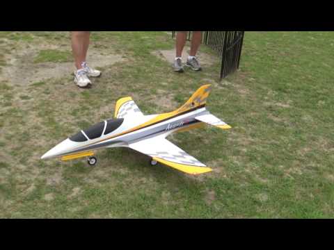

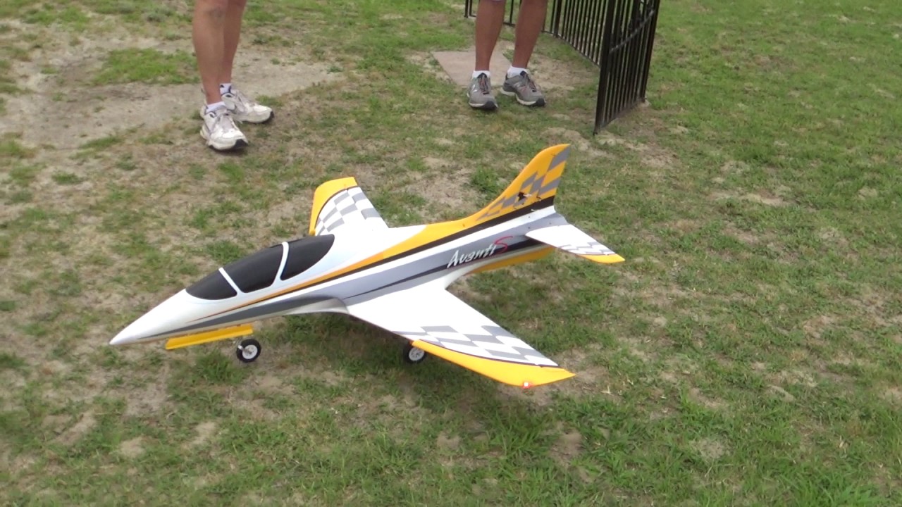

          • Here is a video of the first two flights of a club-mate's Avanti, taken yesterday. He went with 8s power right out of the box.

                My kinda guy! He flys a little too conservatively for me, but cool nonetheless :)

                  Thanks, Mike Then for taking the video! I'm the pilot. Yes. I'm usually more conservative generally, but as I get more comfortable with the plane I'll add more maneuvers. The Avanti S is so well behaved, I'll want to add them pretty quickly.

                      Looks like a great flier and definitely has the wing and gear to support the extra weight... I'm going to shoot for 150mph if I decide to build one. :)

                        It is a great flier. It handled the additional weight as if it wasn't there. I swapped this Tamjets TJ-80 fan/esc system from my old red Habu 32. On 8s, I would get 138 mph WOT on the Habu with this system. On the Avanti S, I am not getting anywhere near that speed. The Habu was a smaller, sleeker, and cleaner airframe. My guess is that the Avanti S presents more drag, and efforts to make it go faster will result in diminishing returns. However, if anybody wants to volunteer reasonable tips on how to improve speed on the Avanti S with this fan system, I am all ears. As a side note, I DID use an intake ring when I installed the fan.

                          Do you know how much thrust and RPM that setup pulls?
                          Yeah, those Habu's ARE slippery devils...

                            Please note that I am not pulling 89 amps with this system on the Avanti. More like 70.

                              As you already know :), the Habu 32 tailpipe/thrust tube exit diameter is much smaller than the exit diameter of this Avanti, and you're also using a 6-blade fan compared to the Avanti's 12-blade. This may be why you're not seeing the speeds you would prefer, as well as the decrease in current compared to your Habu (although intake diameter also plays a role). You may want to consider using a thrust tube to decrease the diameter to provide better velocity of the exiting air, and then do some more testing to compare.

                                Thanks for the idea. I guess a few millimeter difference in the exit diameter of the thrust tube does make a difference. Perhaps I'll adapt the thrust tube from the Habu to the Avanti.
                                • That's exactly what I'm doing since I have a Jetfan going in it when the plane arrives today. The haven't tested the Habu 32 thrust tube yet, but it measures about 425mm in length, which is likely a few inches longer than needed for the Avanti. We'll have to see though, as we may be able to adapt it if we have some room to play. The stock Habu thrust tube exit diameter is about 64mm, which should be fine for a Jetfan. With your Wemo Pro, you may be able to reduce it just a tad further without negative effects. It depends on lots of factors though, so we'll all have to do some trial and error.

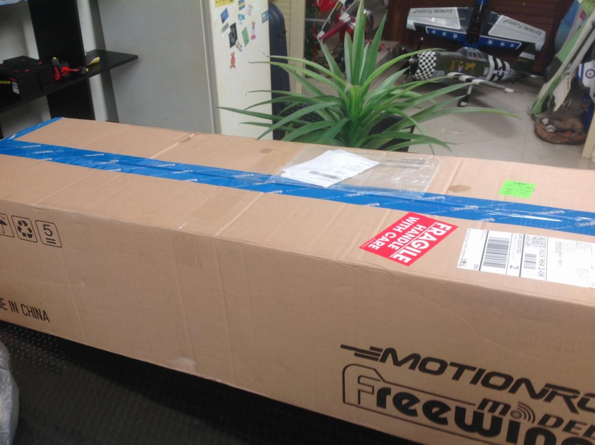

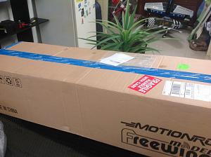

                                        • Woohoo! It's arrived...
