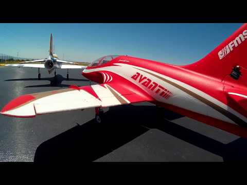

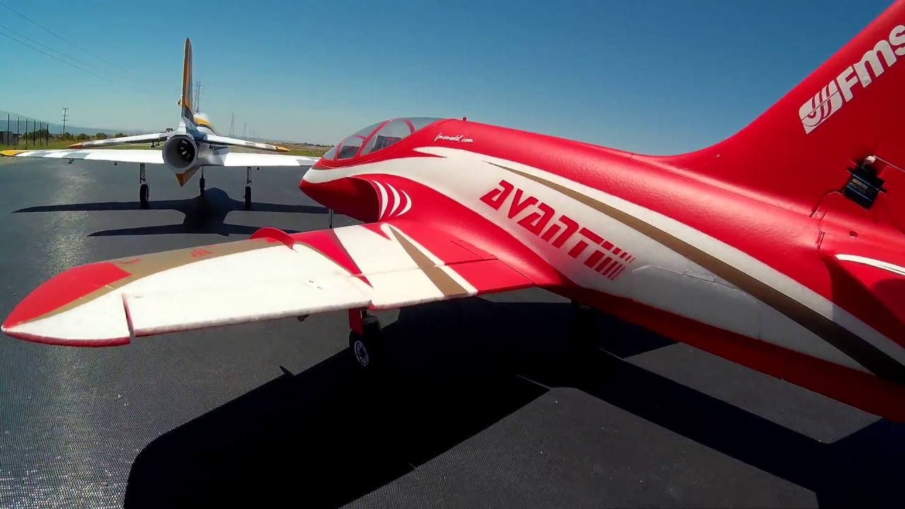

                            Hey guys... not sure if I posted this but wanted to share again. Sorry if its a repeat. I am loving these planes paired together! I have flown formation with 2 different people and the Freewing Avanti. The FMS version actually works really well with this plane! They are matched perfectly! I will get more video... here is one from a little while back...
