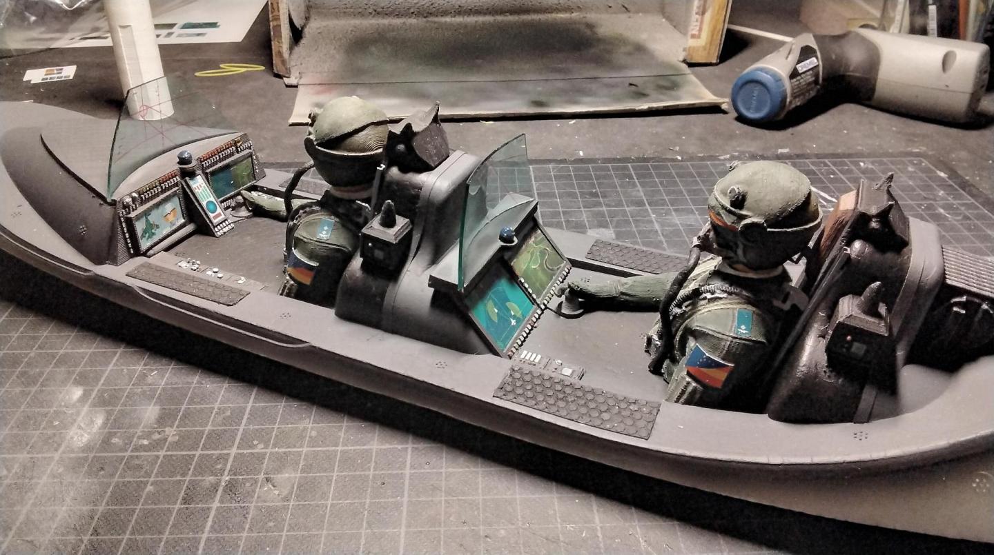

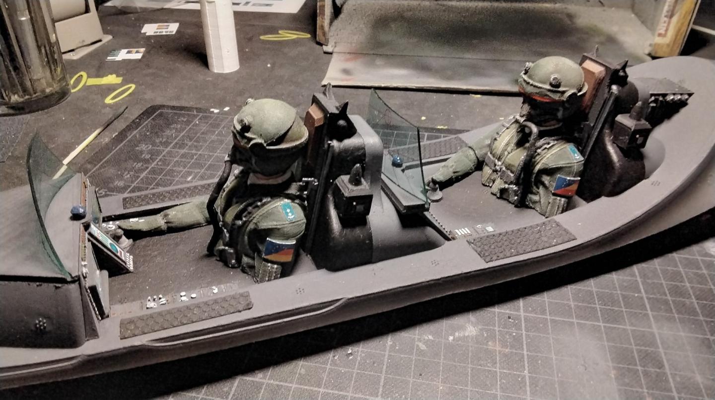

                  my Avanti-S just finished her maiden and the first few test flights a few days ago...and she does fly great but to be honest i was a bit surprised that the aileron numbers from the manual were way to high in my opinion...and i mean way to high...and i went even lower that the low from the manual as my high, and she still felt a litke a drill to me....so lucky that this thing can fly as slow as a falling leaf...so no harm in the end. A few test flights later and she is dialed in now...at least good enough to start with the rework into the M-Version...added an engine and landing lights so far, while my 3d-printer is doing his thing....this gives me some more time to finish the cockpit and the decals...
