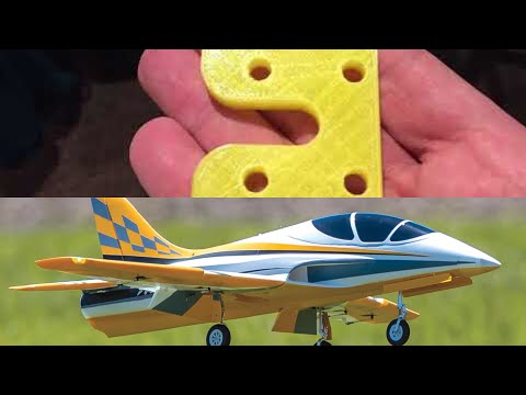

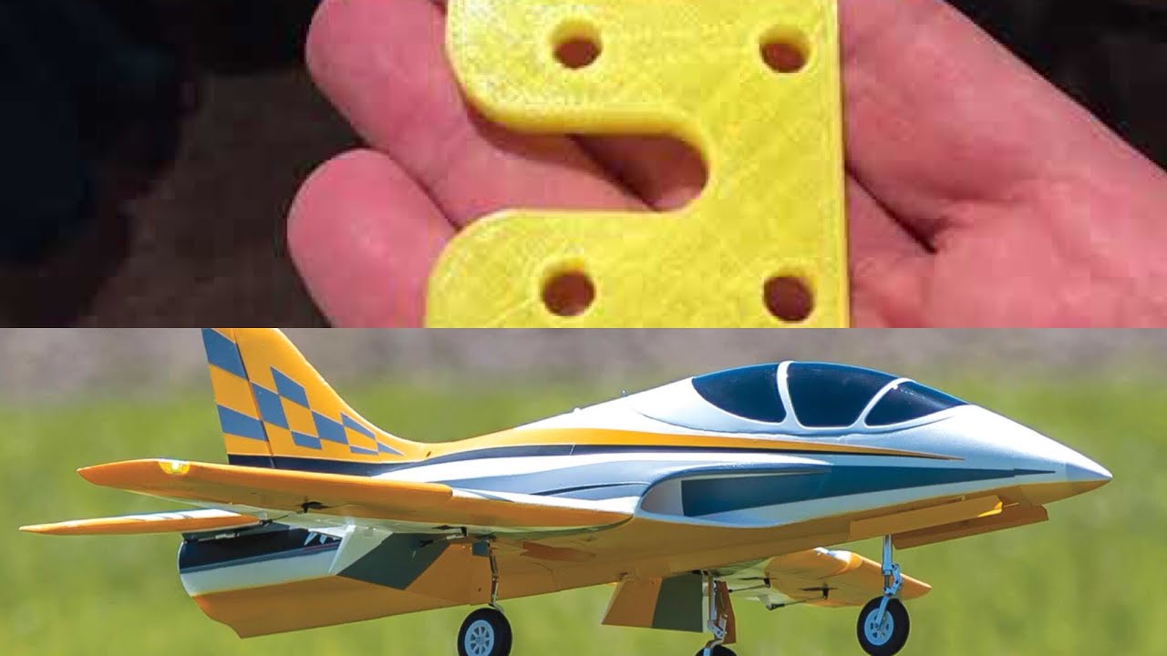

              • I have spent some time reading through all of your posts and decided to reinforce the nose gear as I fly off of soccer field grass. Thank you for the nose gear mod idea, for uploading it to Thingiverse (I mispronounce it in the video), and I gotta say it’s flawless. I made a little video about it to help those still considering how it works. I’ve got a number of fun edited videos (David Douglass) about other planes as well. Thanks guys!
                This is a part for the Nose gear brace/support for the Freewing AvantiS in ABS or PLA, 30% filling, 0.2mm resolution, 5 layers everywhere If your plane never flew yet print the +1mm, i used the -1mm because i had a crash and i bent the front gear, i could not repaired it as a new one. -1mm = 13mm from the gear to the back of the plate 0mm = 14mm +1mm= 15mm +2mm= 16mm https://www.youtube.com/watch?v=I0F_y3McXKQ
