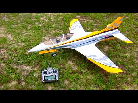

                                    OK guys; here is my 7 min flight with a 3300 mah 6S 30C /// I DON'T recommend this battery but it will work. I welcome all comments ; questions opinions. :Cool: Kenny
