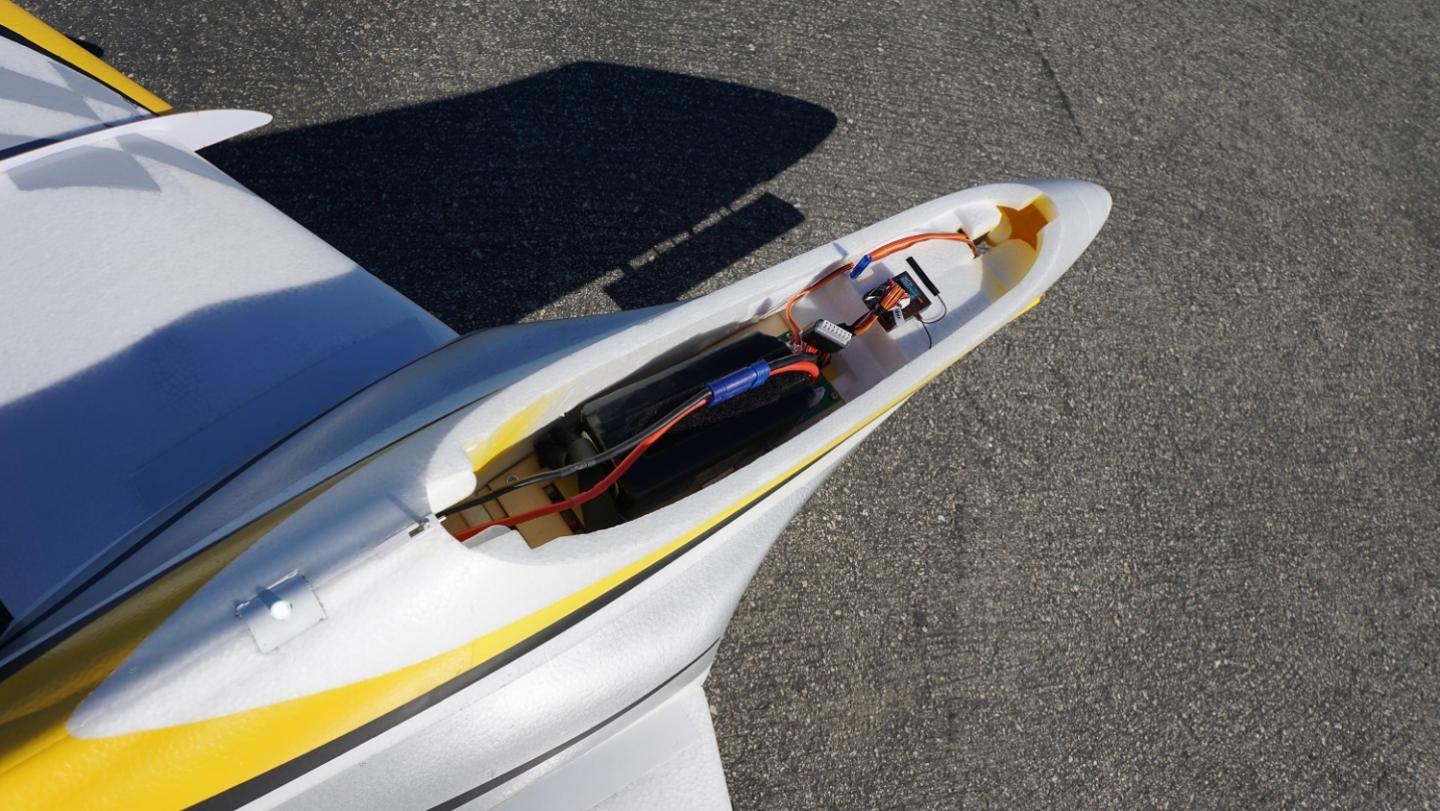

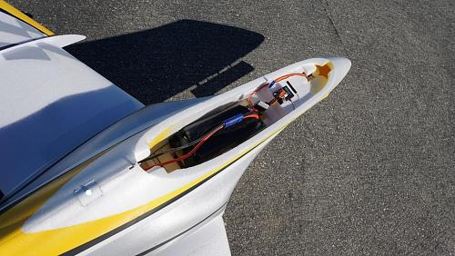

                  Hi horsefeetky, the Freewing 80mm Avanti is designed around a 6s 4000-5000mAh pack. I prefer the lighter setup on 4000, but we know many people will want to fly the 5000 pack as well and I've flown the 5000 at least 60 times so I can say authoritatively that you'll be fine.
                  Here is a photo of the Avanti's large battery bay with an Admiral 6s 5000mAh 50c battery placed loosely in it. There is room for a larger battery that can still CG; the largest I've tested is a Glacier 6s 5800mAh, pushed almost to the rear bulkhead. Of course the heavier the aircraft is, the faster landing speeds will be, among other impacts. So officially we are recommending 6s 4000-5000.

                            Hi Horsefeetky, in the initial post we've stated that the Avanti can fit 6s 4000-5000 packs as the recommended sizes. It can actually fit and CG with a 6000, but I prefer the performance and wing loading on a 4000 and 5000. So you're all good!
                            Watch some of the videos we've posted recently and you'll see what kind of performance you can expect for a given battery and given flight time. This aircraft is very efficient.
