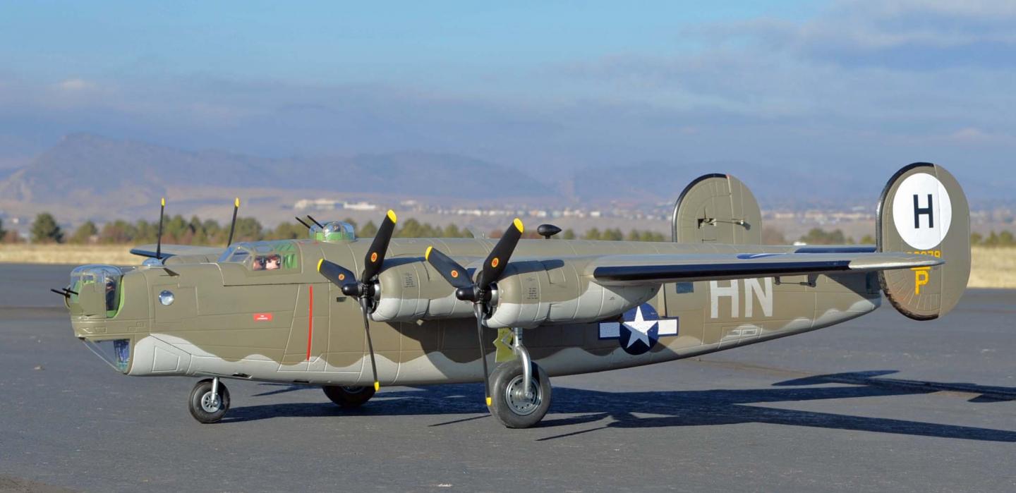

    I just received one earlier today assembled it and did the programming. I also ordered the shock absorbing Oleo struts for it so if I do not like the currently installed gear I will changed them out Very nice plane another top quality bird from Motion now for some good weather. We will be flying off some snow we are about to get this weekend here in the Black Hills maybe a total of 8 to 12" by tommoraw night and high wins with blizzard conditions tomorrow
