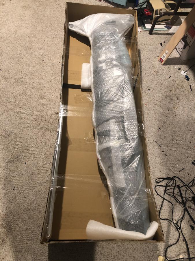

      As a reward for being one of the first to punch the please-send-me-a-super-cool-Black-Horse-Do335-right-this-minute button, I had a big box sitting on my front porch when I returned home from the flying field today. Had a great day at the field, made even better with the delivery of my big, beautiful Arrow! Unfortunately, I didn't get a a chance to open the box, as I had to immediately leave the house again. I'll probably be up all night, though, fondling my new toy. :-)

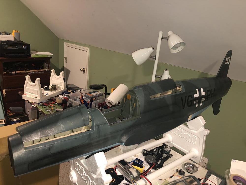

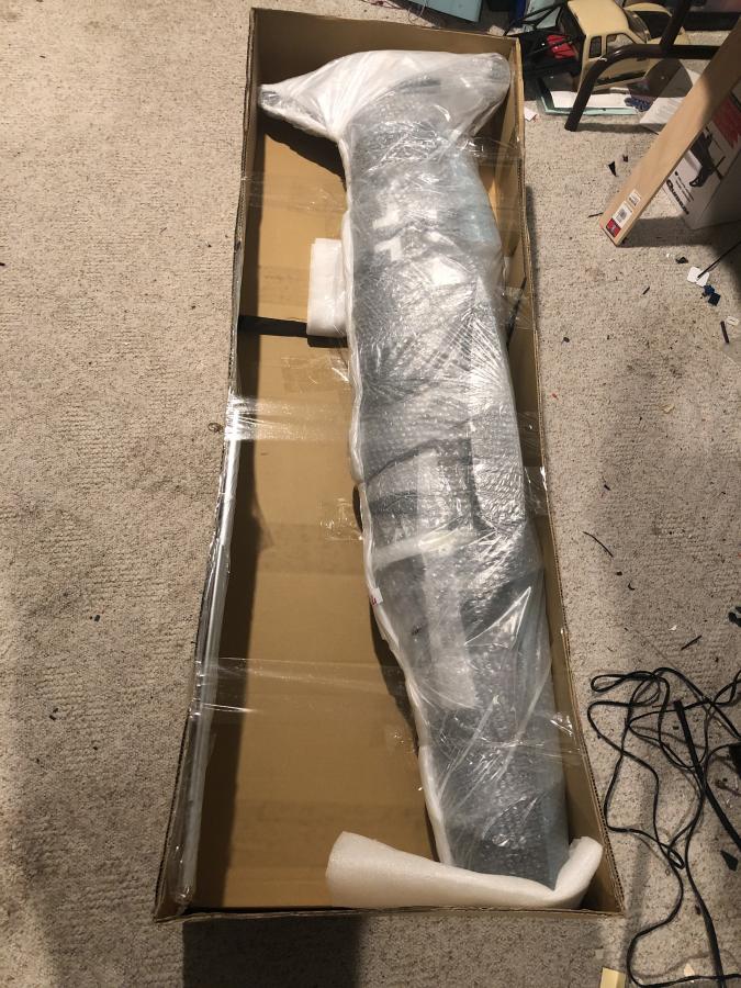

              First glimpses.
              Popped the top...
              Click image for larger version  Name:	9CAC2DFA-101F-40EF-BD27-75F0FAE78041.jpeg Views:	0 Size:	125.2 KB ID:	240725
              Beautiful weathering printed into the covering.
              1 battery bay, to answer my questions from a day or so ago. Servo Bay behind the cockpit
              Click image for larger version  Name:	D3900647-E90C-4DEC-A9EB-1A208BEA9754.jpeg Views:	0 Size:	106.6 KB ID:	240724

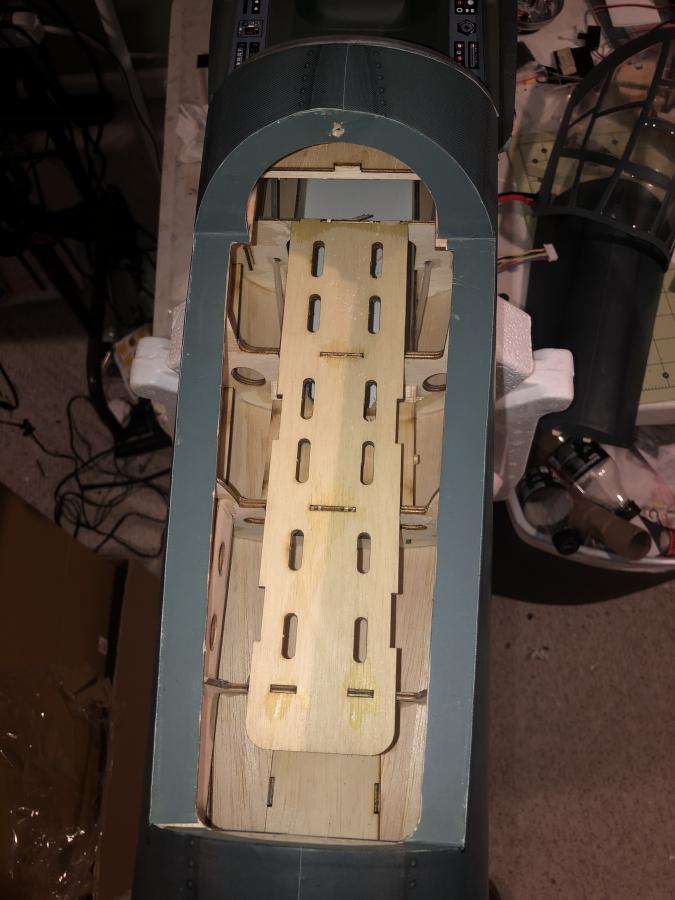

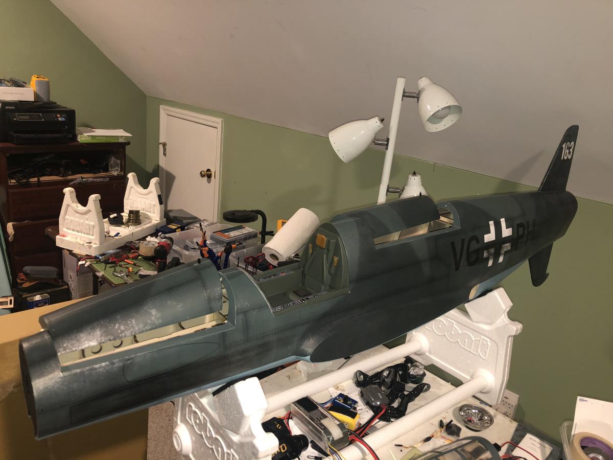

                Battery Bay, forward of cockpit.
                Servo Bay, aft of cockpit.
                Cockpit
                Cockpit removed to see internal structure. Tubes can be seen for pull-pull nosewheel steering. (See attachment)

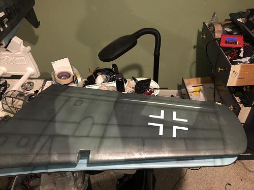

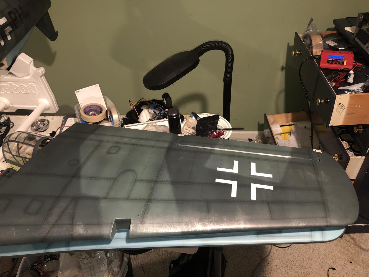

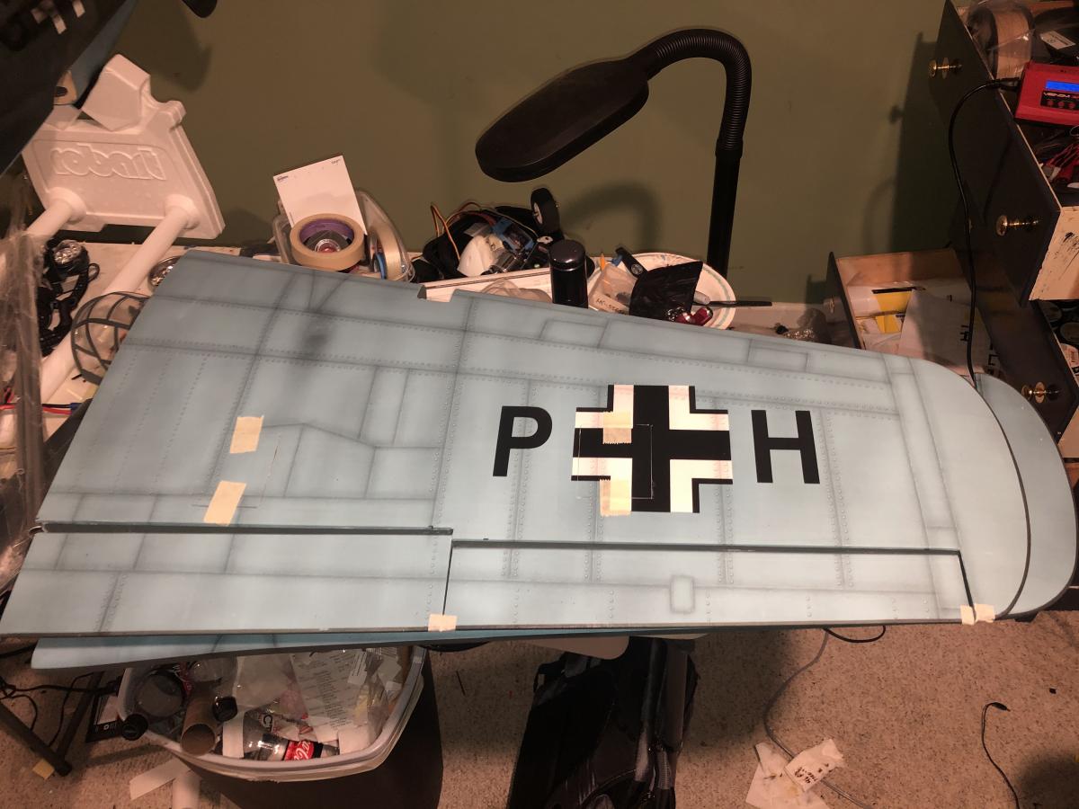

                  #48

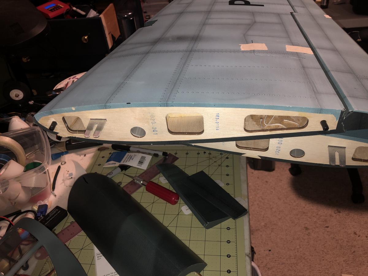

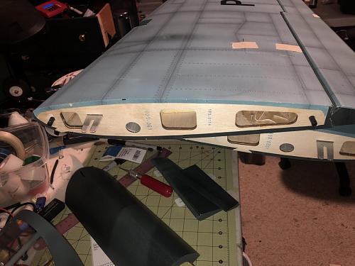

                  Wing root. Wing attachment looks very similar to my Phoenix Model A-26. Structure looks to be ~3/16” lite ply.
                  Wing bottom, with servo wells for ailerons and flaps. Ailerons and flaps are hinged with CA hinges, not yet glued in place.

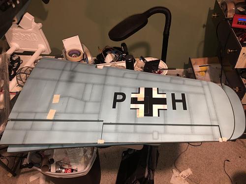

                  Wing Upper Surface. Landing Light piece included in misc parts box.

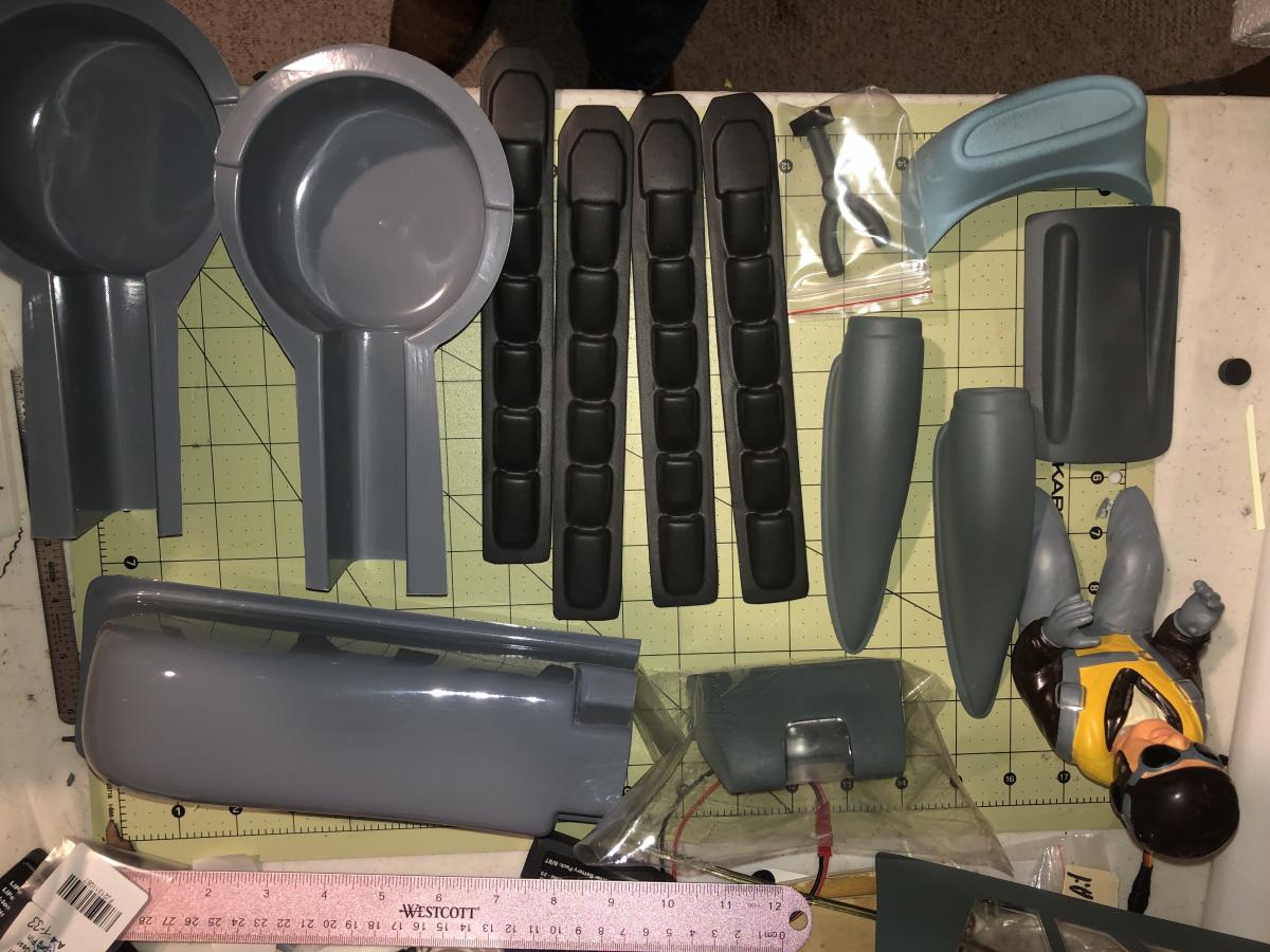

                    Vacuum-formed pieces. Pilot looks very cartoonish. I’ll probably look for a better pilot.

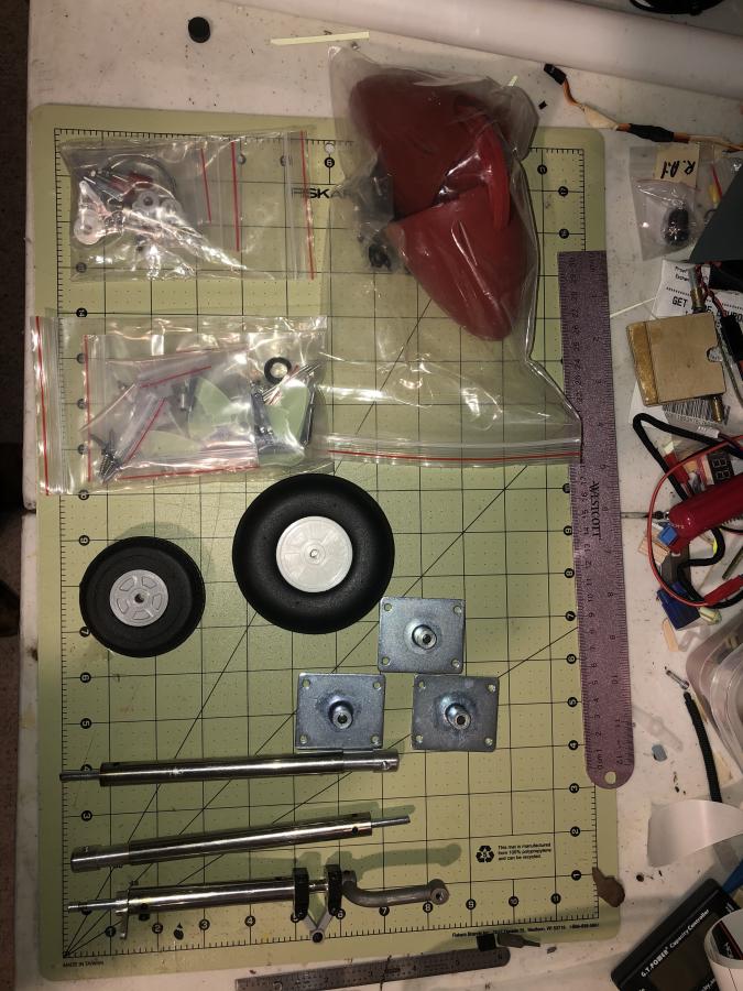

                    Struts look very strong, with suspension. Fixed. Metal plates for mounting struts. Mounting shaft measured to be 5mm.
                    Wheels are hard rubber with plastic hubs. Can’t really tell how well they’ll hold up. Mains measured to be about 3.25” dia. Nosewheel, 2.5”. Wheel diameters seem kinda small for a plane of this size. Not sure if the wheel diameters will be a problem on grass fields, but don’t think so.

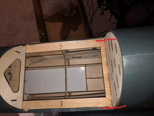

                      #50

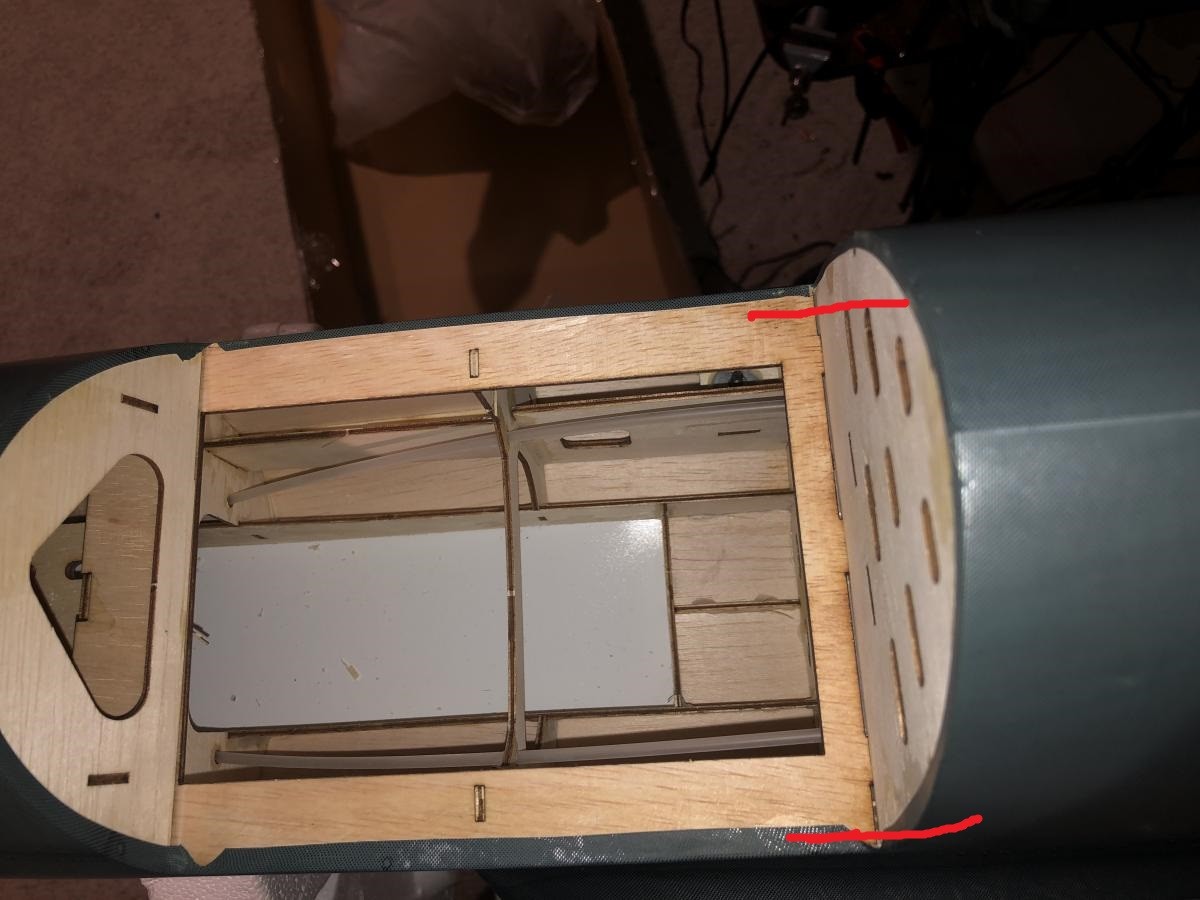

                      I would suggest that u reinforce the 2 places shown below in the cockpit area…. seems to be a weak spot on mine it started to crack in these corners after about 40 flights..ps used your pic..

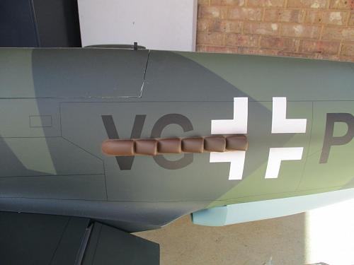

                      • Terminater007
                        • 109
                        #51
Name:	BH Do335 004.JPG

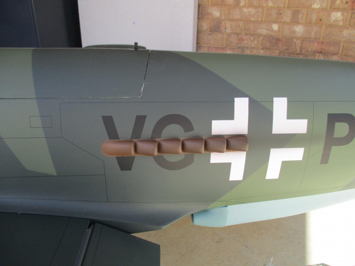

                        Also I cut out the induvial pieces of the exhaust as the supplied ones are way to big..
