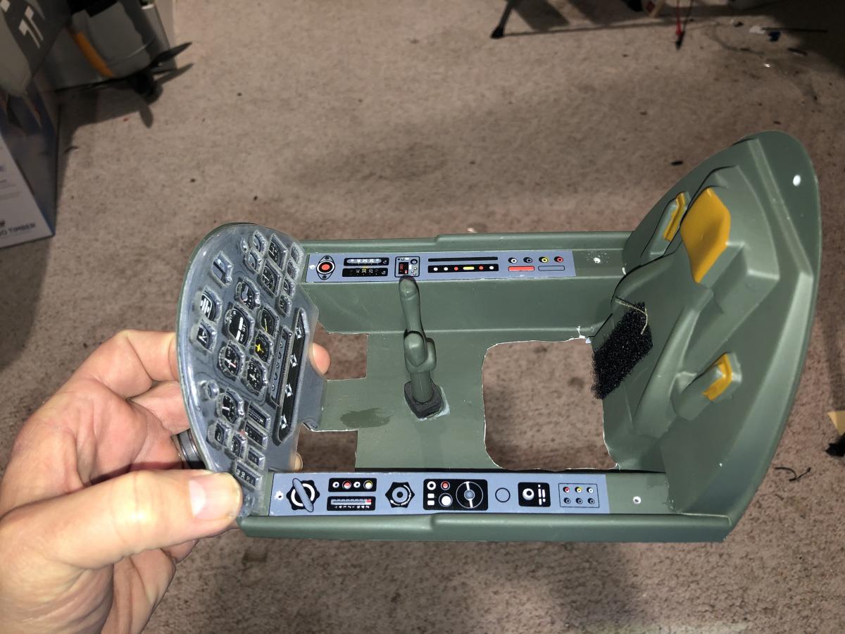

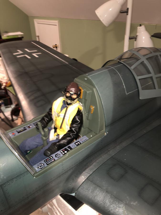

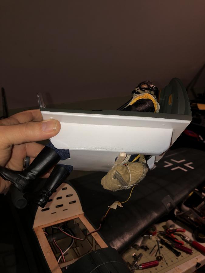

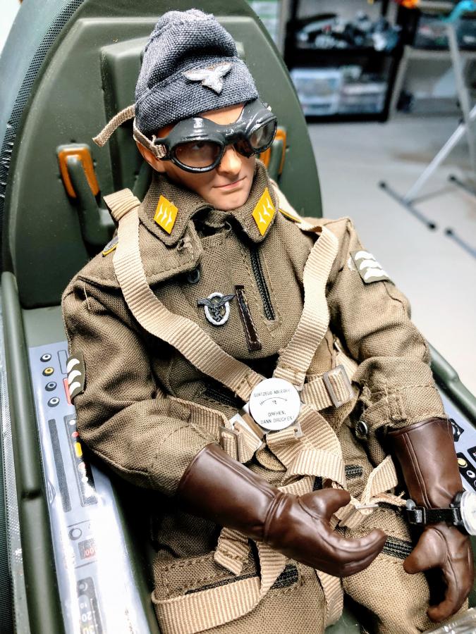

            I had a couple PMs, asking about the warbirdpilots.com pilot that I’m using. So, having nothing else to do this evening, while I’m locked inside, keeping the plague outside, I decided to open up the cockpit to take some photos.
            You can see in the photos how I cut the seat and the floorboard for his legs. I ran a balsa stick through the bottom of his parachute harness, to keep him pulled down in the seat, and Velcro on his back to keep him pulled back in the seat. When cutting holes in the plastic, cut carefully as the plastic is VERY thin in places and will actually rip, as it’s being cut. Cut very slowly and steadily.
            I did not glue the cockpit nor the canopy in place. Instead, I used #2-56 buttonhead sheet metal screws to secure them to the fuselage. I used 5 screws for the cockpit and 6 screws for the canopy.
            Before putting him back in the cockpit, I removed his life vest, since he’ll be flying Defense of the Reich missions and not over the English Channel or the Med. In one photo, he’s wearing the vest, and not in the other photo.

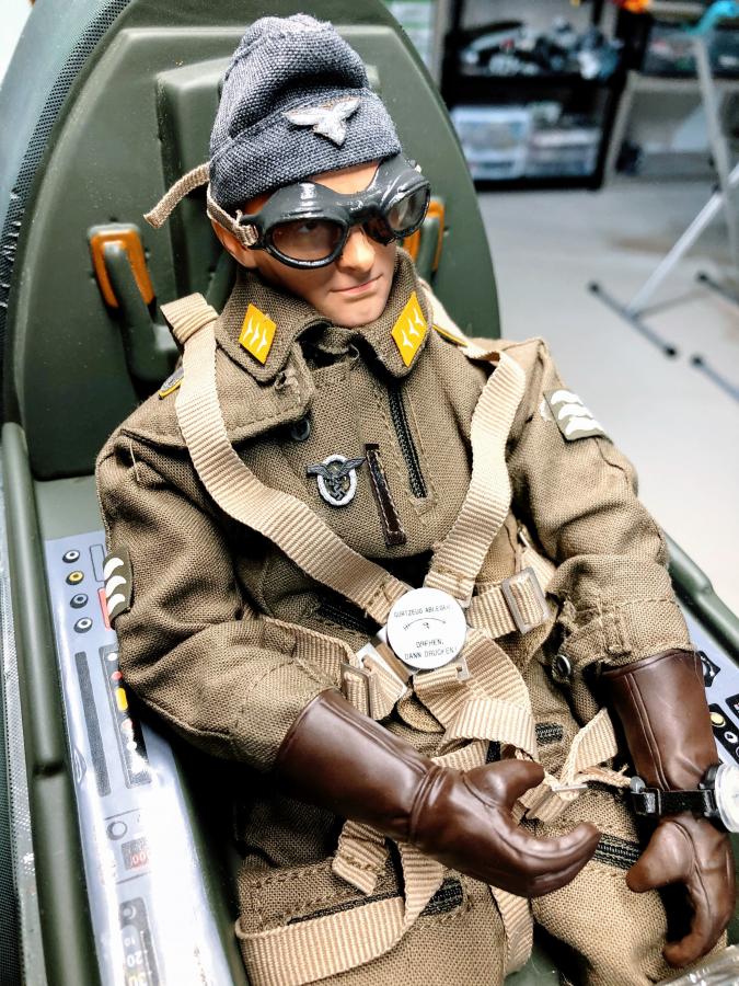

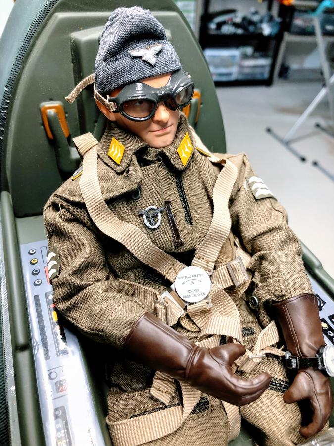

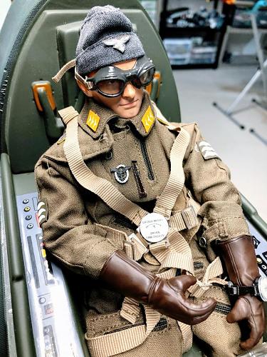

              Got the German pilot in.
                #187
                Originally posted by downwind3zero

                Another outstanding "office" mod

                  Sieg hiel!
                  Downwind, very nice.

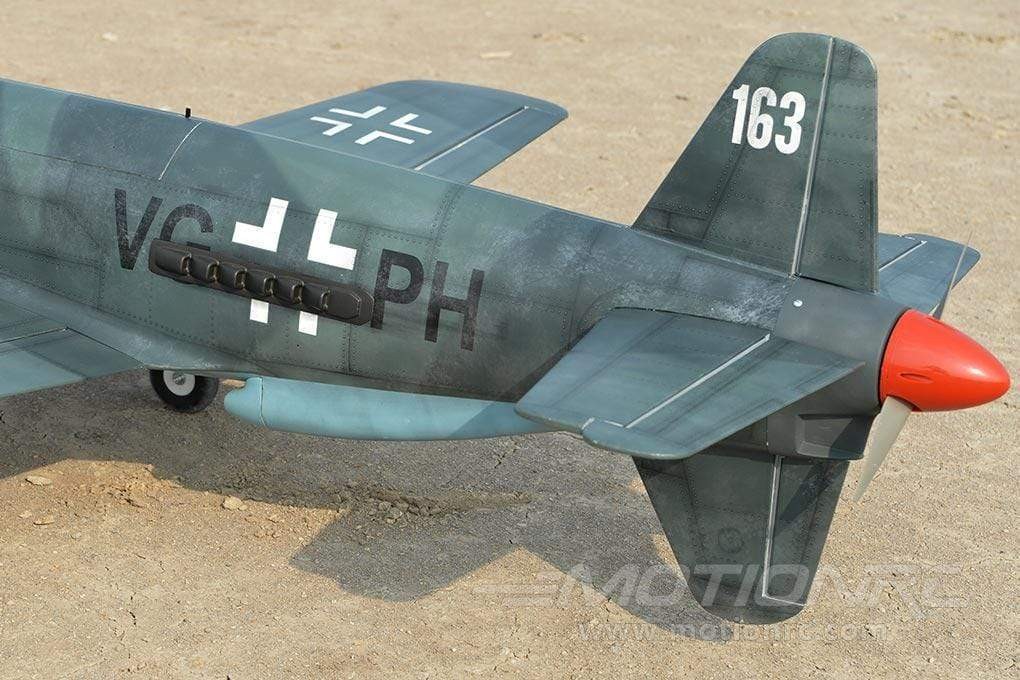

                            By the way, am I the only one who noticed that on Motion's site, the rear propeller is mounted backwards (so that it fits in the standard spinner cutouts)? Kind of funny. Hey Kids, don't try this at home!
                            Click image for larger version  Name:	black-horse-dornier-do335-rc-14035284033649.jpg Views:	0 Size:	182.9 KB ID:	245663

                              On the full scale, there is a noticable diameter difference between the front and rear props. This set-up will allow that without sacrificing overall power.

                                  TJ, is this a visual you are observing from pics?? From multiple sources I've researched (including Wikipedia's Pfeil) the engines were the same and the props are the same diameter/pitch other than being tractor/pushers.
                                  The props are 3.5m(11.5 ft) in diameter whereas the scale of this model as noted in the first post has the prop at 17 but most seem to think that the MAS 16x10x3 is the best bet to go with.
                                  By going with 2 different sized kV motors turning different size/pitched props, I'm concerned that you are going to run smack into a possible engineering issue known as aerodynamic hysteresis.
                                  Every inline tractor/pusher airframe made (Pfeil, Skymaster, Moynet Jupiter, Rutan, ect) had the same size engines and props fore/aft probably for real aerodynamic reason.
                                          Interesting -- I'd already scaled a couple of different better quality scale drawings which show the front prop being larger than the rear. I just checked the specifications chart in "Monogram Close-Up 21: Do335" and it indicates the front prop as being 3.5m dia., and the rear prop being 3.3m dia.
                                          Another source indicates that in single engine tests, the plane flew faster with just the rear engine. Either it comes down to greater efficiency of the pusher prop (using smaller diameter), or perhaps the stress on the drive shaft which was apparently under-strength and problematic throughout testing...
                                          I too had wondered how it would fly with a slightly smaller motor on the back with a one-inch smaller prop (16" front, 15" rear). Regardless, I'm now on the course of identical motors/props front/back.
