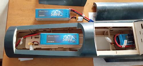

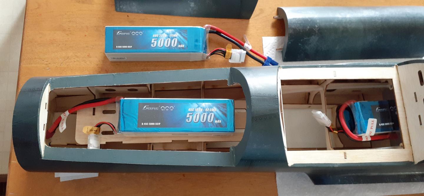

            Only one 6S-5AH battery will fit in the battery bay. I'm wishing that I could fit two 6S-5AH batts in the bay. I should probably be looking for a significantly larger capacity battery.

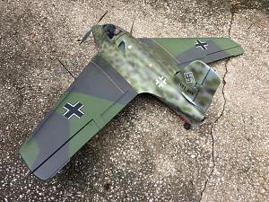

              Mine arrived as well and luckily there was no damage to the tail but can easily see why that can happen. I agree Mr. Smoothie, I hope the covering will be easily accept paint but maybe the wall paper like finish will grow on me after a while. Is this a plastic film with paint on it or a painted paper type covering? Maybe add some saffron yellow or red to it and not red spinners. I tried the link from the 4s application video but no luck. I would like to know what motors etc. he used. I am thinking he went that route, 4s and 8000 mah, to improve flight time, preferring scale flight over speed. Like you Oxo, I am wondering whether a second 5000 6s battery could be added, maybe by making the canopy/pilot area a removable hatch and getting a second battery in over the wing? Not yet sure what the complications would be to try that. The model seems big enough to carry a second one, but as you say a battery larger than 5000 seems needed. It is my first twin which will be a learning experience. I am toying with the idea of using a lighter FMS predator 4258 550 kv motors which can run up to 1400 watts on 5-6s (only because I already have one on the shelf). That is one long power lead to the back. Is it possible to have two separate power systems and receivers? I am still early in my ideas for this plane and eager to learn more about that 4s setup and how things go with Oxo’s well advanced production with his 5055 setup. It will no doubt be powerful and quick.

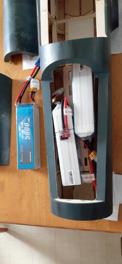

                      Oxo, why only a 5000mAh lipo? Is that just what you happen to have? I know a 6000 HRB will fit, and I just haven't bothered to try a Roaring Top 6250, but I don't think it's much different than the 6000 HRB. I don't own any 7000's but would probably look into this (to see if one will even fit) after some successful flights.

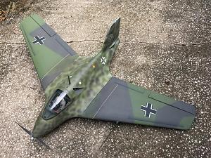

                      I have little doubt that I can repaint this material, although obviously I haven't tried. My most recent project (a total rebuild of the old CY Models 61" ME-163 Komet) included painting the iron-on covered wing panels and this was a total success -- I've had zero issues with adhesion. I realize this isn't the same as the Do335's material, but I'm confident that the iron-on covering is more of a challenge than what's on the Do335.

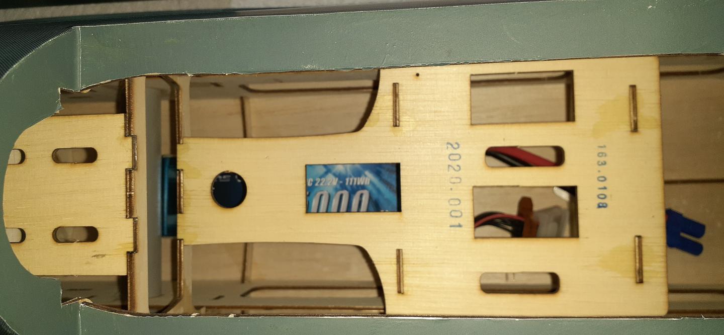

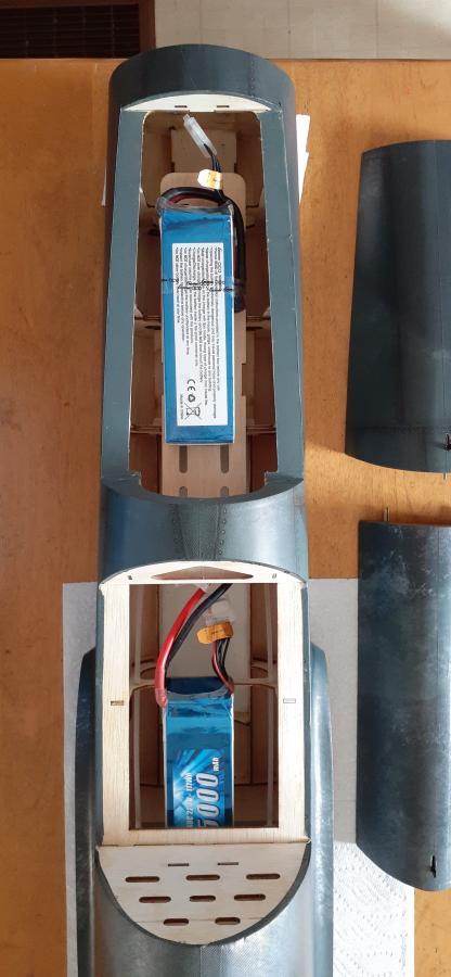

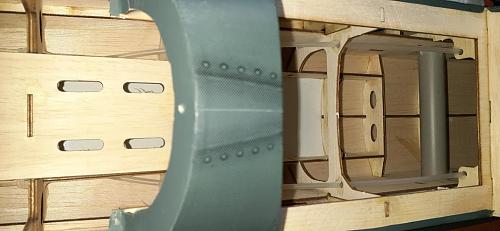

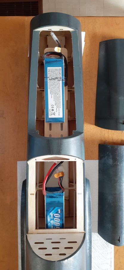

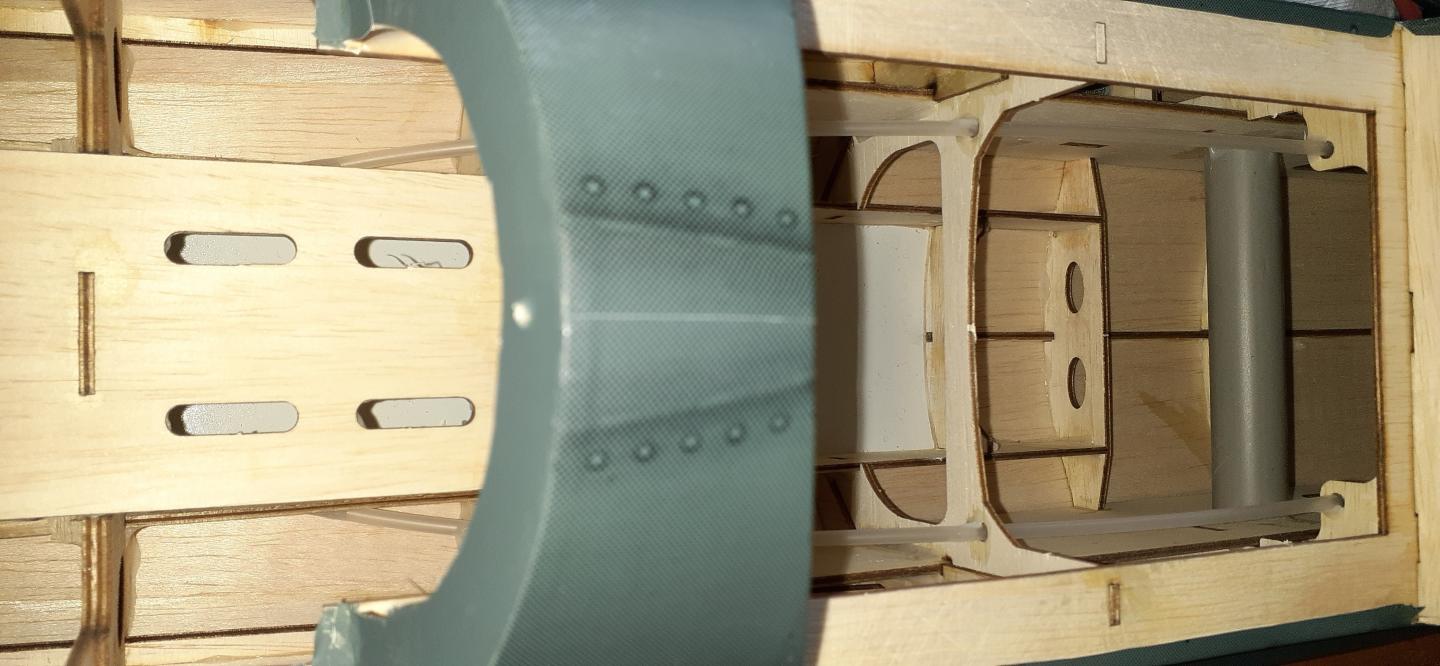

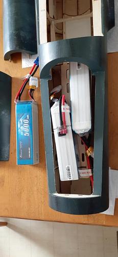

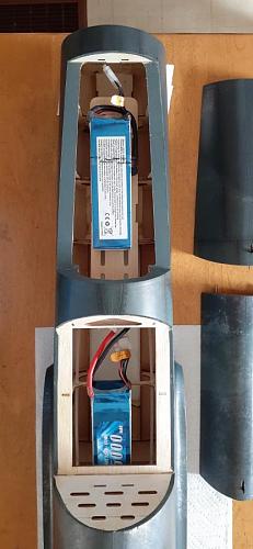

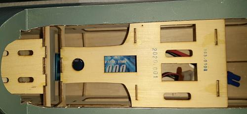

                        Oxo, since you are more advanced in the build could you comment on the possibility of installing a second 5000 mah 5s or 6s battery below the canopy area or front of the wing area or even directly over the main wing spar. My thought is to make a hatch out of the canopy/cockpit materials and put in a battery floor directly below it and extending past the main spar tube if possible. Maybe the battery floor would have to be at an angle and even intrude somewhat under the canopy.
                        To add a battery floor, the former has a brace which might have to be lowered and the former itself reinforced overall. Depending on CG and if there is room, the battery could even extend over the wing spar a certain amount. Are there any obstructions, either mechanical or electrical which are installed which would prevent this modification? Would the retracted wheel be in the way of lowering the former brace? To avoid obstructions, the battery could be even angled at say 45 degrees such that one end of the battery enters the cockpit area. Would you have a photo of the area under the canopy to see what you have installed in there?
                        Attached are some photos. I am looking at fly it both 5s and 6s and having battery location options will be useful. The first photo shows two 5000 5s fitting together in the battery compartment. The other photos could be either 5s or 6s configurations. The last is the former brace that is in the way.
                        Also, glad to read the cover will be easily paintable as I would like to add either red or yellow, even the green heart as in the previous photos.
                        Thank you,
                        Francois
                        Click image for larger version  Name:	20200316_114026.jpg Views:	0 Size:	45.1 KB ID:	24278620200316_114026.jpgClick image for larger version  Name:	image_52790.jpg Views:	4 Size:	102.4 KB ID:	242777Click image for larger version  Name:	20200316_114903.jpg Views:	0 Size:	49.2 KB ID:	242783Click image for larger version  Name:	20200316_115108.jpg Views:	0 Size:	99.3 KB ID:	242784Click image for larger version  Name:	20200316_115551.jpg Views:	0 Size:	109.4 KB ID:	242785

                          Nick, 6S-5300mah is the largest 6S that I have. I'd prefer to NOT have to buy a bigger 6S battery for this aircraft, but I will if it's needed. I'm waaaaaaay too deep into this project to cheap-out now. LOL
                          Creative, It's a very interesting idea to put a 6S battery below the cockpit. There's not much structure down there, but it should easy enough to add a little more structure and a battery sled which would better support a 6S battery. I think that there's enough clearance under the cockpit for a 6S battery. To the best of my knowledge, there's nothing below the cockpit that'd interfere with cable runs. You can slide the plastic nose gear wheel well into place, to get an idea of how much space the NG will take up. It's not bad though. Right now, I have a full figure 1/7 - 1/8 pilot sitting in the cockpit, with his feet dangling down below the cockpit, and his feet aren't close to interfering with the nose gear. I'm going to look into this some more. I'd REALLY like to have two 6S-5AH batts driving the two 5055 motors.

                                Creative, I just walked upstairs and looked at my 335, with the thought of adding a 6S battery under the cockpit. With the NG retracted, I don't think that there's room under the cockpit, between the nose wheel and the wing spar. The only viable option for a battery in that area would be to completely remove the cockpit, in my opinion. I"m not willing to do that for mine (especially after hiring a WarbirdPilots Luftwaffe pilot to drive this 335). Another option that I think is viable would be to add a battery platform above the servos in the servo back. I set a 56S-5AH battery in there and didn't see any problems with real estate. The downside to that approach is that the battery would be behind the CG, which could raise a weight/CG concern. Probably, if deciding on a 6S power train, a large-capacity 6S battery in the battery bay would be the best option.

                                  I agree that I'm probably going the route of a larger 6S battery. There's certainly room for it in the battery bay. I'd prefer to not have to buy a larger battery (6S-5AH has been a sweat spot for me, as I have 8 or planes that use that size battery), but I will if needed. I can live with EDFs having only 3 1/2 minutes of flight time, but I'd like for my prop planes to get 5 minutes, easy, of flight time.
