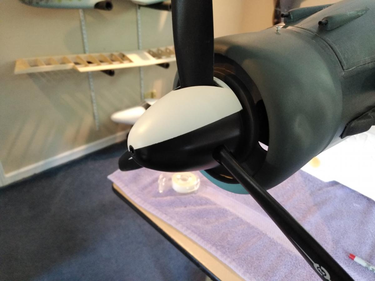

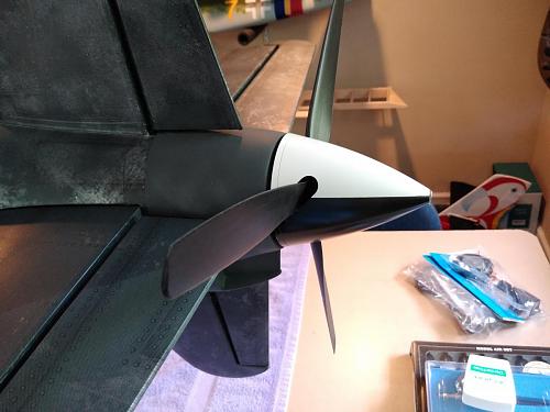

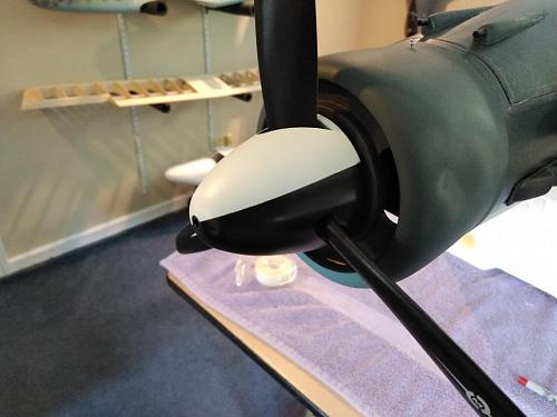

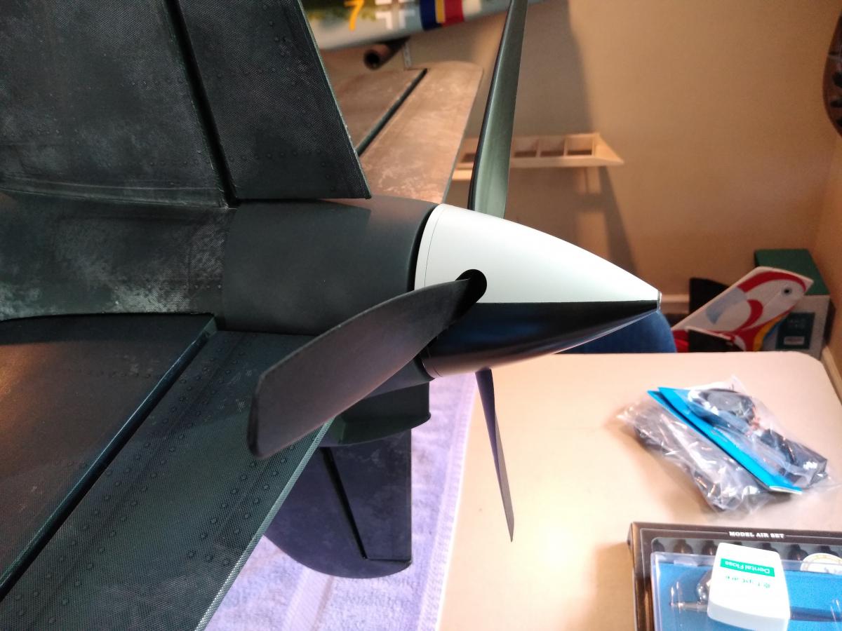

      Finally received the spinners from Tru-Turn. Time to finish her up and get to flying. The half white, half black gives an interesting effect in flight. Simular to what was done on the BF-109

          The pic of the front spinner makes it look more elongated than it is. The front is a 3" P-51 style and the rear is a 3 1/4" Ultimate style.
            A little trick a professional photographer taught me years ago to reduce this kind of visual distortion -- back away from the subject and then zoom in with your lens. You can test the same effect on another person. Getting close the subject will make their nose look huge. Back up and zoom in, an their nose will appear correctly.
            The spinners look great and from all I've heard are top-notch quality. I won't tell you the hours I put into the design of my spinners, let alone all the prints I made. But I did learn a lot in the process which was a goal. The only advantage mine have is a very close to scale profile. I'm just glad they have held up well.
            BTW, the Master Airscrew logos come off quite easily with acetone. Luftwaffe blades at this time didn't have any graphics or even yellow tips, so just didn't look right to me. From what I've read, they weren't even black (!) but a very dark green! I couldn't bring myself to do that however, haha.
