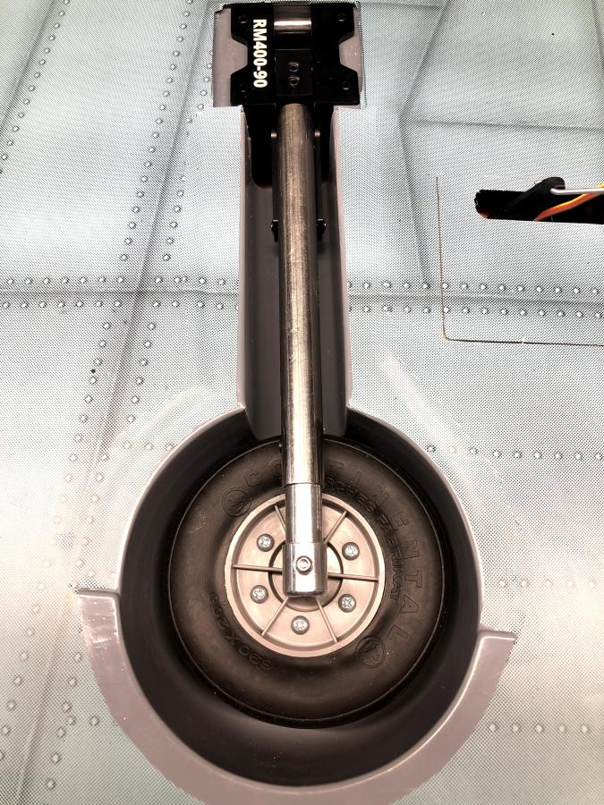

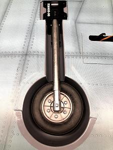

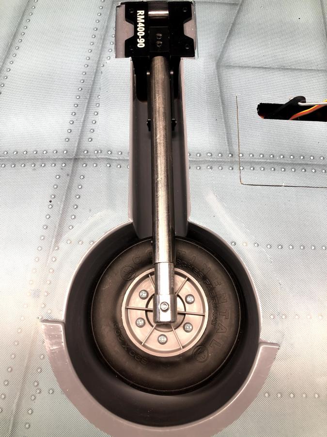

            Didn't like the gaps in the wheel wells so I used the covering from the cutout of the wells to cover the gaps up.

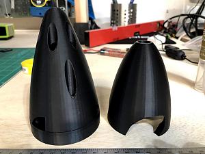

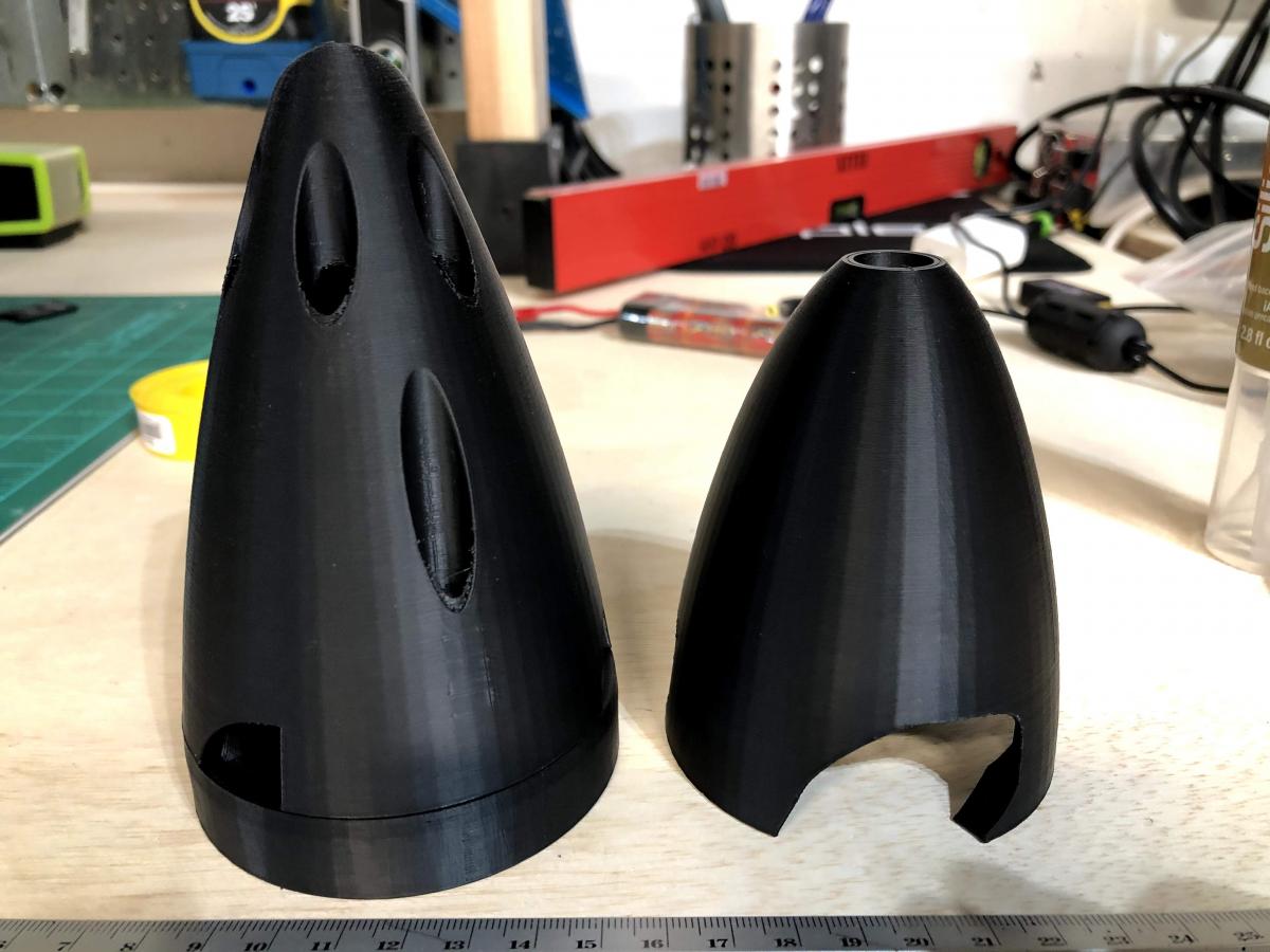

                I printed 2 spinners in the correct sizes to get ahead of the game and NJ closed all parks and flying fields today - I can't win.

                  downwind3zero good idea with the vent holes in the rear spinner. One of my concerns with the rear motor was heat as well. When I ordered the tru-turn spinner for the rear, I opted for the lightened backplate in hopes that it would also draw air through.
                  I intend to make all of the air scoops functional as well. The lower scoop will have a cleanable screen to keep debris out.

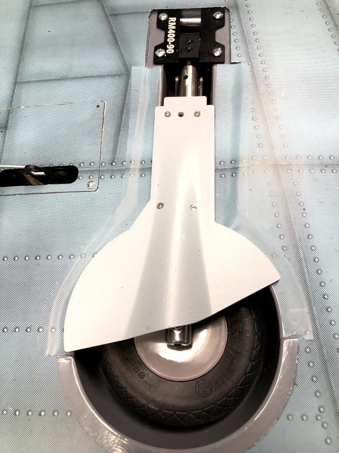

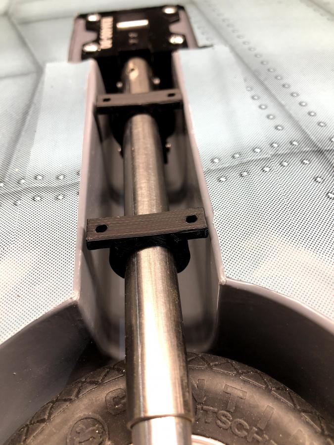

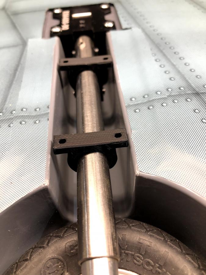

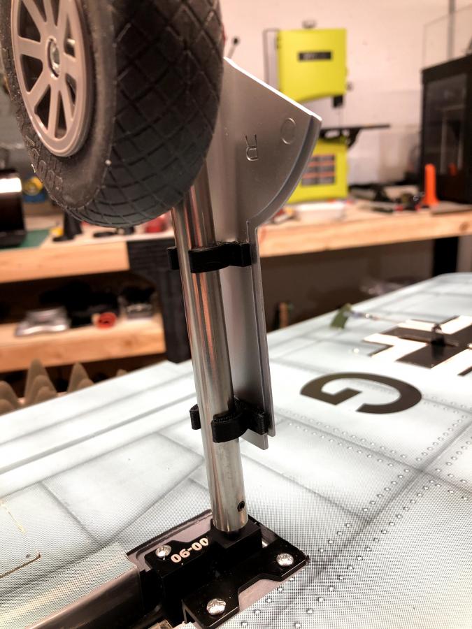

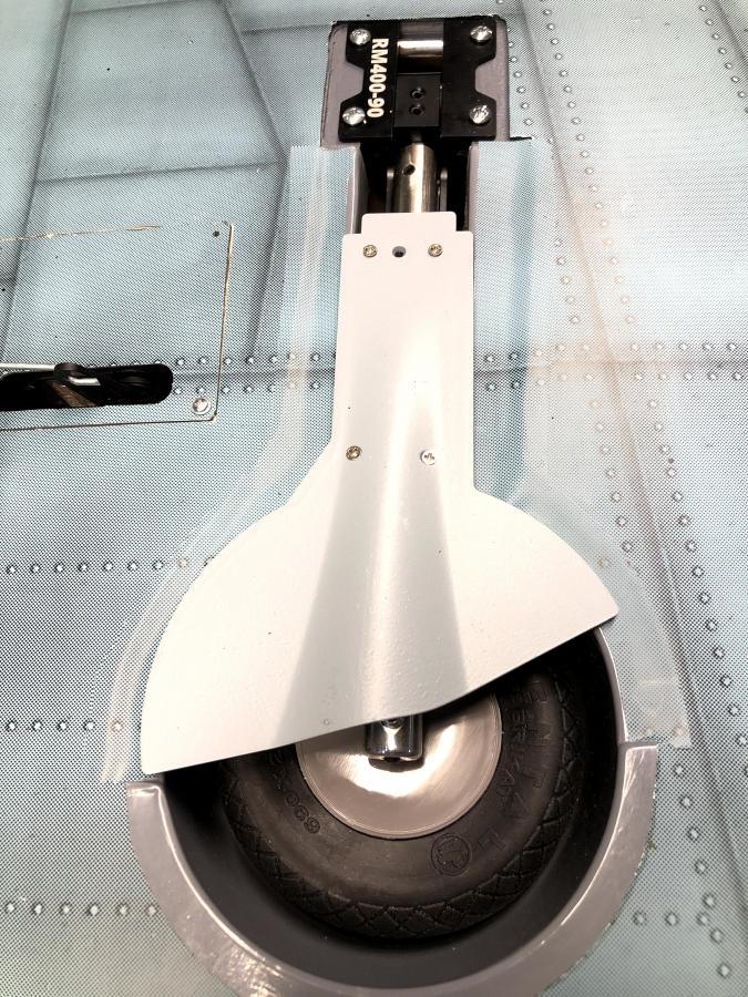

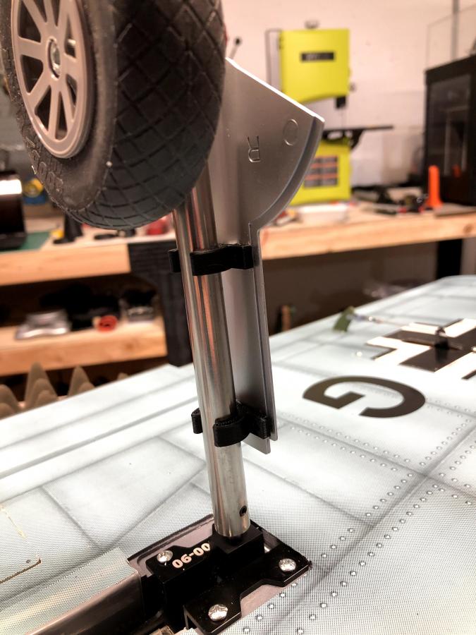

                        Better than nothing; found the Flightline spitfire 1600mm gear doors to fit pretty well. Printed a couple of clamps for the struts and attached the covers.
ID:	247878Click image for larger version
ID:	247879Click image for larger version

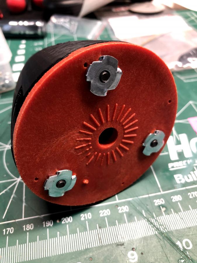

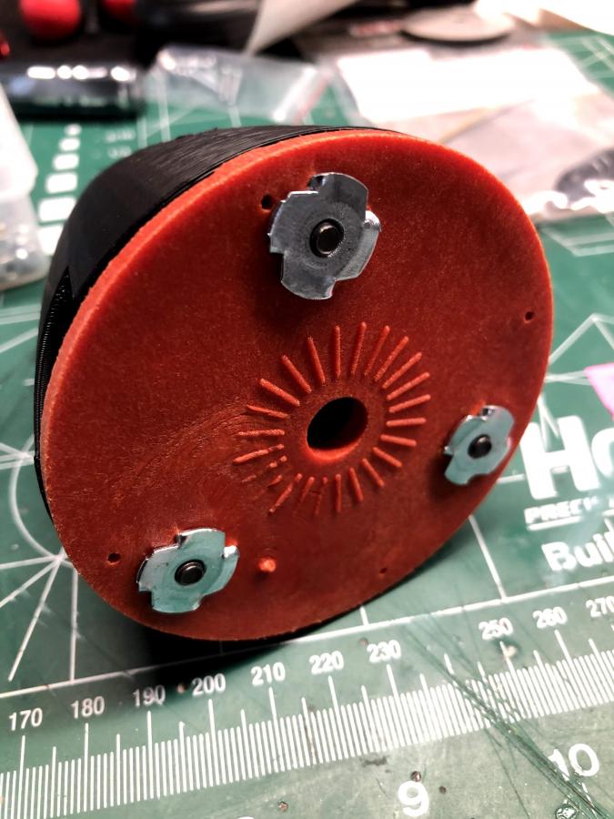

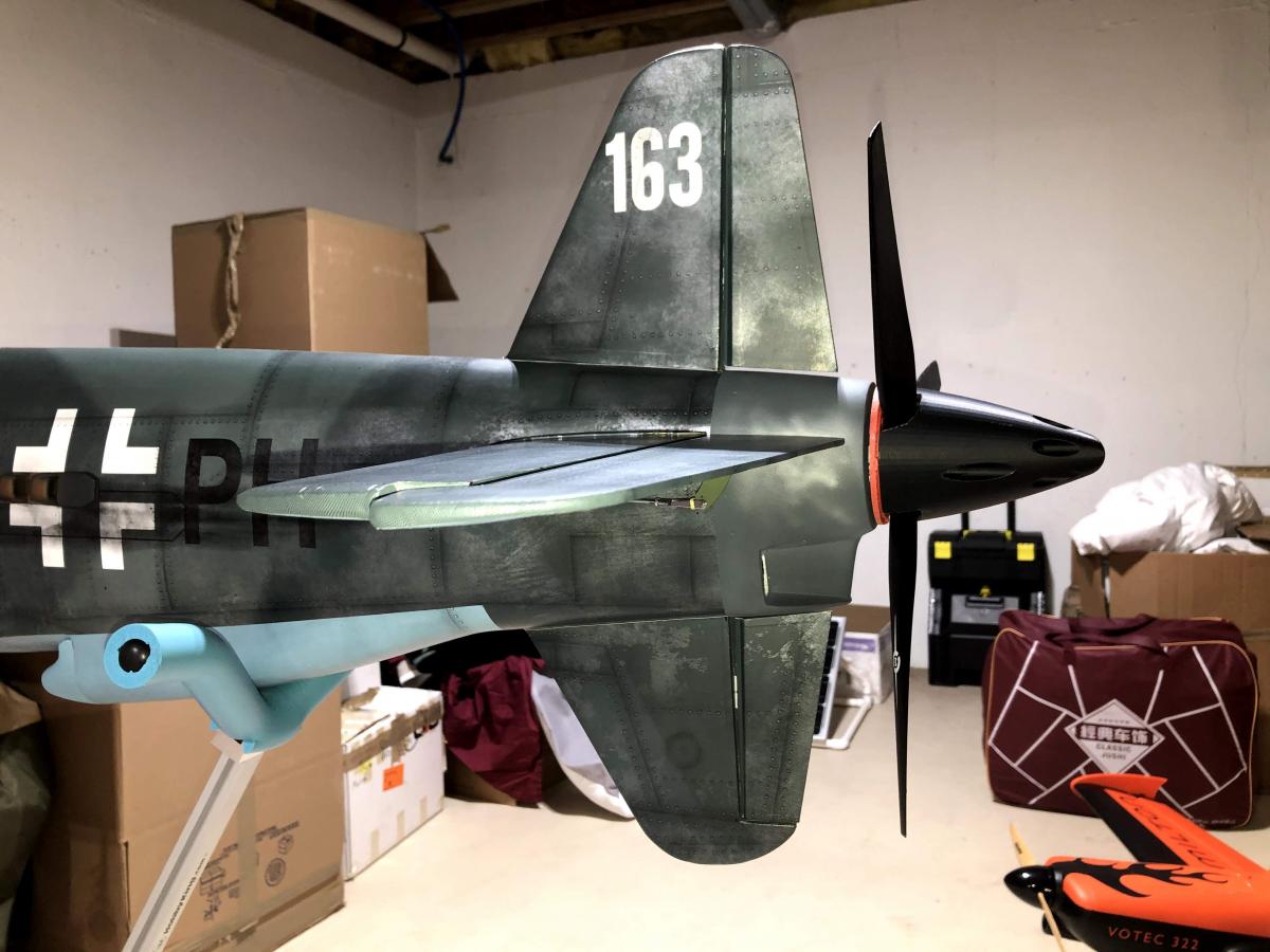

                                Used the printed spinner with the original backplate. Heated the nuts and compressed with vise to seat them. It's not a tru-turn but it turns true :) Better than nothing.
ID:	248098Click image for larger version

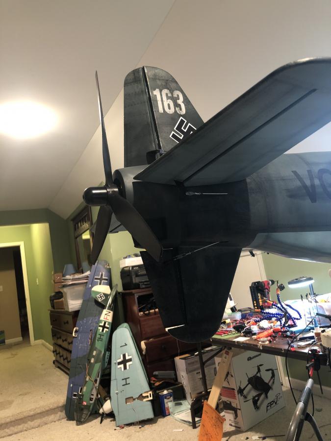

                                      So, I’ve decided to try to get my 335 into the air tomorrow. I’ve kluged together a makeshift aft spinner, using the prop adapter from the FlightLine Spit 5055 motor and the spinner from the FlightLine Corsair. It’s far from an accurate spinner, but it’s better than a bare prop.
                                      I had more to do, to be flight-ready, than I thought. It’s already getting late, and I’m getting worried that I may be rushing. All I really have left to do is to balance her, I think. I’ll do that in the morning. If no surprises and the weather is decent, hopefully, I’ll get her into the air tomorrow afternoon.
