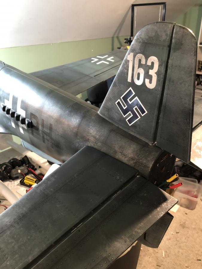

                                  Thanks, Callie. The 335 is now properly marked. :-)

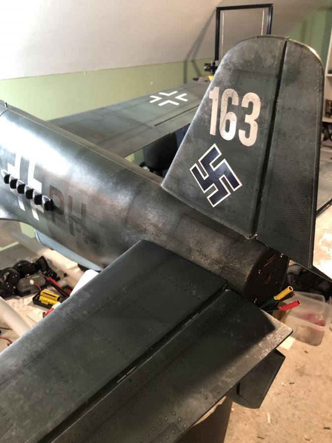

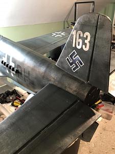

                                      For you guys that may be ordering TruTurn aluminum spinners. I special ordered the pusher motor spinner from TruTurn and am having them anodize it black. The tractor spinner, however, I found on the shelf of my LHS. It’s also a TruTurn, although it’s a little larger than scale. To blacken it, I grabbed a rattlecan and of Krylon Fusion all-in-one Matte Black, and it went on to the aluminum spinner beautifully.
                                      I’m getting close to having her flight ready!!!

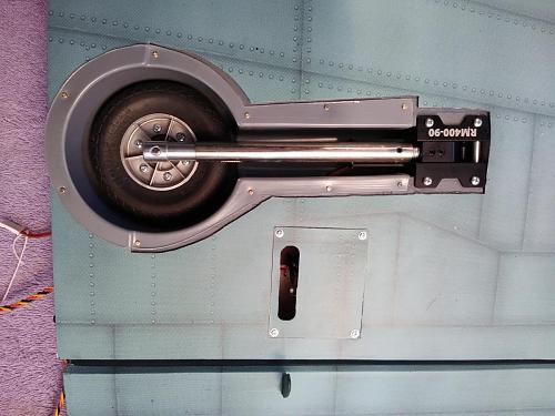

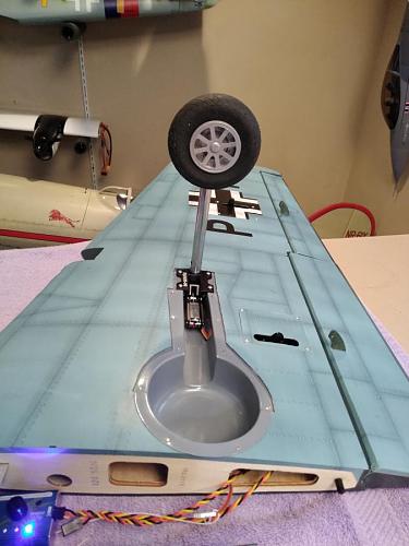

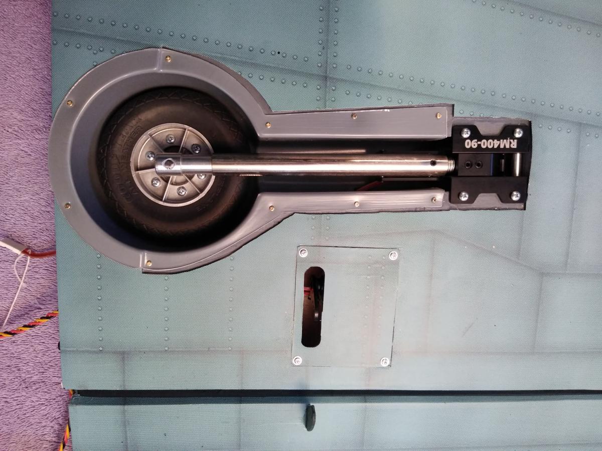

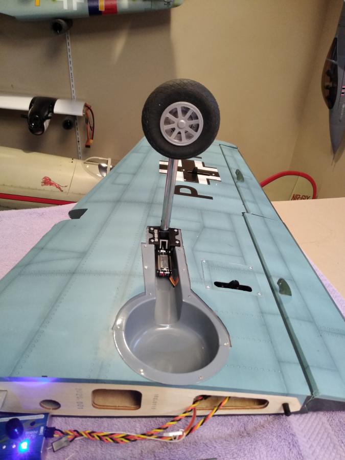

                                        While I'm impatiently waiting for the motor for the Black Horse Gilmore to arrive, I got started on my 335.
                                        Wing servos and horns in. Put on a set of Robart 3 1/2" diamond tread wheels. They work fine. Had to shorten the axel bolt and install 3 ea. 5mm washers as spacers for the tire to clear the strut. Also found out that one of the retract mount blocks was milled a little too deep, causing the retract to bind a bit when retracted. A couple of washers under the wheel end of the retract put it back where it shound be.

                                          Oxo, with that big prop and big and long black front spinner, it is one menacing looking war bird. I half expected the pilot to wave when I saw how realistic it appears. Anything with feathers and anyone on the ground will most certainly be afraid of it. Heads will turn. Look forward to reading your flight reviews and how this power setup performed. Like a rocket comes to mind.
