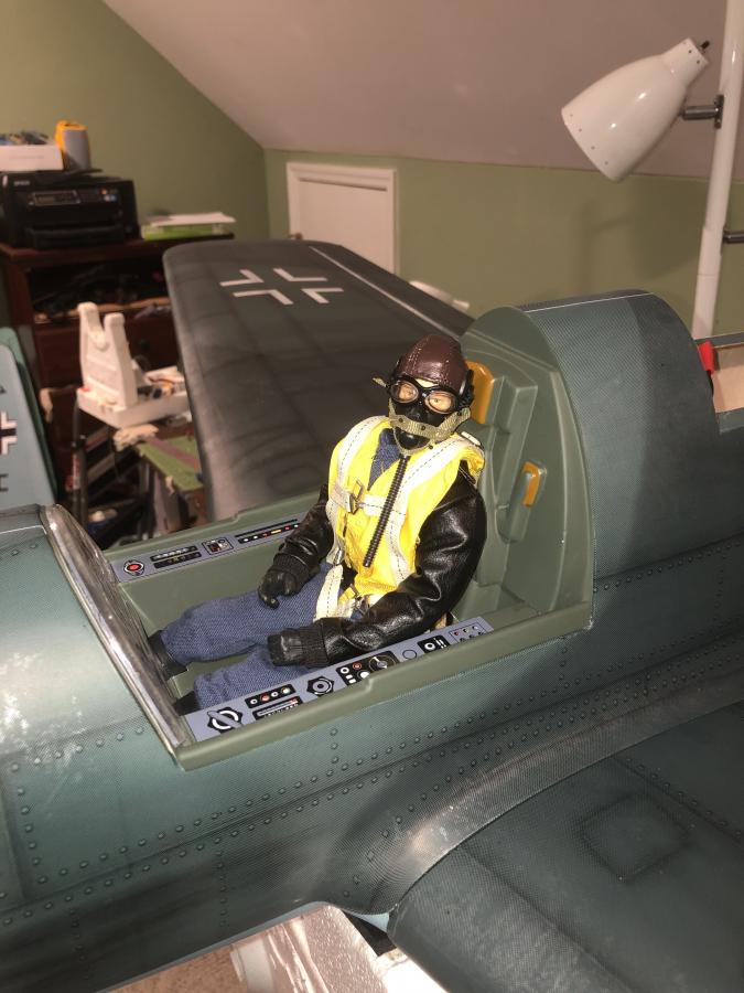

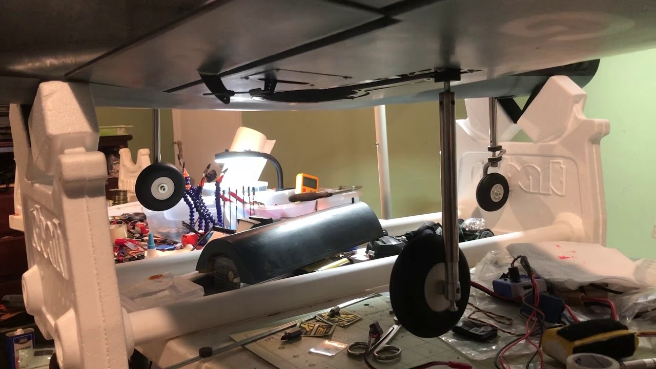

                  Received the XWave RM400-90 for the nose gear yesterday and now have the nose gear installed, including the NG steering. Getting the pull-pull cables the right length was a bit tedious as the NG Steering Servo is pretty far forward in the servo back and there's not a lot of room up there to fiddle with tensioning the cables. I'm glad that I have small hands. LOL
                  I did finally get the pull-pull cables tightened up and to reward myself, I dorked out my 335, by programming the gear to retract on different delays. Why? Because I could. I'm such a dork.
                  Hopefully, my motors will be delivered this evening.

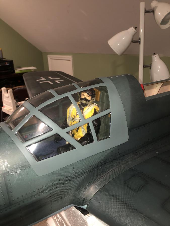

                  And if anyone is thinking about hiring a full-body pilot to drive their 335, the 1/7 - 1/8 scale WarbirdPilots pilot will fit. The seat will have to be cut out to lower him so that the canopy will fit over his head. Openings will also have to be made under the instrument panel for his feet to reach the rudder pedals. Easily done.

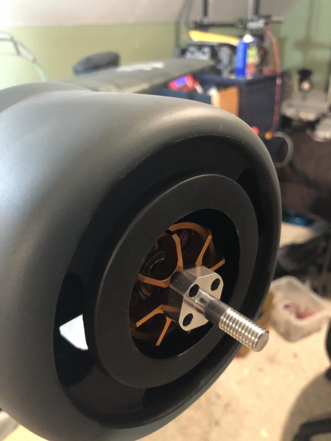

                      For those considering the FlightLine Spitty 5055-390 motors. Test fitted mine a few minutes ago.
                      Mounting holes need to be drilled ~ 1/4” outboard of the existing 3mm holes. The length of the motor is just about perfect, to fit within the cowl. Maybe a small shim is needed, but not much of one.

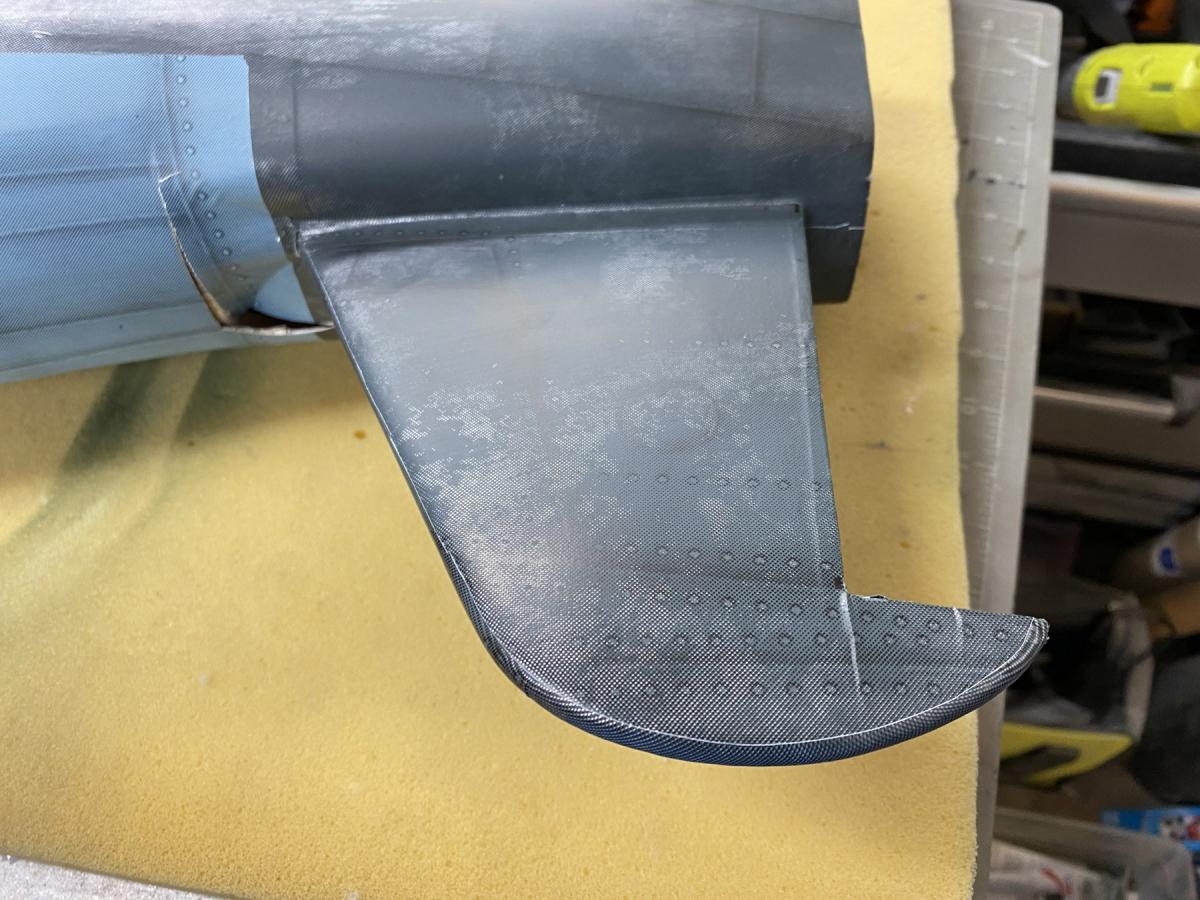

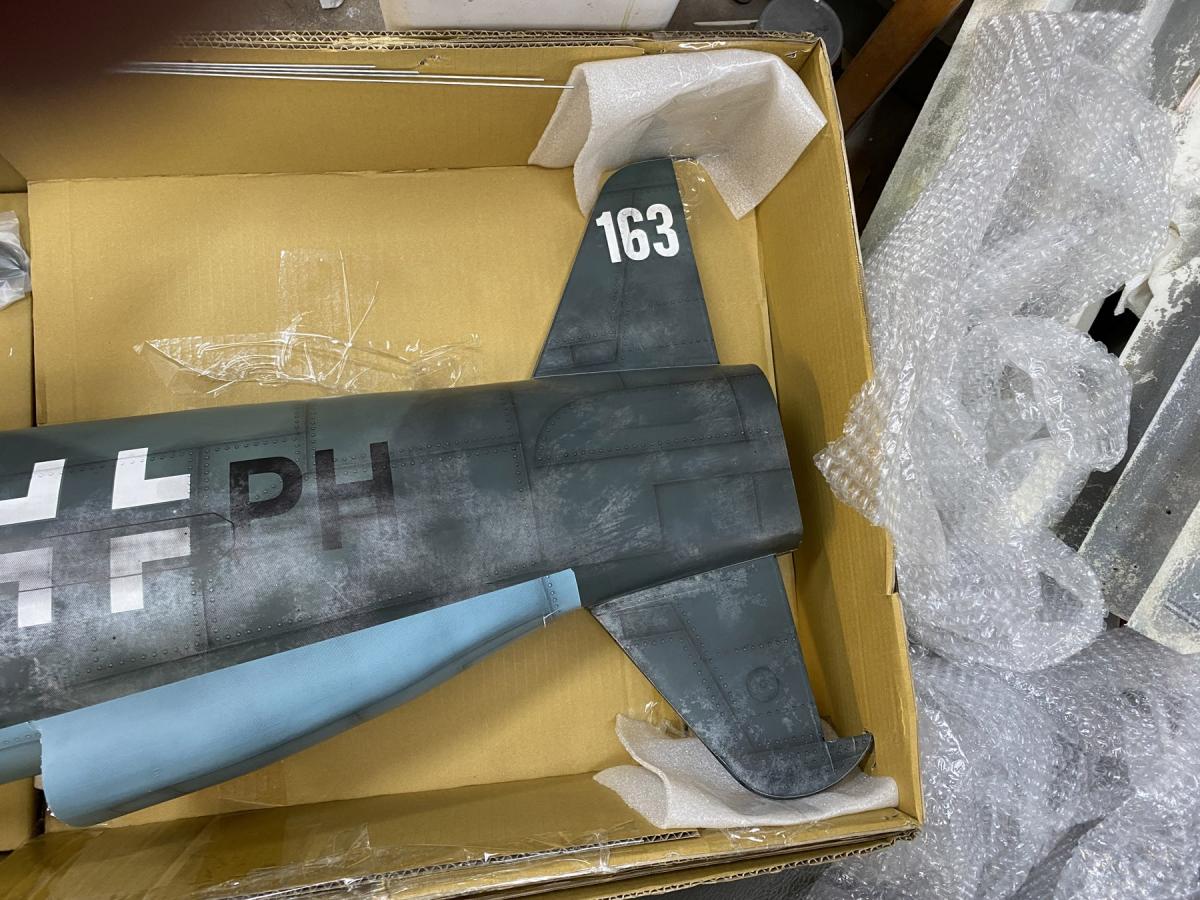

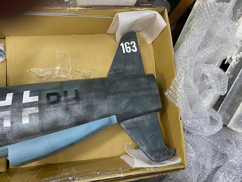

                              #114

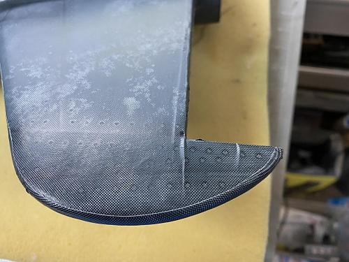

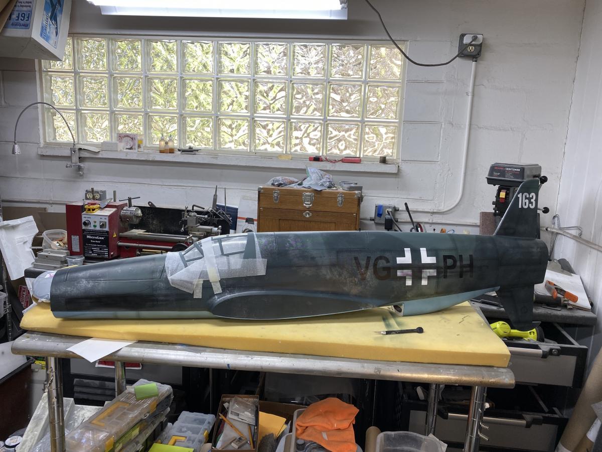

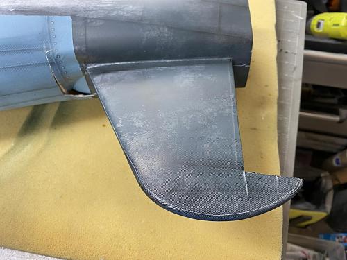

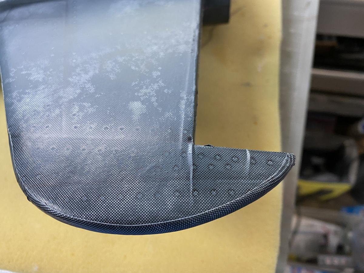

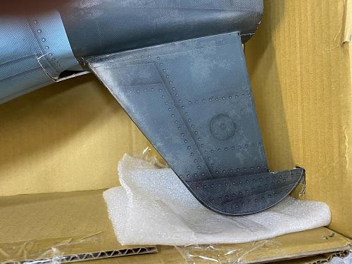

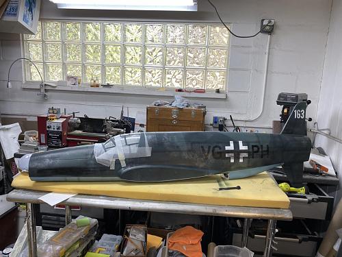

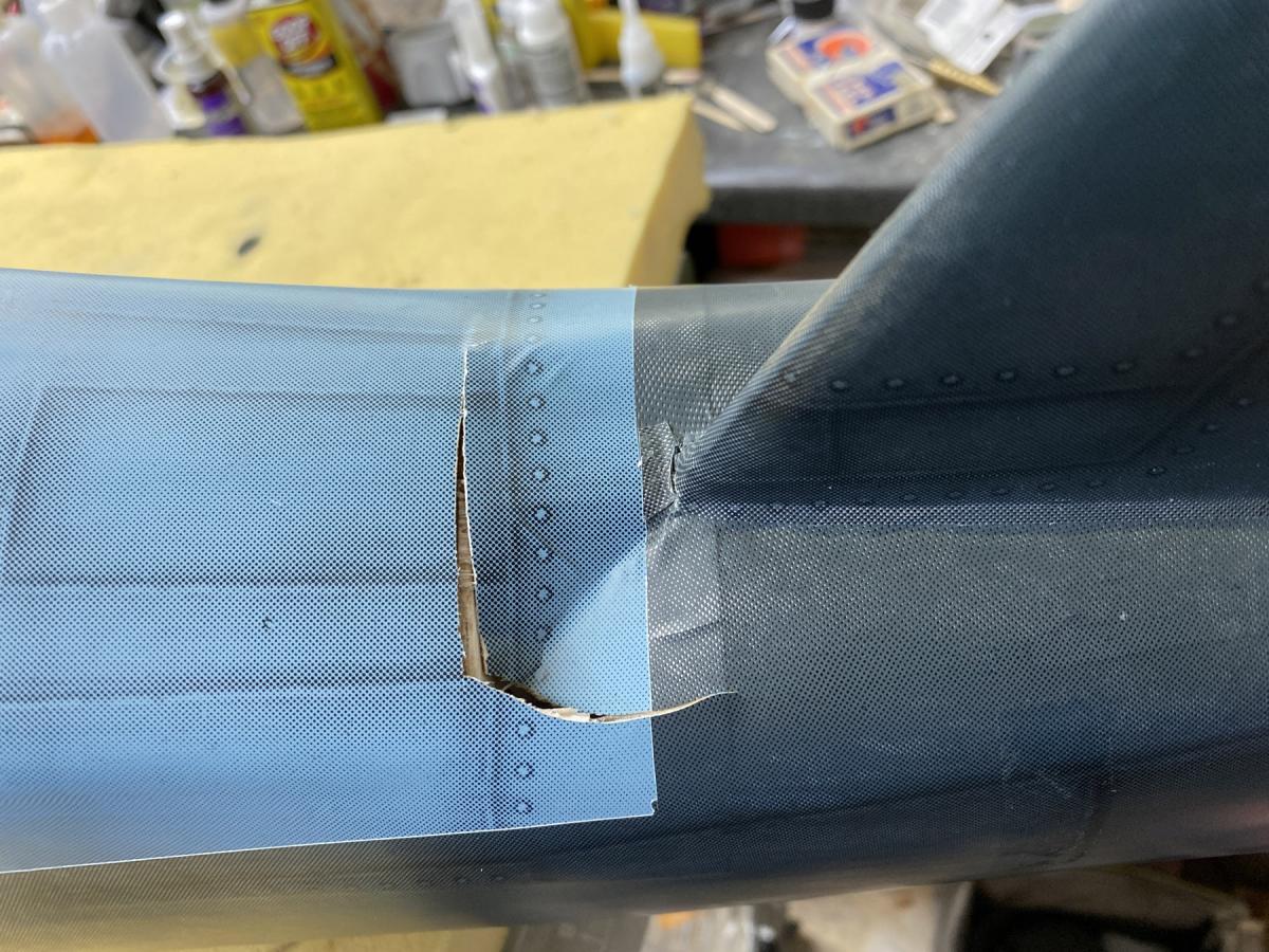

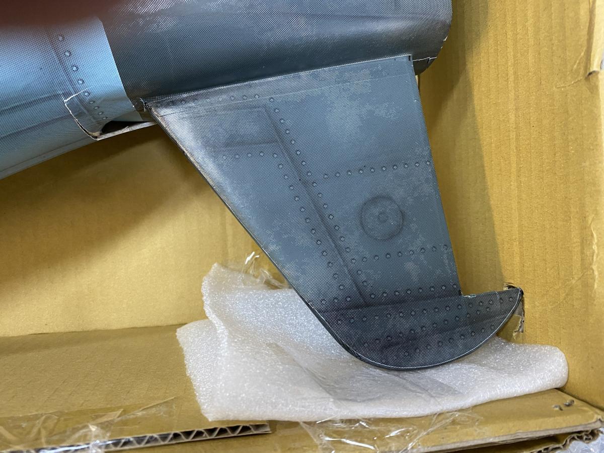

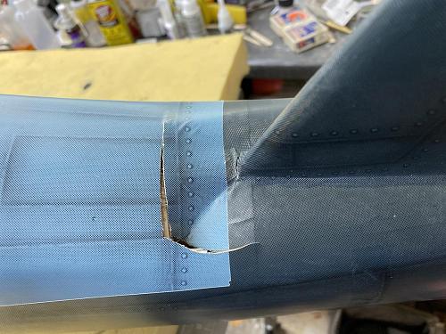

                              My Do335 arrived on Friday. I could barely drag the box from my front porch, through the house, through the carport, and into my shop. Um, and then what? I think the package size alone exceed my shop limitations.
                              I was happy with the double-boxing which appeared to have come through with only a few marks. However, I quickly discovered that my ventral fin had been smacked and crushed the lower fuselage at the leading edge. The tip of this fin was also fractured inside the covering. I saw somebody else had lower fin damage as well. The way they packaged this, such damage was inevitable. The tips of the two rudders go right up to the carton walls with just a bit of foam sheet. Any impact at all, and something's gotta give.
                              I put in a damage report to MRC, but I'm being careful about this. I do not want a replacement and will repair myself. I'm glad that MRC believed those of us on this forum who said a variation of "if you build it, they will come" -- or in our case, if you import it, we will buy it. I don't want to make them sorry that they did. But like all of you, I prefer to damage my planes myself!
                              To me, this should have been an easy fix on the design side -- make the ventral fin a separate piece, to be attached by the builder. I'd have made a ply tongue extend out of the lower fuselage to fit into a slot in the fin -- either glue or fix with two screws. Not to mention, the ventral fin is maybe the most likely part to be damaged flying, and this would have made a replacement part possible.
                              I was a little annoyed that the first layer of bubble wrap on the fuselage was attached with clear tape directly to the fuselage -- even carefully removed, it left a thick layer of adhesive on the covering. Typically I use isopropyl alcohol to remove adhesive, but this removes many paints as well. I did a test on the wing root and saw no effect on the covering, so that's what I used to remove the tape adhesive in three places.
                              My impressions: This thing is enormous. I still haven't had the guts to see if the fuselage will fit in my car (going over a fully reclined front passenger seat into the back seat. The wing panels won't be any problem.
                              I have mixed feelings about the "pre-weathered" finish. I can see where many will like it fine. I'd personally have liked to do that myself. If my flights are successful, I can see where, in the future, I might repaint this model.
                              The battery compartment is larger than I had been led to believe based on a few things I'd read. At this time, I'm thinking of a single, very large 6s lipo. I know a 6250 will fit, and maybe even a 7000.
                              I'm anxious to see how Oxo does with the two large motors -- I'm sure they will be enough power, if not too much. I've wondered about using a smaller motor on the tail -- can two dissimilar motors be run off of single lipo?

                                #115
                                Nick, bummer about the damage to your vertical stabilizers. I was a bit surprised with I popped the top on my 335 and saw that the stabs were supported better than they were. Luckily, my V Stabs weren't damaged in transit.

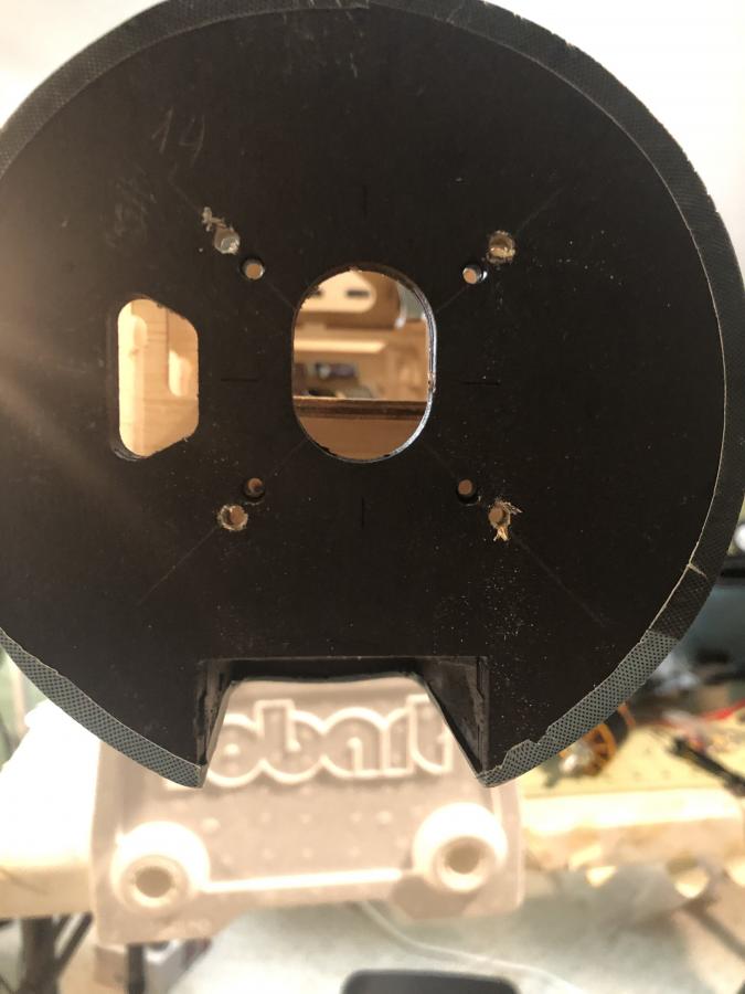

                                  I'm scratching my head a bit in regards to spinners. I've purchased a pair of 5055-390kv motors (FlightLine Spitfire) and MAS 16x10x3 tractor and pusher props. I'm having trouble finding suitable spinners though. I picked up a couple Dubro 3-blade spinners, but the blade slots are too small for the MAS 16x10 prop. I could pretty easily modify the slots a bit to fit the tractor prop, but it'd be pretty major surgery to make them work for the big pusher prop. Are there any good off-the-shelf options out there for 3" to 3 3/8" dia 3-blade spinners that'd fit MAS 16x10x3 pusher and puller props? Or will I have to special order them from TruTurn (which is a pretty pricey option). It just doesn't seem right to be spending more money on the spinners than I did for the motors. :-/

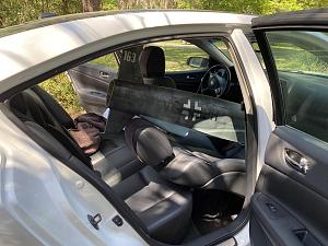

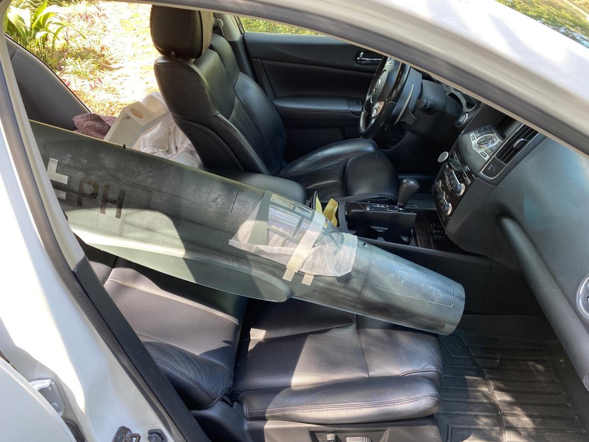

                                    I figured it was time to buck up and see if the fuselage fits in my car. Good news, it does. When loading, I took into account the eventual addition of the stab, cowl and props, and I think it will be just fine. Good thing there are two wing panels...

                                        #119
                                        MrSmoothie Very good suggestion to have the ventral fin replaceable. A simple tounge and groove with some ply and some blind nuts could do the trick.
                                        I chose to repair mine as well, although mine didn't have quite as much damage.
