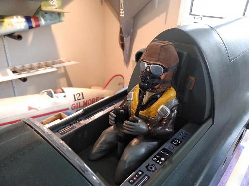

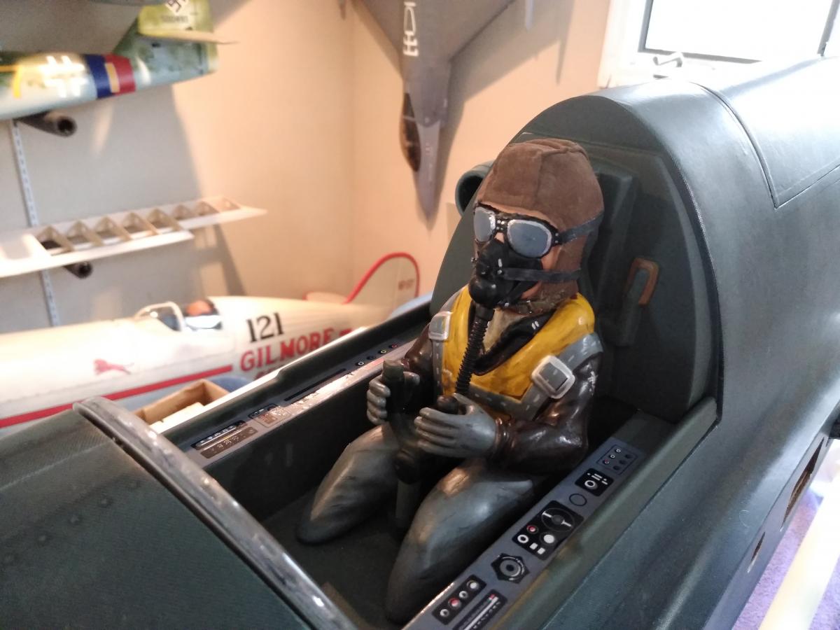

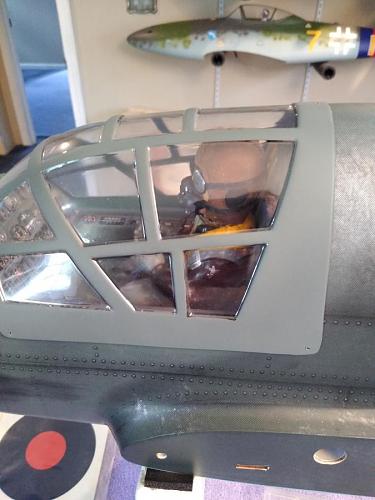

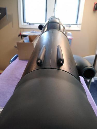

    • For a bit of a challenge, I decided to play around with the stock pilot to see if it could be made to be usable. The bulbous head was reduced, arms adjusted, some scale details and paint added. Not perfect but, I might just use it.

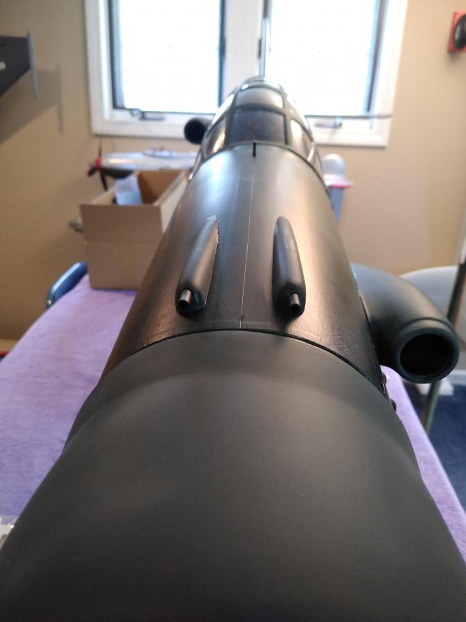

      Also wasn't a fan of the gun blisters on the glue on slab. So, they were cut out, filled with balsa and sanded. CF tubing barrels were added as well.
      Click image for larger version  Name:	335 pilot1.jpg Views:	0 Size:	97.7 KB ID:	252832Click image for larger version  Name:	335 pilot2.jpg Views:	0 Size:	68.6 KB ID:	252833Click image for larger version  Name:	335 guns.jpg Views:	0 Size:	42.2 KB ID:	252834

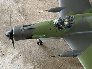

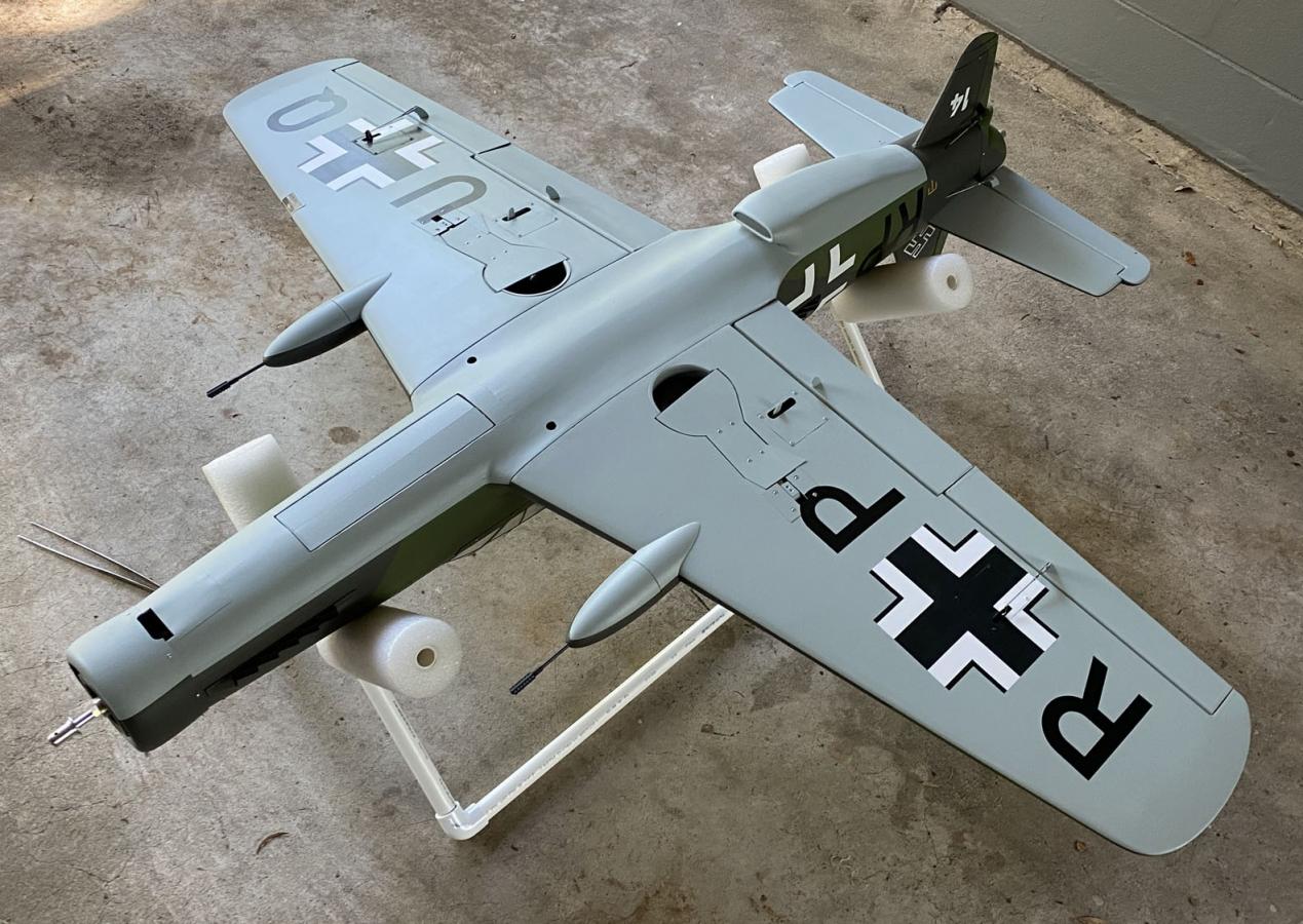

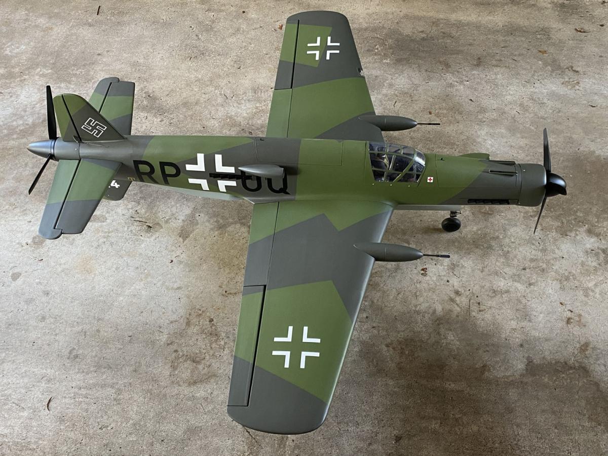

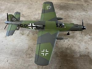

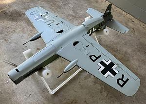

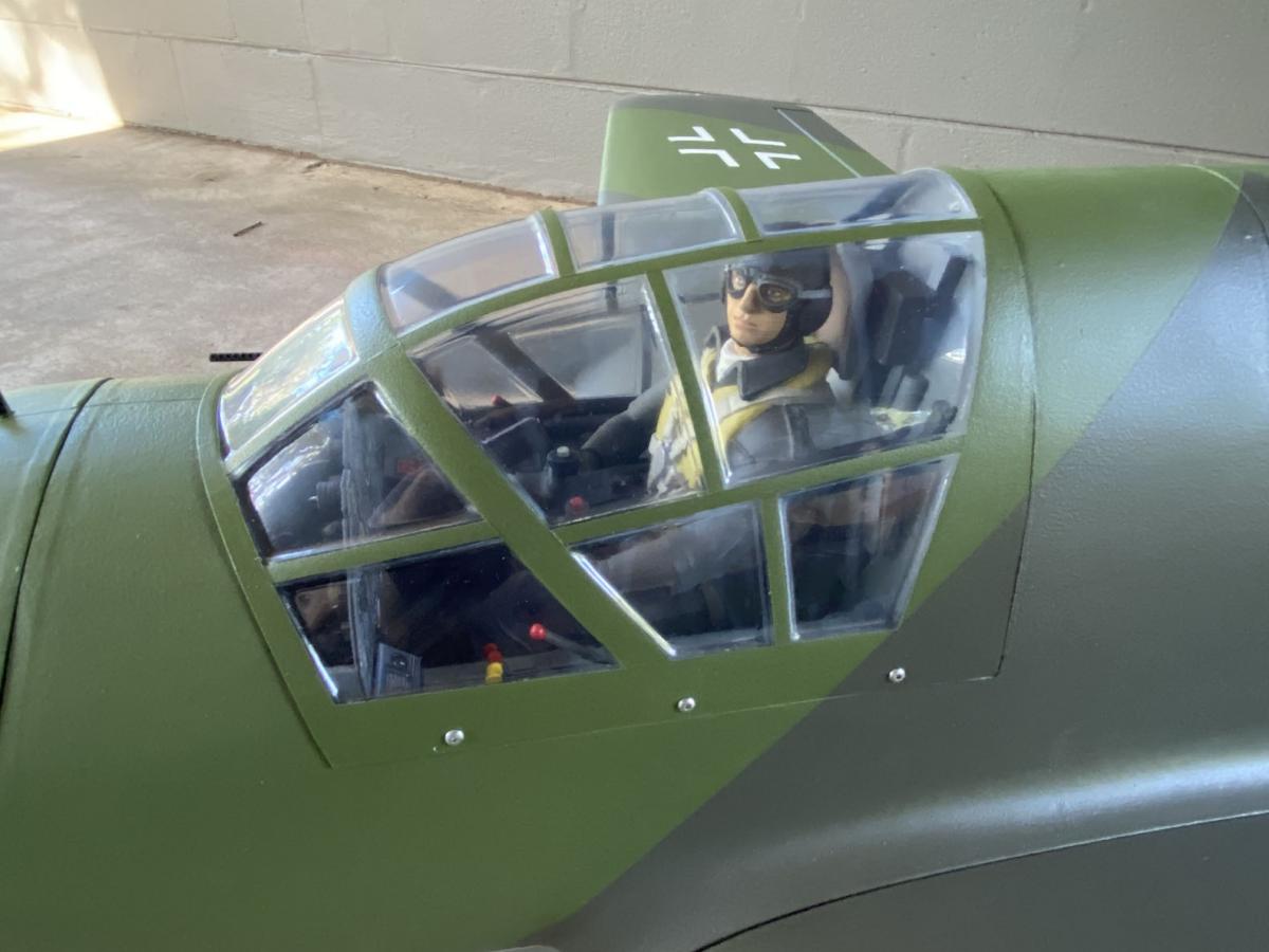

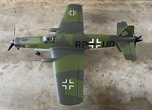

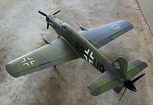

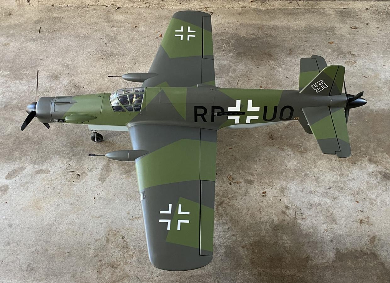

      • I've got my Do335 as far as I want to go before I maiden it -- looks like Friday morning has the weather I'm looking for and gives me a few more days to check a few functional things without rushing. Today was the first time I put everything together, although I did not tighten down (nor run) the props.
        If you want to see more details and pics, go to my build log last page: https://www.rcgroups.com/forums/show...1#post44426285

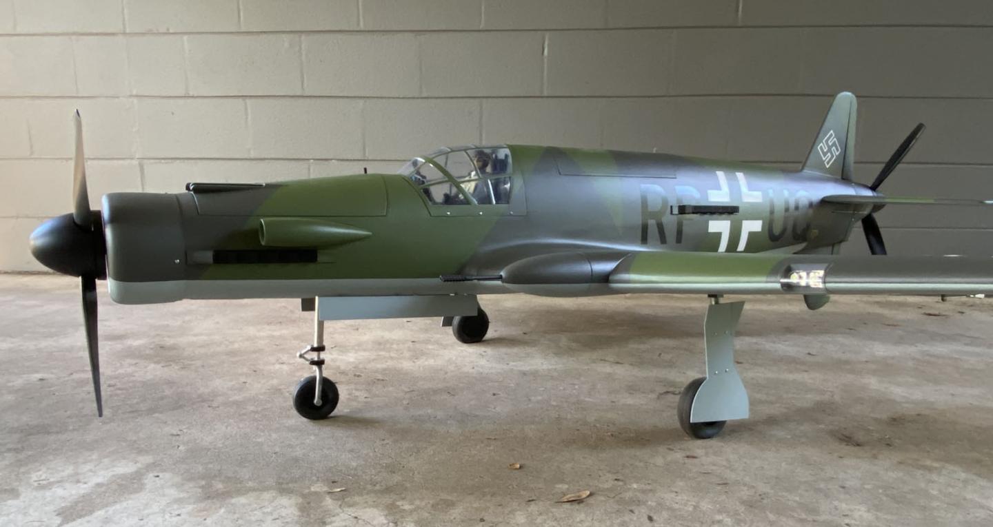

                    • I'm happy (OK, elated) to report that I flew my Pfiel twice this morning. The first takeoff was a near-disaster with the plane nosing up immediately and doing the "let's stall happy dance" -- not sure how I managed, but I got it under control long enough to get the half-flaps up and lots of down trim dialed in. Then I was able to fly fairly normal and have a surprisingly good landing.
                      My conclusions: off of Geotex, half-flaps not necessary. Too much up trim, too much elevator travel, not enough expo. Tail heavy.
                      Added 4.5 oz to the firewall, adjusted the elevator and flew again. Second flight was close to perfect from takeoff to landing. Did several rolls and one Immelmann. Concluded I had too much aileron travel and dialed that back later. Very impressive plane in flight.
                      Now I can go back to the shop and do a few more things I was waiting on until the maiden.
                      I flew with Roaring Top 6250 35c today, as far forward as I could go and still get the front of the hatch engaged. I'll be looking at possible options for a somewhat larger lipo that could position further aft in the compartment, and allow me to remove the weights -- might as well have more mAh.
                      My big takeaway today was that my biggest fear -- that of landing -- was unwarranted. With half flaps it was very easy to land, even on the first flight with everything out of whack. I posted details and a rough low-res video on my RCG build thread while I wait for the high res video segments to be uploaded to me for editing. You can see just how close I came to a total catastrophe on a model that was "this close" to being "just right."

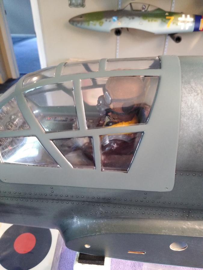

                                      What kind of paint was used for the canopy frame? I had a helluva time removing it, as it did not react to the usual assortment of solvents. In the end, I had to use Strypeeze which is pretty heavy duty, which dulled the clear plastic a little. Usually isopropyl alcohol takes the paint off of canopies, but that didn't touch it, nor did acetone. I don't think I had any lacquer thinner to try, but now I'm wondering about that.
