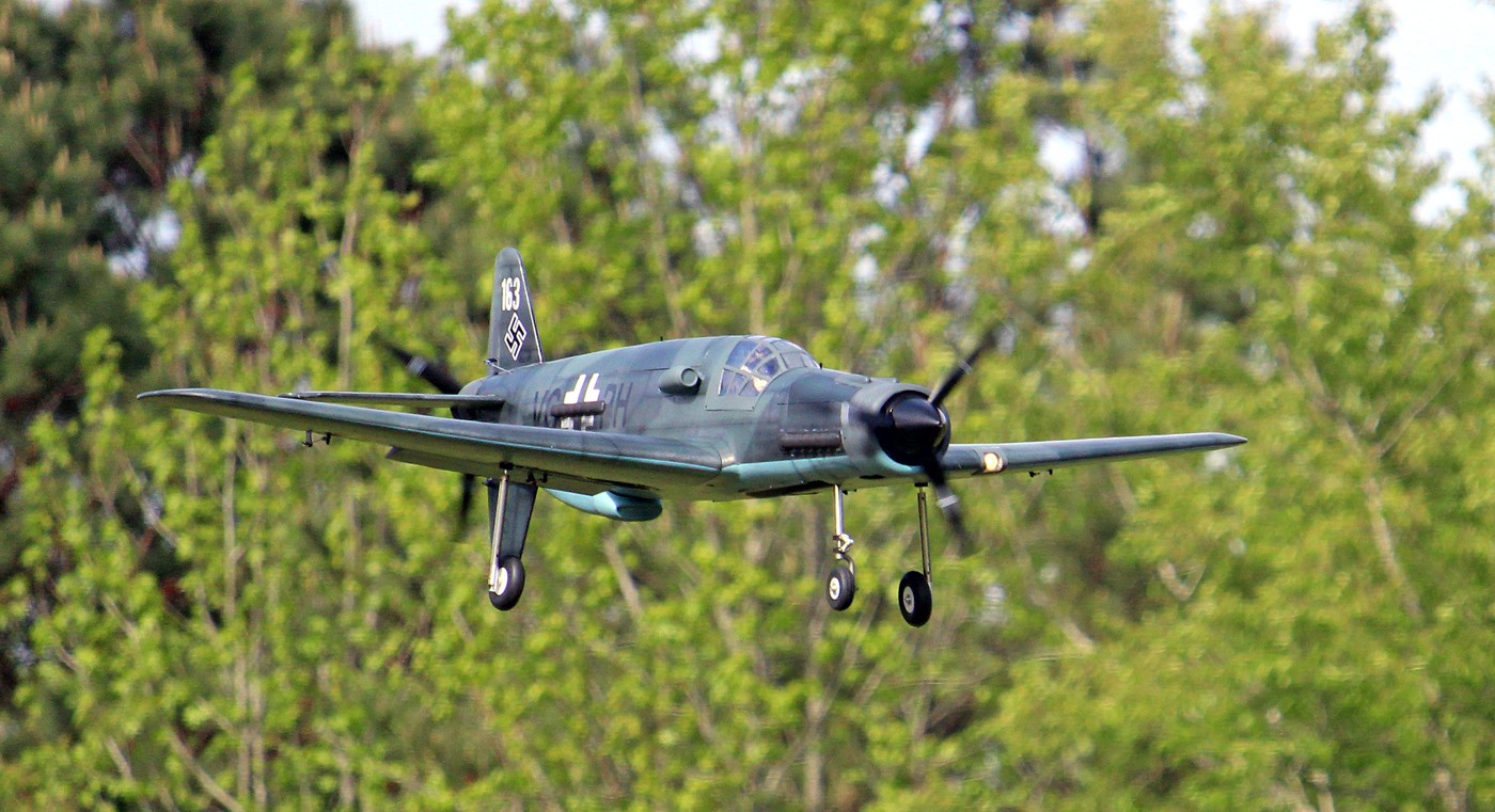

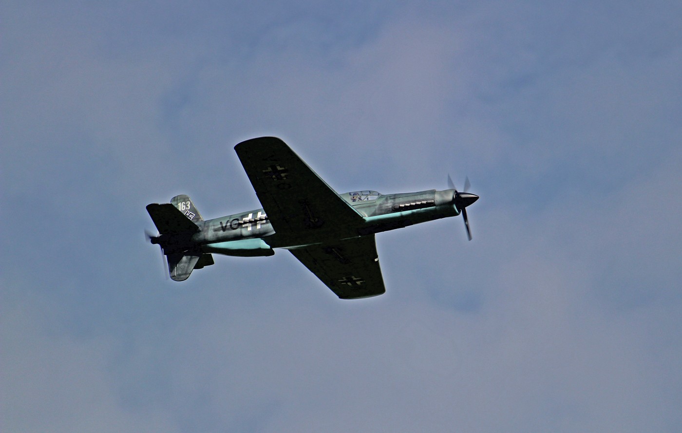

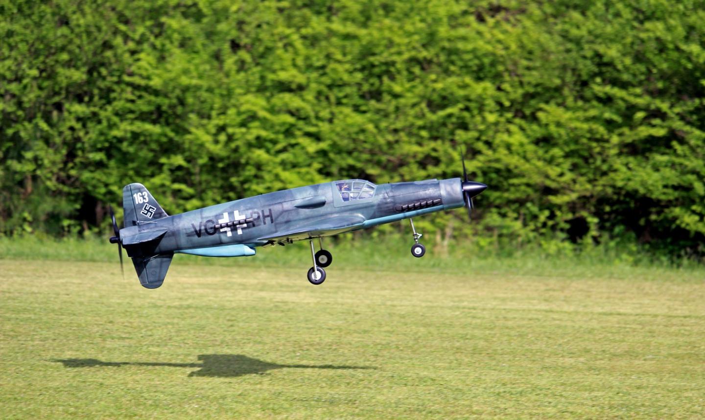

        Maiden Flight Report
        I successfully maidened my Do-335 today. Upon arriving at the field, I carefully checked the alignment of the ailerons, elevators, rudders, and flaps. Did a thorough range check with the engines at full throttle, with no problems. Did a taxi test to get the nose-wheel steering trimmed. One of the Main Struts rotated in the trunion. Several grub screws were loose on the Mains and were vigorously retightened. After tightening the screws, the 335 taxxied just fine (and later took off and landed just fine, too). I know that I’ve described my setup in other posts (and some of it multiple times), but for the completeness of a maidened flight repot, I’ll describe my setup again.
        Radio: JumperT16
        Receiver: FrSky X8R (two), running on 8.4v from a 2S LiPo receiver battery.
        Motor (tractor and pusher): Freewing 5055-390Kv (Flightline Spitfire), with prop adapter from Flightline 1.6m Corsair)
        Prop: MAS 16x10x3 (tractor and pusher)
        ESC: Hobywing 60A ESC, BEC power disconnected
        Battery: 6S. Two CNHL 3S-8AH-30C batteries wired in series.
        Flight Weight: 15.6 lbs
        Wing Loading: 37.8 oz/Ft^2
        Wing Cube Loading: 14.7
        Power: 2690 Watts
        Power/Weight: 172.4 Watts/lb
        Weather: 70°F, winds 5 – 10 mph, clear skies and sunshine.
        Although I didn’t put a wattmeter on the motors at the field, I had done that at home and the motors, each pulled around 55 Amps and 1340 Watts. When I did the first power-on range test, the 335 moved the stand, to the amazement of those watching. The guys all really impressed with the output of the inline 5055 motor and 16x10 props.
        Take off was incredibly easy. I’d previously done taxi tests and had the nose-wheel steering trimmed in nicely. The takeoff roll and climbout was straight as an arrow. The climb out was much steeper than I would’ve liked, but she had a lot of up trim, that I had trim back out.
        Flying was easy, too. She was very predictable and flew like she was on rails. I was not aggressive with her on this first flight (didn’t even roll or Immelmann), but I could tell that she’d easily be up that. The only surprise that I experienced during the entire flight was when I decided to do a WOT pass down the runway. I can in on shallow dive as I brought throttle to full. Almost instantly, the 335 started wagging her tail like a fish. I eased back on the throttle and she resumed easy predictable flight again. (more on this in my final thoughts and recommendations)
        Landing was very predictable, as well. I came in a bit high and fast, as often when landing from the North on this field, due to the trees lining both sides of the runway. I’d misjudged the throttle input a bit as I was turning onto final. She was high and fast; so, I chopped throttle and came in on a rather steep approach and brought power back up as I neared the ground. I was a little doing that, though, and the 335 plopped down a bit harder than I would’ve liked. I’d actually half expected her to bounce. Because she didn’t tells me that the suspension in the gear is well engineered. I flew for almost 5 minutes. After the flight my 6S-8AH battery had about 75% of the capacity left (about 3.85 v/cell).
        Final Thoughts and Recommendations:
        If you’re planning to run a power train as aggressive as the 6S, 5055-390kv, MAS 16x10x3, be careful at high speed. After the flight, I checked the elevator and rudder pushrods and discovered that by manually pushing on the rudder and elevator that the stock pushrods will flex inside the fuselage. I’m suspecting that the heavy propwash was causing the elevator and/or elevator to flutter.
        Recommendation: Stiffen the rudder and elevator pushrods. Either add addition supports within the fuselage or replace the pushrods with 4-40 pushrods.
        My Do-335 flew better than expected. Even though it was a maiden flight and I more tense than usual, I still enjoyed the flight. She was very well behaved during takeoff, flight, and landing. If the Do-335s aerosurfaces are visually trimmed, there should be no surprises during the takeoff and climbout.
        She’s a real keeper. I can’t wait to fly her again, now the maiden-flight pressure is off!!!

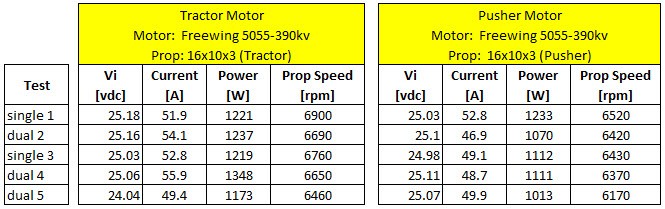

                                        Okay, sports fans, I have some more motor test data. I went to the field today with my 335, radio, a few 6S batteries, a couple wattmeters, and a tachometer. I ran five tests, each test lasting about 10 seconds. Single means that each motor was run alone. So, for Test Single1, the tractor or pusher motor was run individually, using the same battery, at close to the same starting voltage. Dual means that both motors were run concurrently, using the same battery, but separate wattmeters. For the Dual Tests, I could only tach one prop at a time; so, the Pusher Motor Dual Tach Reading was taken during a follow-on test (so the initial voltage, current, and power would've been a bit lower).
                                        Wattmeter and Tachometer Tests
                                        I'd wanted to run this test because I'd observed severe fish-tailing during the maiden flight, when I'd throttle up to WOT for a high-speed pass. I was wondering if, maybe, the flow fields from the tandem motors/props running at high speed were interacting with each other, possibly causing one of the motors to over spin. There was quite a bit of variability in the power and tach data. My take-away from this data is that each motor seems to drop about 100 watts when run in the tandem system, as opposed to running alone, and the prop speed seemed to drop about 100 rpm when running in the tandem system. This makes sense, since two motors are now pulling juice from that same battery at the same time; therefore, there'll be more voltage slump, which will lower the power and rpm. Test Dual4 seemed to be an abnormal test, as the current and power of the Tractor Motor seemed abnormally high. I ran Test Dual5 as a replacement test, and the data seemed more believable. Conclusion: I don't believe that there's significant interactions in the flow fields that caused my 335 to fish-tail at high throttle during the maiden.
                                        Following my maiden flight, I did observe that by moving the rudder and elevator with my hand, the respective pushrod would bow. So, I replaced the stock pushrods with 4-40 pushrods. When I ran the Dual Tests, I did observe that rudders (both dorsal and ventral) angling a few degrees to the left. I believe that this is a P Factor effect, since the pusher prop is only an inch or two behind the rudders. The elevator did not move though. In flight, this may cause a slight left yaw at high throttle. I suspect that with the stock 2mm pushrods that both the split rudder and split elevator deflected significantly at high throttle, and that caused the observed fishtailing in flight. I'm okay with going back into flight, and high-throttle flight, too, with the stronger push rods. I'd encourage you all to check your rudder and elevator pushrods very carefully for stiffness, especially if you're planning to run as powerful a 6S motor system as I'm running.
                                        Another observation from this test data is that the power trains are not putting out as much power as I'd originally posted that they would. I'd run two tests, a month or so ago, and observed 1345W/motor, for 2690W total. This test data indicates that the total power is more along the lines of 2400W. For my 16.5 lb Do-335, that'll give me a powers/weight ratio of 145.5 W/lb. Still very respectable for scale warbird. :-)

                                          #260
                                          Oxotnik Oooohhhhhhhhhh, I luv tech data, thanx Chuck
                                          I got to use some of my early years engineering skills in reviewing your PPP ( Pfeil Power Paper)
                                          So it was hard to pour through the data and remain un-biased as I read your analysis at the same time of digesting the data but I think I was able to let the science prevail.
                                          The long n short of it is I totally concur with you analysis that the WOT fishtailing was indicative of the control surface rod flexing than to an imbalance in thrust factors.
                                          The only observation that I would make concerning your test set up is regarding the watt meters.
                                          The slight variations between the tractor/pusher motors I would suggest are because you are using industry hobby meters that are:
                                          1) of average standards and 2) not been calibrated to each other.
                                          Lab power measurements that I did back in the day were with very expensive meters that got periodically calibrated.
                                          Because of this I didn't even bat an eyebrow about the "dual 4" measurement and thought of it as just being a meter anomaly.
                                          And lastly, I expected what you saw in the final paragraph because you are using a single power source versus a dedicated battery to each motor.
                                          With separate dedicated power sources the additive sum of each motors power reading is going to be higher because the voltage slump as you mentioned
                                          earlier is due to the motors running in tandem because of the single power source versus running in two singular modes with dedicated power supplies.
                                          But as we both know all too well, separated power sources on twins is asking for trouble :astonished:
                                          Great stuff and at 150W/lb that Arrow is definitely in the fighter class. :clap:
