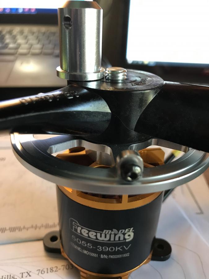

                      • Received my spinners, reamed out the prop to fit the FreeWing Prop shaft adapter. It has about three threads exposed to make contact. It will tighten down....but I am not confident with this. Contemplating counter sinking into the MAS prop hub to allow the prop nut to get a couple more threads for insurance. I am now looking for a huge bit that will do the job.....maybe use a wood bit to dig into the prop hub material?

                          • Contemplating counter sinking into the MAS prop hub to allow the prop nut to get a couple more threads for insurance.

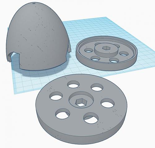

                            I'm no expert (but I know some, haha). But I think your problem goes beyond getting "a couple more threads". Unless I'm not seeing things correctly, your aluminum spinner base plate is sitting on top of the round portion of the motor shaft base (you've enlarged the hole in the spinner base to fit over the hex portion, if I understand correctly). You may have the more square shaped base (rounded corners), but same issue.
                            This doesn't seem to be enough surface area for the spinner to contact to remain tight, without having the hex shape to engage any more. When I designed my 3D spinners to work with that motor shaft, they took into account the hex as well as the round base portion. These spinners are still working fine, knock on wood -- er, PLA.
                            I guess you won't know until you try it -- might be worth setting up on a test stand first?

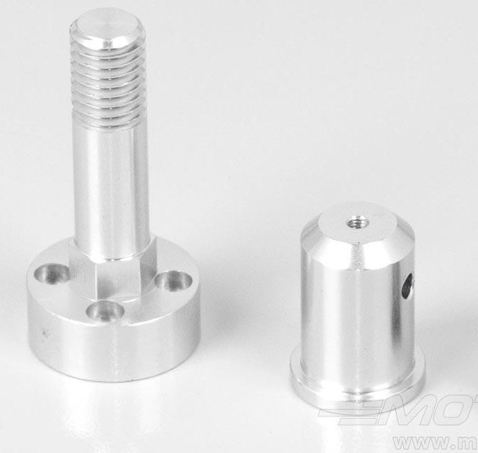

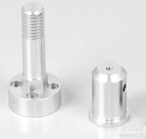

                            • Mr. Smoothie - You are on target....I have NOT drilled my props yet. My spinner back plate fits perfectly flat onto the original FlightLine propshaft adapter. However I am second guessing my strategies:
                              A. Use the original FlightLine motor propshaft adapter (I have four of them at the ready)
                              1. Score or groove the prop shaft adapter face to provide positive surface friction with the spinner back plate surface
                              2. Drill and pin the spinner back plate to the prop shaft adapter
                              3. Counter sink the propeller hub to expose more thread for the prop-nut
                              i. Mill down the propshaft adapter face to allow more threads exposed
                              2. Use the FlightLine 1600mm Corsair propshaft adapter (I have two of them at the ready)
                              A. Use your 3D Print files on somebody's machine
                              B. Ream the prop for larger prop shaft diameter
                              If I choose option 2 I need to know and order the correct material for someone's 3D printer and get your files.....and settings for all of it. There are several pilots I know of in Fort Worth Tx who have 3D printers....but I don't understand enough about them to know what questions to ask......I am assuming there are settings, granularity, heat, speed, size capabilities variables to deal with?
                              TwistedGrin

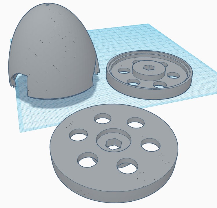

                              • I uploaded a zip file containing all of the 3D files I created for my Dornier on my RCG built log -- on one of the later pages somewhere:
                                • 10:4 Thank you MrSmoothie.....I over looked the post somehow.....thanks for sharing your excellence sir!
