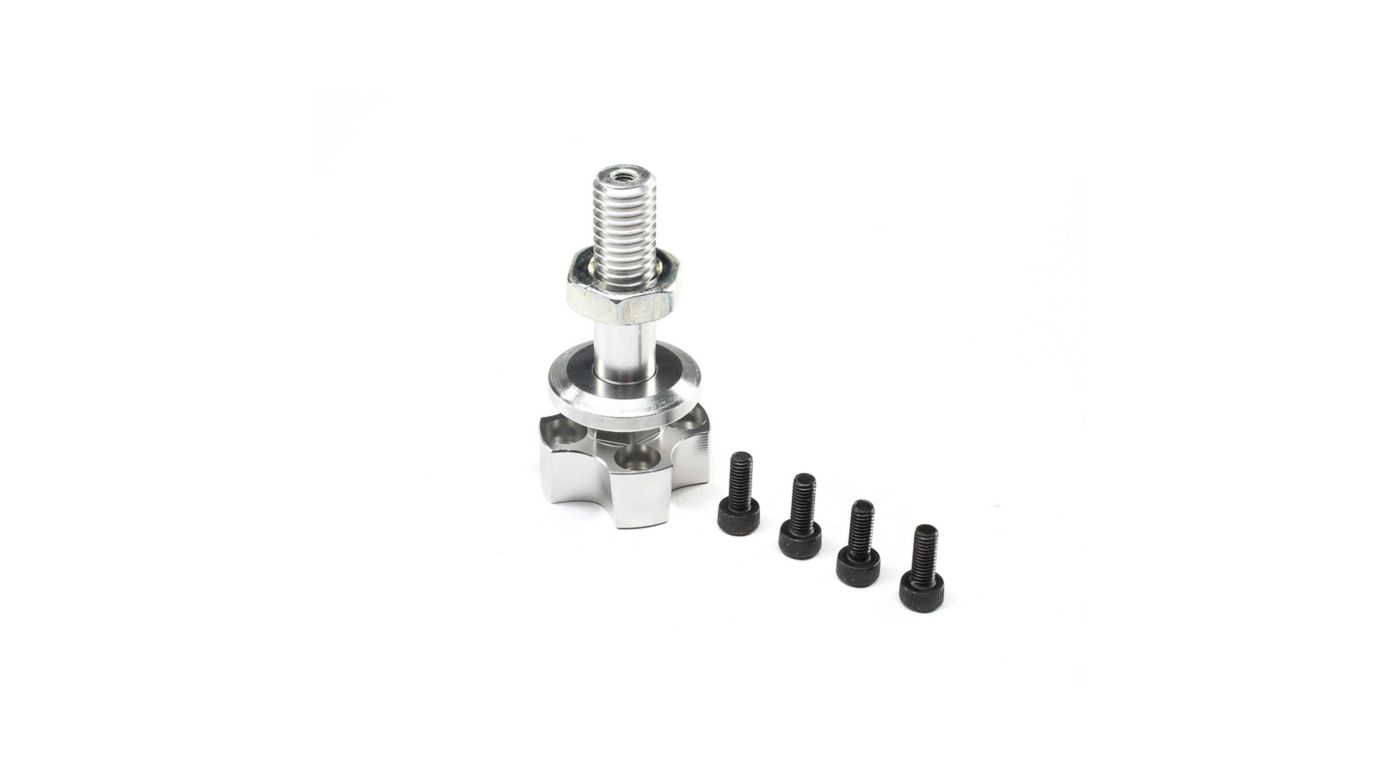

        Yeah, I was thinking that I may need to find a local machine shop and have them cut me two adapters with the same 3mm hole pattern and a longer 8mmx1.25mm prop shaft.
        [edit] Found a solution!!! The prop adapter for the FlightLine Corsair's 5055-320 motor fits on the the Spitty's 5055-390 motor. This adapter a thicker prop shaft (it looks like 10mm to me, versus the Spitty's 5055' 8mm shaft), but it is significantly longer, too. I'll have to drill out the TruTurn backplate to 11mm or 12mm (to go over the hex 'nut' at the aft end of the prop shart) and ream out the MAS 16" prop to 10mm, but it'll work. Now, to order a couple F4U prop adapters from Motion. I like simple solutions. LOL

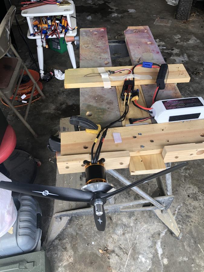

                      Okay, I've got some bench test numbers for the Spitty 5055-390kv motor and MAS 16x10x3 prop.
                      Configuration:
                      Motor: Freewing 5055-390kv
                      Prop: MAS 16x10x3 prop (tractor)
                      ESC: Hobbywing Skywalker 80A
                      Battery: CNHL 6S-5AH, 70C, full charge
                      Results (about 10 seconds at WOT):
                      Current: 56.6 Amps
                      Power: 1345 Watts
                      Power/mass (assuming that the AUW is 13.5 lbs, and that the same config is run for both the tractor and pusher power trains) = 2*(1345W)/(13.5 lb) = 199.3 Watts/lb
                      I was a bit surprised at lowish value of the current draw, but at 199 Watts/lb, this dual power train should work well for the 335, but it won't be a speed demon. For those considering a Power 60 class electric motor and 16x10x3 prop, I'd encourage to maybe look for a motor with a bit higher kv. I believe that the recommended Admiral 5045 (IIRC) motor has a higher kv. Having not already invested in these Spitty 5055=390s, I might have gone with the higher Kv Admirals.
                      But, on the up side, the underperformance (in regard to power draw) probably means longer flight times....

                        #151
                        The recommended Admiral 5030-400kV is only 10kV more than the Spitty motor but here is where the real point that you're missing is Chuck.
                        The Admiral has only a 1180W rating. The Spitty spanked that by 200 watts and didn't even come close to its max of 1950W.
                        The spec on the 5055-390kV Spitty motor product page for max wattage still hasn't been corrected .........reads 950W(confirmed to be incorrect 2 years ago by Alpha)
                        So the watts that you tested out is approx. the same as I got almost 2 years ago when I tested for the A-26.
                        Now then……….. you are getting power that is on the verge of 3D power for $30 per motor less expensive...………. I say that is a :first_place:win

                            #153
                            Chuck, speaking of good calls, that Eflite prop adapter find is awesome.
                            I just printed this page to put with my reference tech data for future use.
                            Why hog out a spinner back plate for a hex shaft if ya don't have to
                            edit ………. just looked at the pic of that EF prop shaft.
                            I assumed that it had a smooth shaft but not so.
                            But is still a good scavenge.
                            Here's a direct HH link to the EFL11595
                              #154
                              Here's what the FL Corsair prop adapter looks like for those that want a visual comparison.
                              ps………..the EF is $4.99 and the FL is $6.99 :astonished:

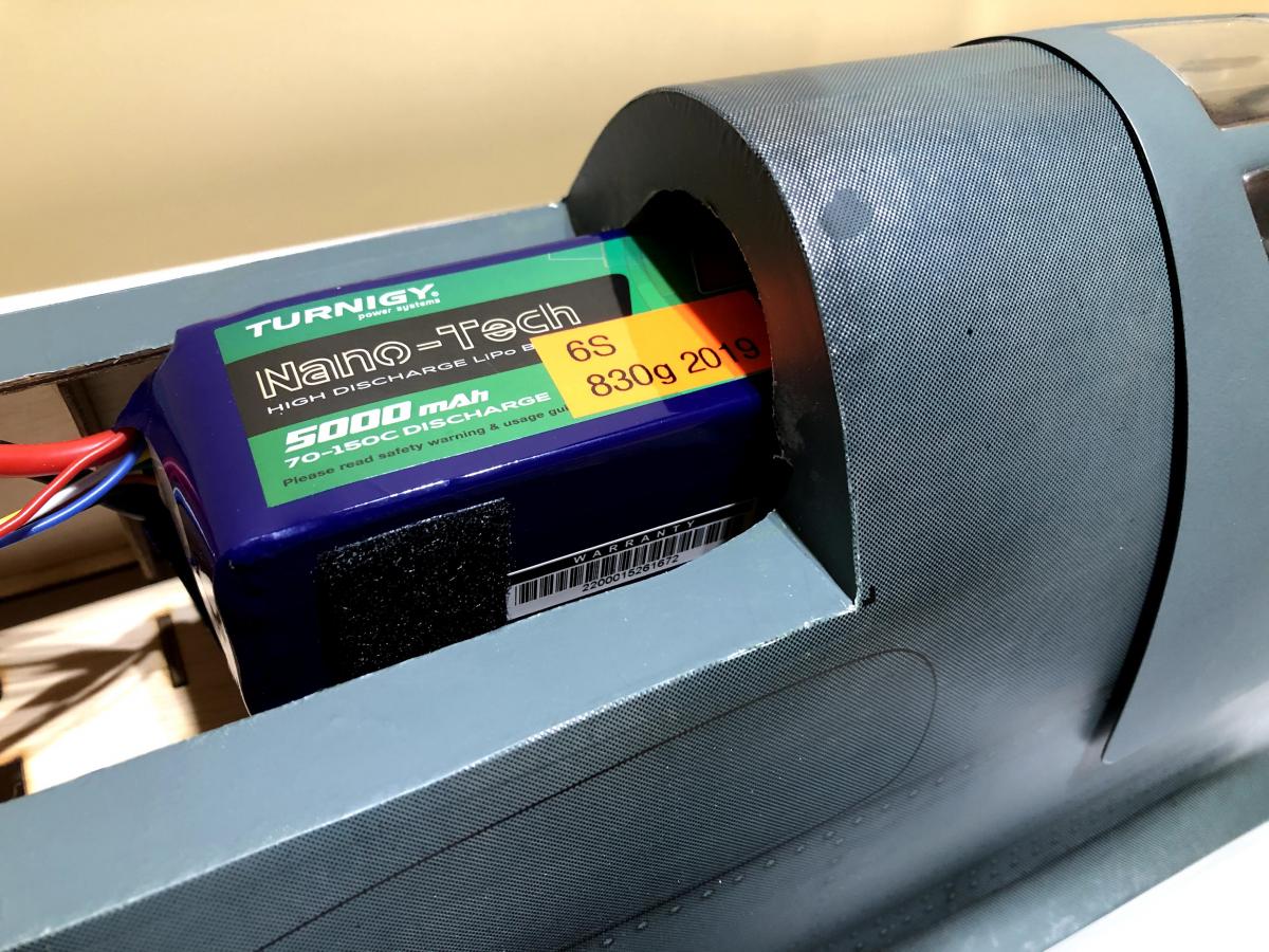

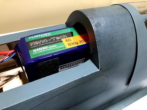

                                #155
                                I get 2x 6S 5000 in without difficulties. The aft one sits on the upper deck which might need some reinforcement, but it will fit and it is right over the CG.

                                  #156
                                  downwind3zero That looks like a good solution! Helps keep the ESC wires to the rear a little shorter too.

                                    #157
                                    I'd thought about that as well, but decided against it because that weight would be behind the CG. How does yours balance? Did you have to add any nosewheight? What kind of platform did you build to support the battery?

                                      #158
                                      Oxotnik I don't know for sure how it will play out but the battery in that position is almost CG neutral. The CG projects to the front edge of the hatch and the battery is almost centered. I have only trialed the fit not balanced yet, but I plan on using a Tru-Turn in the front which will add some weight. We'll see.
