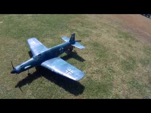

                    Here's a Old video of my Do335 before I sold it
                    That's running a 14x7 apc on the front and a 14x8.5 apc prop on the rear. takeoff is using half flap Landing's with full flap need to be nice and flat. ...

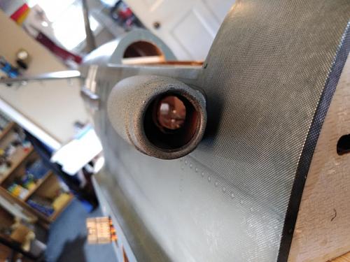

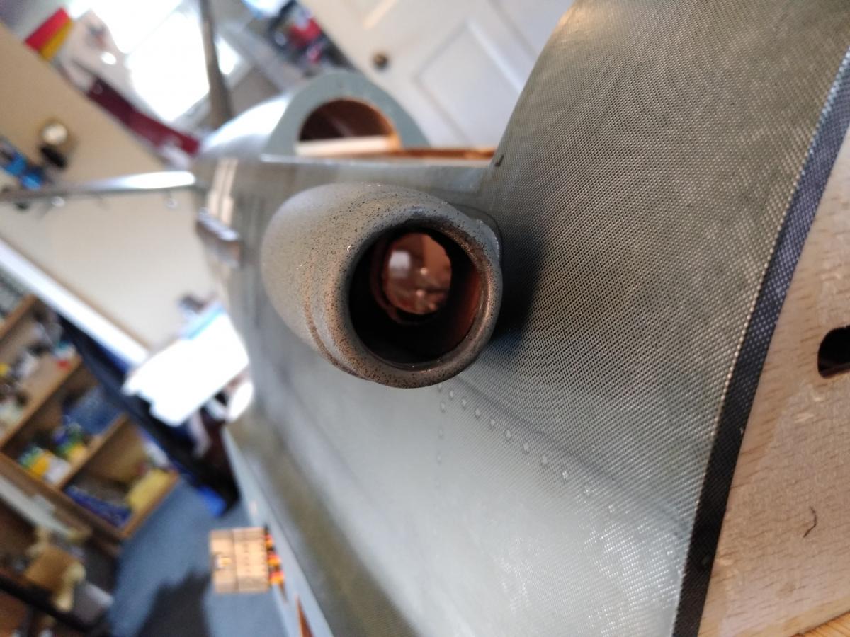

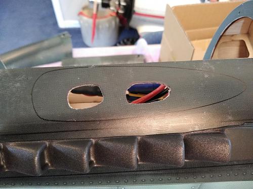

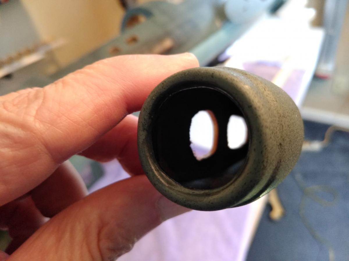

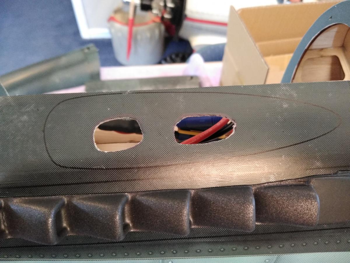

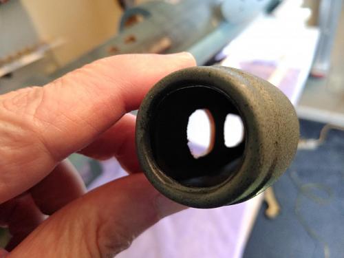

                        I wound up doing something simular to what Nick did over on RCG, with the air scoops. The goal was two fold. One was to eliminate the flanges around the parts and two, to get additional air over the battery, ESCs and more to the rear motor.
                        I made 1/4 " inserts for the scoops. Cut openings in both the insert and matching in the fuse. Then used the same technique to sand to fit the fuse shape. I went further on the sanding however. I went until the outside flanges came free.
                        I also opened up the ventral scoop. To prevent debris from entering, I glued a piece of screen between the mount and scoop when installing. That way I can check and clean the screen if needed.

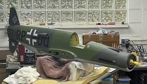

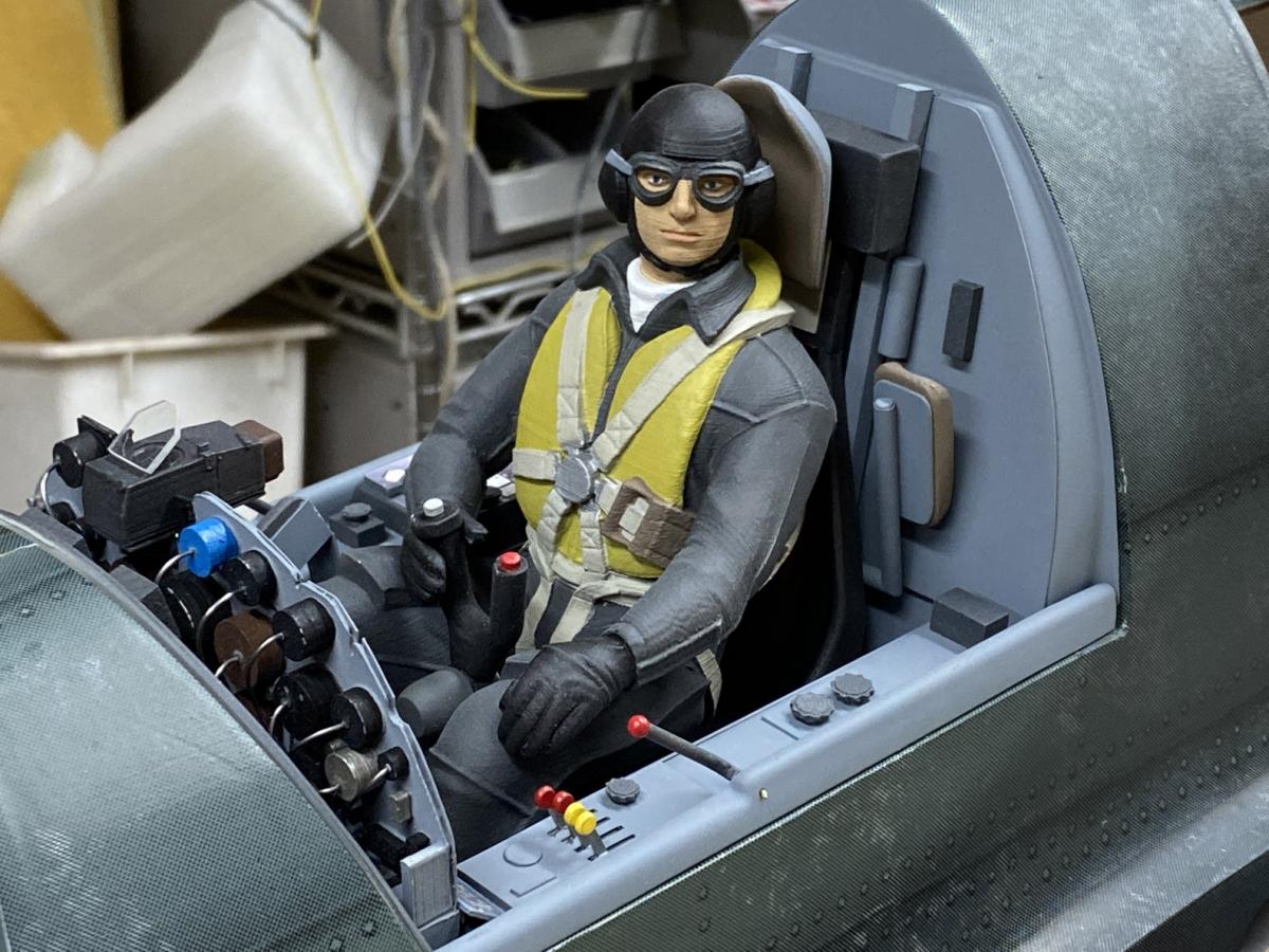

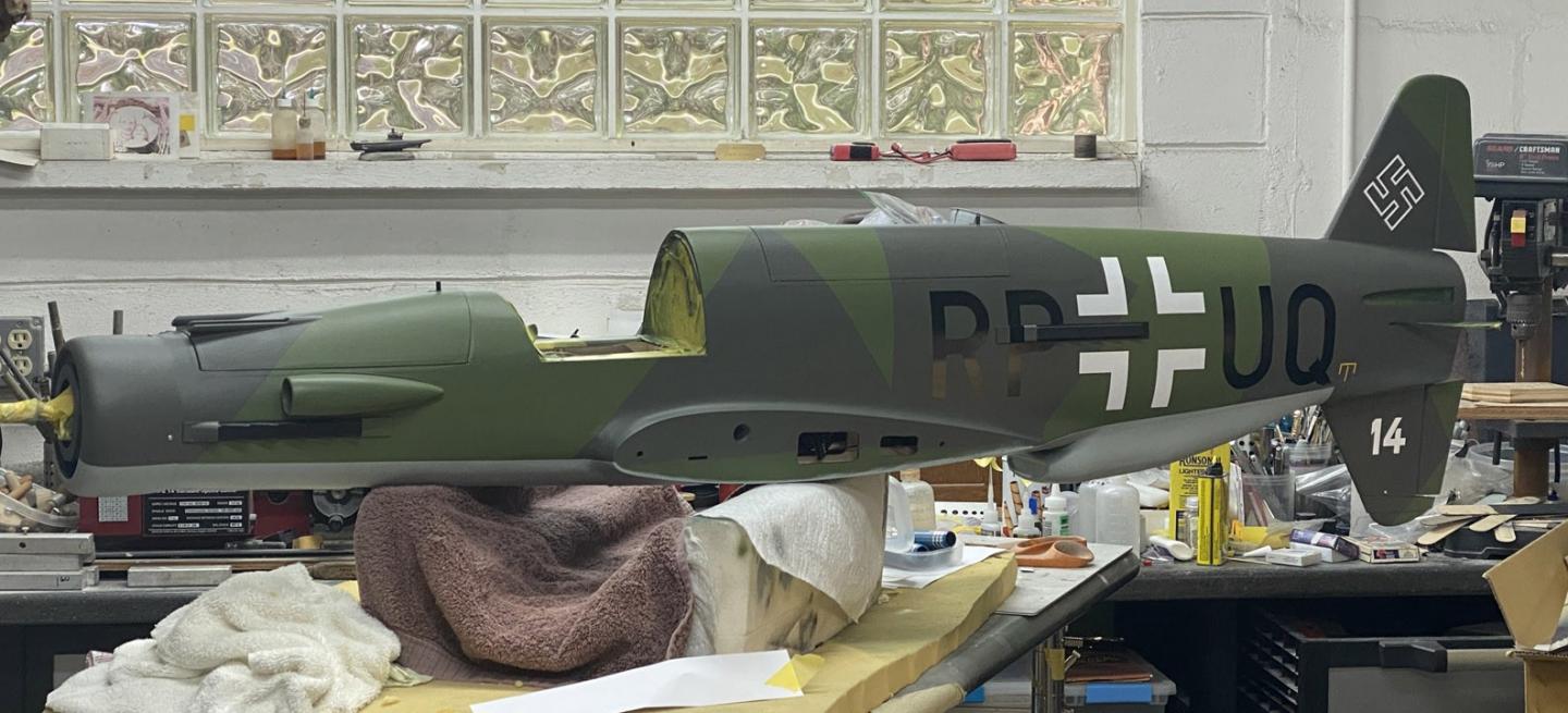

                          Thanks Oxotnik!

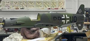

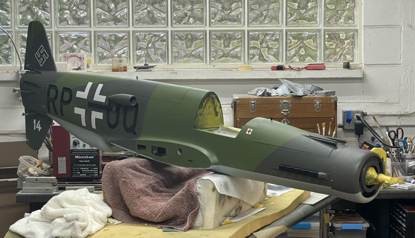

                          Finally starting to look like something! Still, a lot of things left to do. But it felt good to get some of the repainting finished. My scheme is Zestorer prototype M14 (RP+UQ), which had oversized markings on the fuselage and wing undersides.

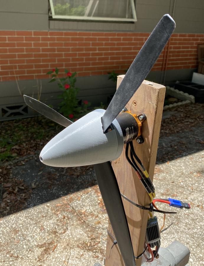

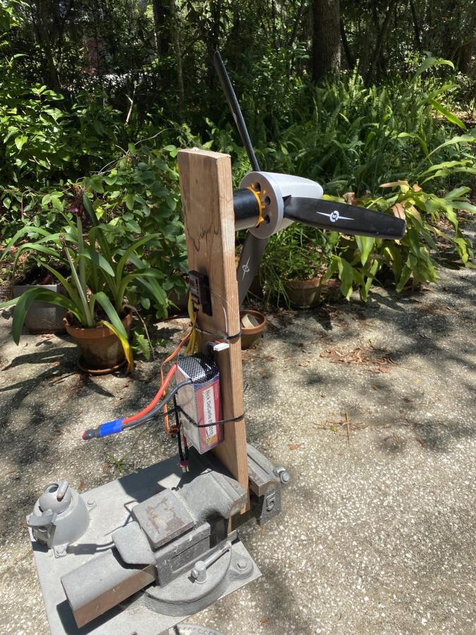

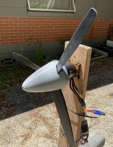

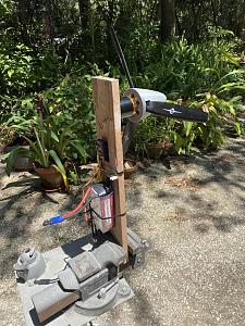

                                  I set up and ran a static test of the longer rear spinner today. I think once I figure out a way to set the spinner/prop assembly up to balance, this will work.
                                  The test board was held in a sturdy vise stand, and as I slowly applied throttle, I cold see the spinner tip go "out" and back "in" at various points during the run-up. I may or may not have reached full throttle, and if I did, I didn't hold it long at all. I tried the lower range again with the same results, and figured "this isn't going to work."
                                  Then I thought, let's see what happens if I put the spinner back on the base rotated 120 degrees. Surprisingly this worked pretty well, with no obvious issues, including full throttle, which I left on for a bit. I marked the relative position of the spinner to back plate, and then tried a further 120 degree rotation with similar results to the first attempt.
                                  My conclusion is that the 3D spinner will work but it obviously has to be corrected for balance.
                                  I know I can reprint the back plate with thinner walls and less infill -- I already did a front backplate this way. I also think the spinner could be printed a little lighter. By doing this, I figure there's less mass to be imbalanced, especially as you get out towards the tip of the spinner.
                                  Clearly, balancing the spinner/prop assembly is the thing to do, but easier said than done, given the way it's made and held together. I'm thinking I need to make a 10 mm shaft "replacement" that is designed to work with my prop balancing device. I'll need to think this one through a little -- it'll be worth it to have the better outline spinners -- not to mention the hours I've put into this one aspect of the model!
                                  Footnote: I used a 4500 mAh for the test and ran it down to about 55%. This was on/off, and mix of throttles, but nothing longer than a minute or two. The motor was warm when I concluded -- with the pusher prop, no air flow over the motor, and no forward motion either. Made me thing I need to do a couple more things to put a little additional air through the rear cowling.

                                    Nick, you might consider doing what Downwind did: Print the spinner to be mounded on the spitfire backplate.
                                    Warbirder
                                      Interesting idea for plan B -- but at this moment I don't think the back plate is the problem. I failed to mention that I did a test run with just the backplate only and it ran just fine at all speeds. My guess is that the cone portion is to blame -- that it's long means anything out of line or balance as you move away from the prop makes the problem worse.
                                      I really do think that I "over-printed" these parts, which seems to be a common error with those relatively new to 3D printing -- eventually one learns that you can get away with thinner walls and much less infill and still have a part stronger than the injection molded spinner cone that comes with the mode.
                                      But I will definitely keep this idea in mind... And save the 8mm Spitfire shafts...

                                        It looks great though! Hopefully you can get this sorted out because it looks 100 times better than the stock plastic clown nose! Regarding cooling, I wonder if you could put a louvered piece on the bottom aft of the ship to help with airflow?
