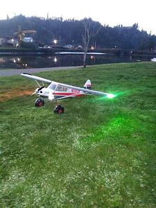

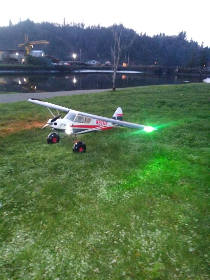

              Thanks I bought one rite away, got it a few days ago and refitted that APC 15x6 for the Bison. Perfectly balanced, smooth and a lot more power ! Awesome!! Click image for larger version

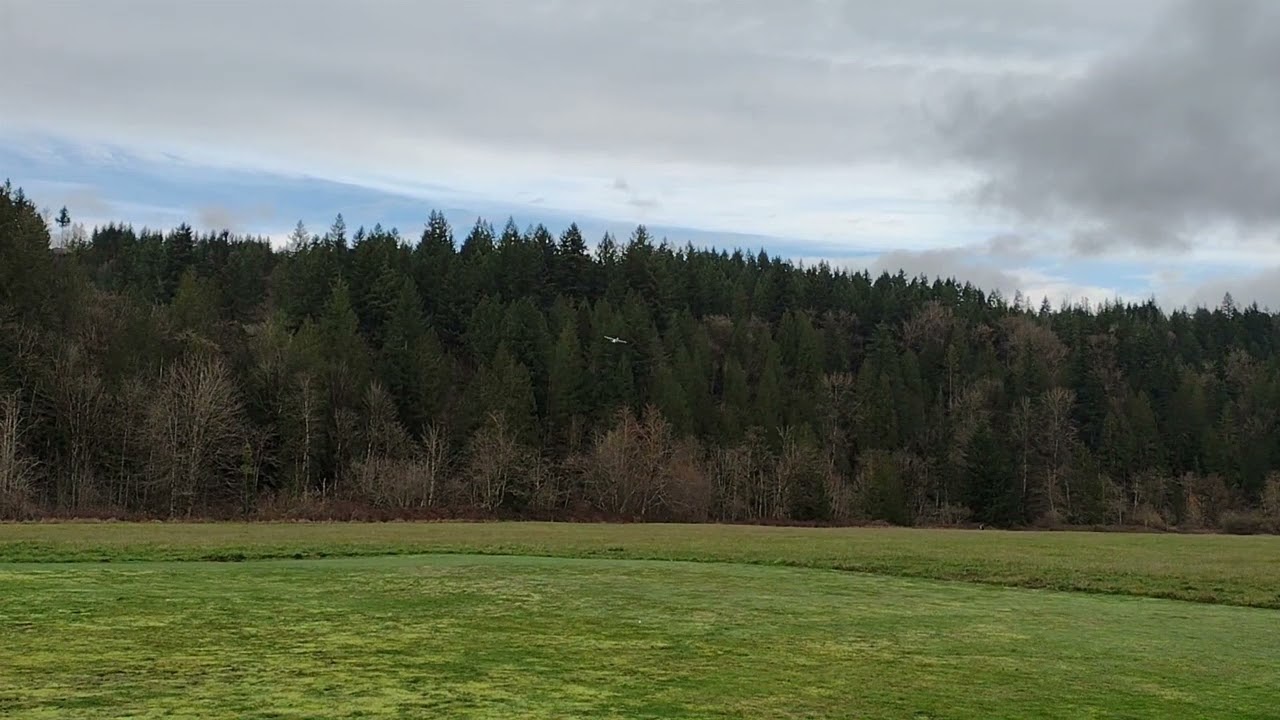

                Help. Finally got a break in the northwest weather and managed to get a few flights in. Pulls real hard to the left on takeoff and landing. Landing always rolls over and scrapes the wing tip. I have to punch it and take off quick or it'll run off the runway. Both main wheels free spin - no binding. I used Dave Brown 6" foam tires so it isn't a low tire issue. The tail wheel was given lots of oil. I put zip ties in the springs so they can't stretch. Dead stick landings are the same so not P factor, torque, etc. This thing is great to fly - only a few clicks of right rudder trim and aileron. But landings are destroying the wingtips so until I have other things to try to fix it, it's grounded.
                video below

                    Hey bud...watched your video several times. You need a lot of rudder throw and you need to use the rudder. You can't be shy with it...it takes a lot of rudder to counter P factor on takeoff (and your issue on takeoff is absolutely P factor...they all go left) and I'm not seeing you use any really. If it wants to turn left on landing then you now can anticipate that...that is what your plane does, and a lot of planes have a tendency to go one way or the other on roll out. My Corsair for instance goes the same way your Bison does...I know this so I start feeding in right rudder just as I touch down as the plane begins to roll out to correct it. I'm ahead of the tendency...not waiting until I see it go left...at that point I'm already behind it. It may take full deflection...that is fine, and normal in this case...you are slow so the rudder is less effective...so it takes all of it. Set up lots of throw...and use as much as it takes. Dial in as much expo as it takes not to be so sensitive around center stick so you can fly smooth, but remember you may have to move the gimbal a lot to get the deflection you need to correct on landing. As your plane begins to go left...I'm not seeing any rudder input on your video. Not trying to be critical or mean so please don't take this in a bad way, but I can't help you by BSing you. What I'm doing isn't magic in my videos...I just use a lot of rudder and you are not. Hope this helps you my friend.
                    Edit: A little more info...Some planes need more rudder than others. Some may seem almost automatic, some not that way at all. With models...depending on the design - the power, the amount of right thrust it has, the size of the rudder and throw, how long the tail moment is, what the angle of attack at rest is, how tall the gear is, how narrow the stance is, how high the center of mass is relative to the wheels, and where the main gear is relative to the center of gravity on a tail dragger can affect how easy/hard the ground handling will be. I have said before about the Bison...it is a rudder plane. It is relatively short coupled, has tall main gear, sits at a high angle of attack at rest, has a lot of power, and a high center of mass. It has enough rudder and throw if set up right...but you need all of it at times. There is nothing automatic with this plane...has to be flown all the time...including on the ground.

                      I'll also mention I didn't check the installed tail linkages. The elevator was loose and sliding a good 1/8 inch on the servo causing that porpoise landing. This was a very short maiden.
                      Been out one more time with it since this post. I've been to an asphalt runway with no bumps trying to get past this. Full rudder on takeoff ends up with a left ground loop. Had two guys at the field say give it right rudder. I let them try. Ground loop. Let them land. Ground loop. The plane is a treat in the sky. 25° to 30° bank, rudder, and you get a nice scale turn. But the landings just ruins it. This time of year our weather sucks. When my schedule and weather let me go to the field I don't want to waste time with this. When nicer weather comes and more people are flying I may put it up as best offer.

                        Well my friend all I can do is throw a little logic your way. I read what you are writing, but I can't inspect your plane and look at your set up. All I can do is judge the one thing I can see...in your video you are not using rudder properly. There has to be something in your set up, your gear alignment (maybe something is bent?? Too much toe in or out), or your ground handling technique.
                        If it was the plane I couldn't do it, much less repeat it over and over again with no ground loops. We are doing a third video on the Bison next Monday where we fly it without slats to do a comparison. Another video with no ground loops and lots of take offs and landings. I get you let other people try...they may not be any better with rudder than you are. My plane doesn't have anything special that yours doesn't...stock rudder, tail wheel, main gear and even the stock tires...which are sometimes not equal in pressure. Still it will take off and land without a ground loop if I do my part. If I do my part. So many RC pilots get behind a taildragger and don't know it. It takes a lot of practice to get ahead of them...to anticipate a tendency. The Bison is demanding in this regard, and you won't get there (learn these techniques well) in one additional trip to the field. In your video...you are way behind it. By the way...the pavement isn't helping you. It is much harder to handle a taildragger on pavement than grass...even rough grass.
                        The saving grace...these skills can be learned and then repeated consistently.
