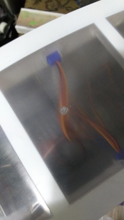

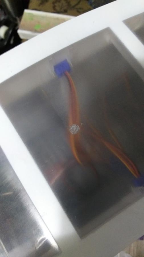

      Just got mine today. I noticed that the windows look like they have overspray on them and the very top one looks like someone dropped CA on it. Also there are not enough y harnesses to plug all the lights in. Also the esc was disconnected from the motor, and just laying loose in the battery tray.. Was anyone else's like this or did I get one that was returned by someone.
      Same issues on mine, looks like a drop of CA same spot.. Click image for larger version

        I don't think thats ca fellas. Same thing on all of them I've seen...its the point of injection (for the plastic) of the window molds. Also for anybody that wants to polish them for fpv...use automotive polishing compound, a soft cloth, and low pressure.

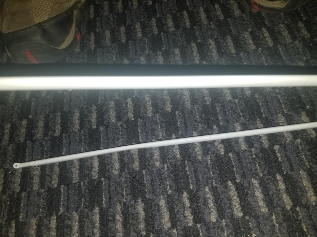

                              Ok, so my replacement strut finally arrived....in a package that was clearly stepped on.
                              And wouldn't you know it the damaged side was the right side...the one I needed.
                              Luckily I was able to grab the tube from my original wrong strut and complete the aircraft.
                              While this wasn't Motions fault. It made me even more frustrated that i had had to wait for this shipment.

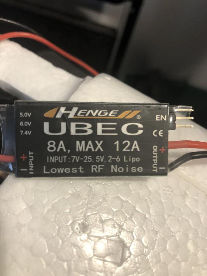

                                  For those of you having light controller over-heating issues, I installed UBEC in between the ESC and the light controller and all is well now. See attached photo. Using 6S5000 battery.Click image for larger version
