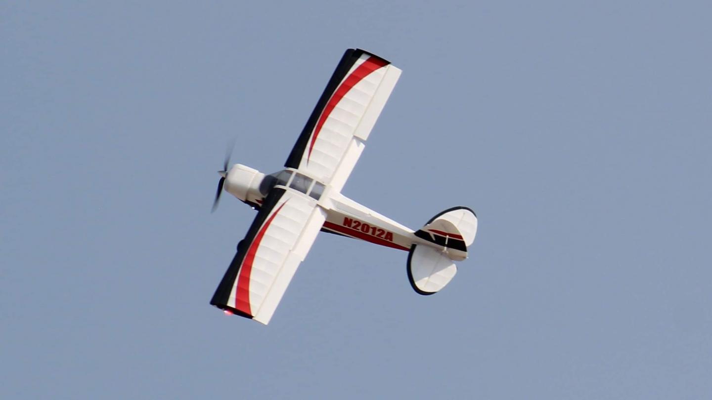

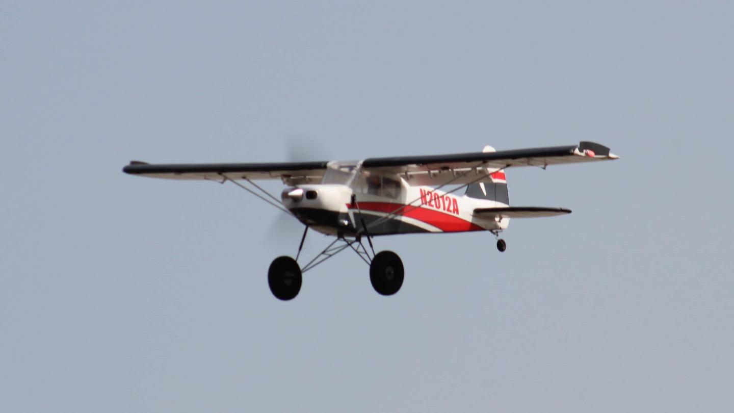

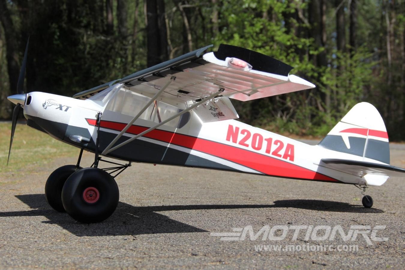

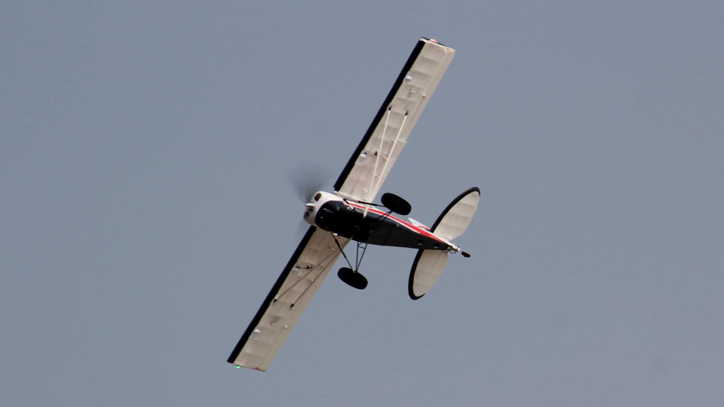

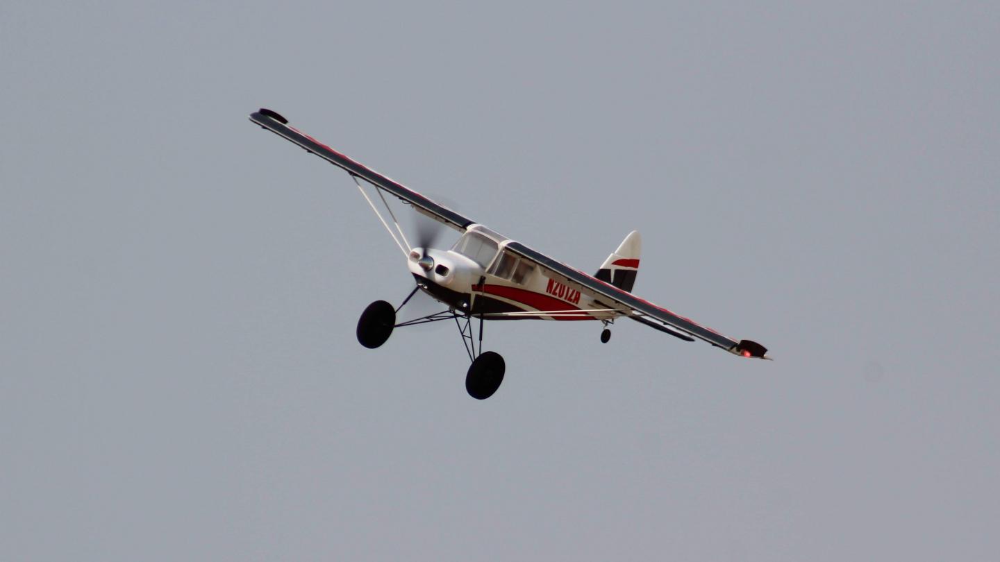

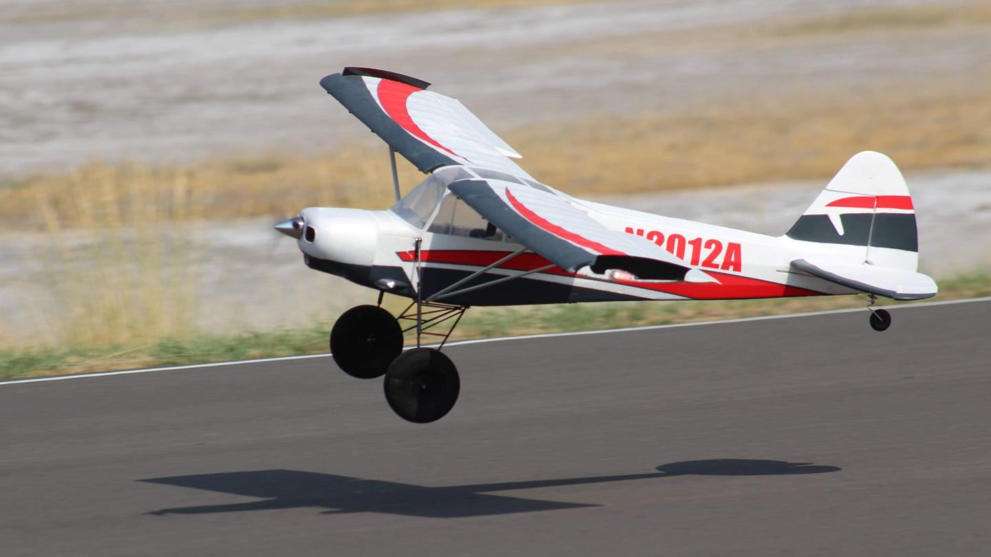

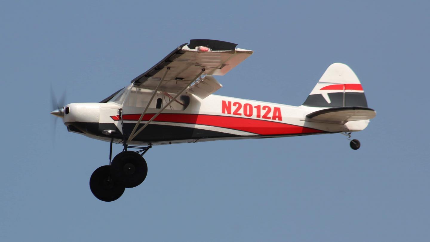

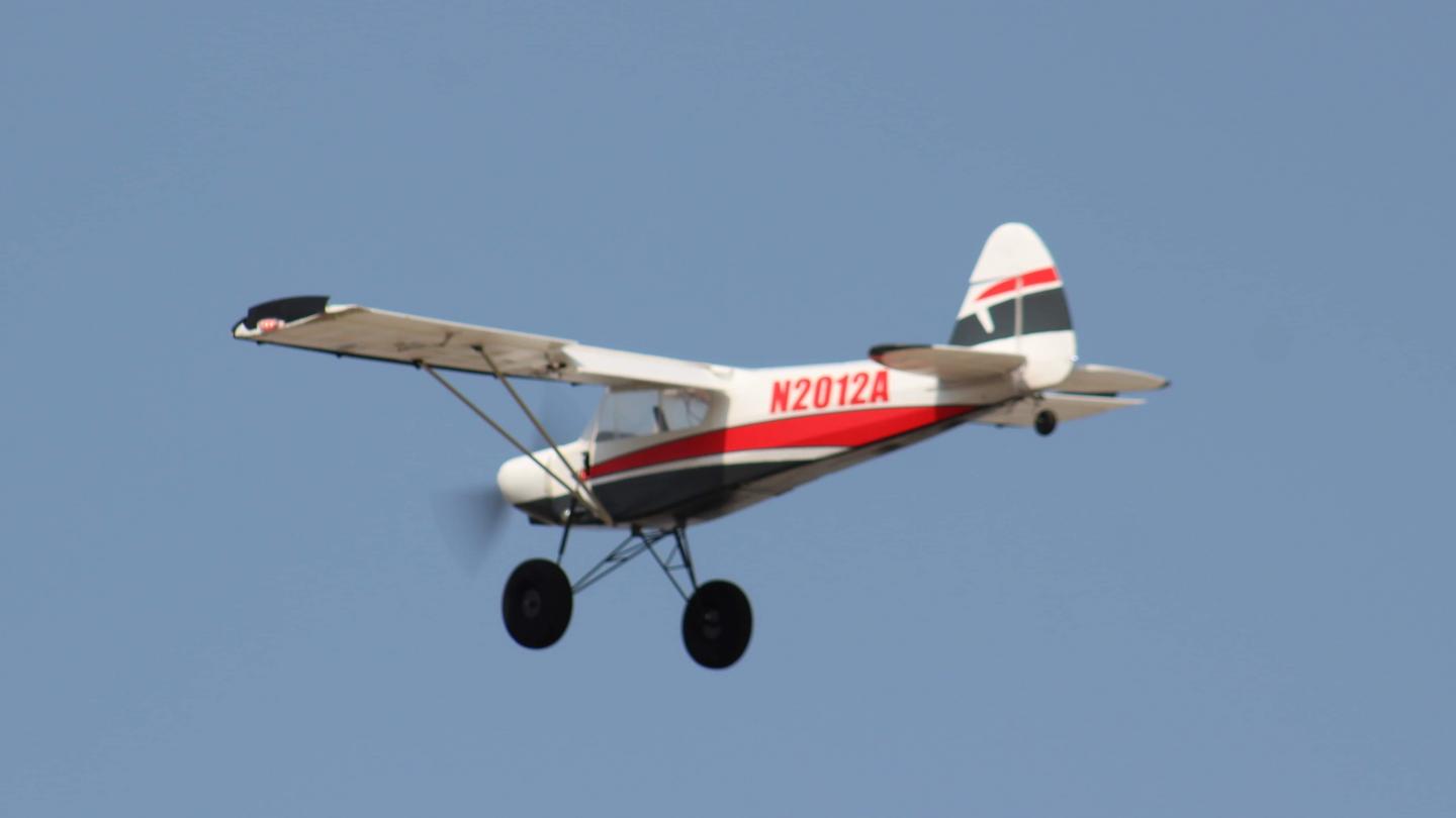

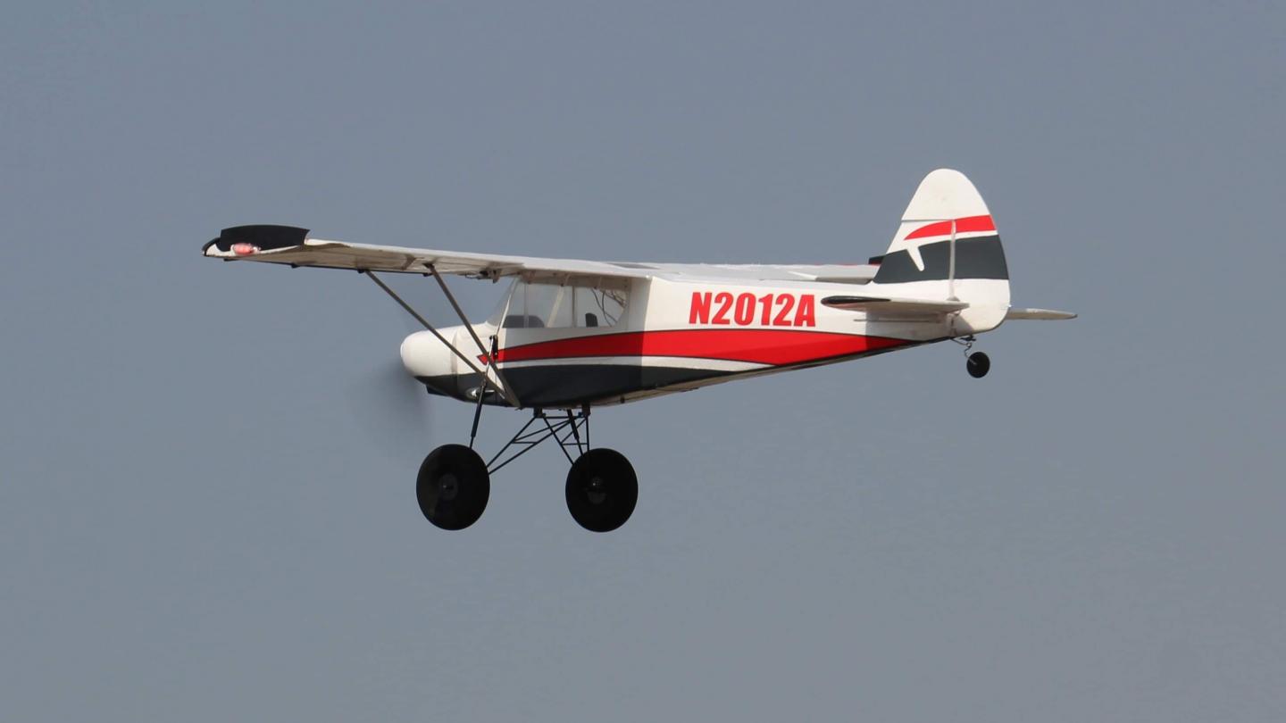

    Some pictures of the Bison for everyone to enjoy. We found the bison to be a super fun bird to play around with, its all terrain suspension is super durable and took tons of incredibly hard test landings with ZERO issues. With The Bison over 100 test flights on it, we found that you can obtain a better flight envelope than the majority of other brand stol birds, especially if you add a gyro like some other brands. the leading edge slats are an awesome option but we found that the bison really only needs minimal deflection in them to get the best STOL landings and takeoffs. As Ive seen mentioned in previous posts the tires should be glued onto the rim with “Rc car tire CA” but applied in small amounts and only in about 1/2” lengths until both sides are completely glued in place. You can put too much pressure into them so at first, only get the tire pressurized to hold the weight of the bison without being too soft and sloppy on the ground. As a recommendation, add some CA to the wingtip lights because after lots of flying, the double side tape will eventually un-stick and you dont want to loose the light assy. For best results give a quick burst of throttle right before landing to cushion your landings.
    All in all the Bison is large durable stol bird that loves the off road approach to the rc flying hobby. have fun with the Bison because we have.

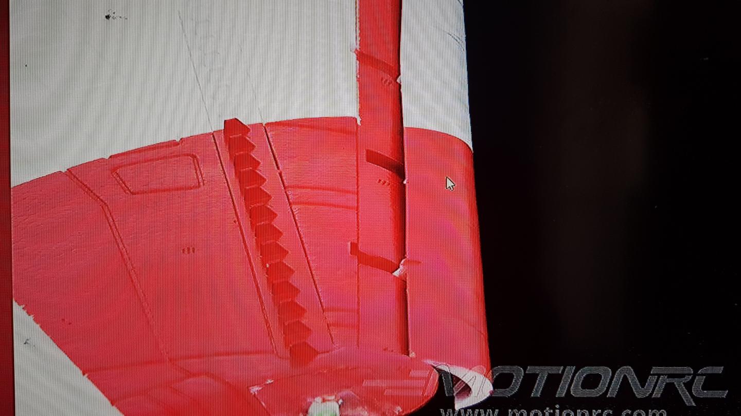

          Originally posted by Warlox
          Ordered mine this afternoon when I did my hourly check to see if it was available lol. Anyone know if this has a modeled dashboard?

            Looks like I’ll have to make my own interior details. Still going to be a fun plane.
