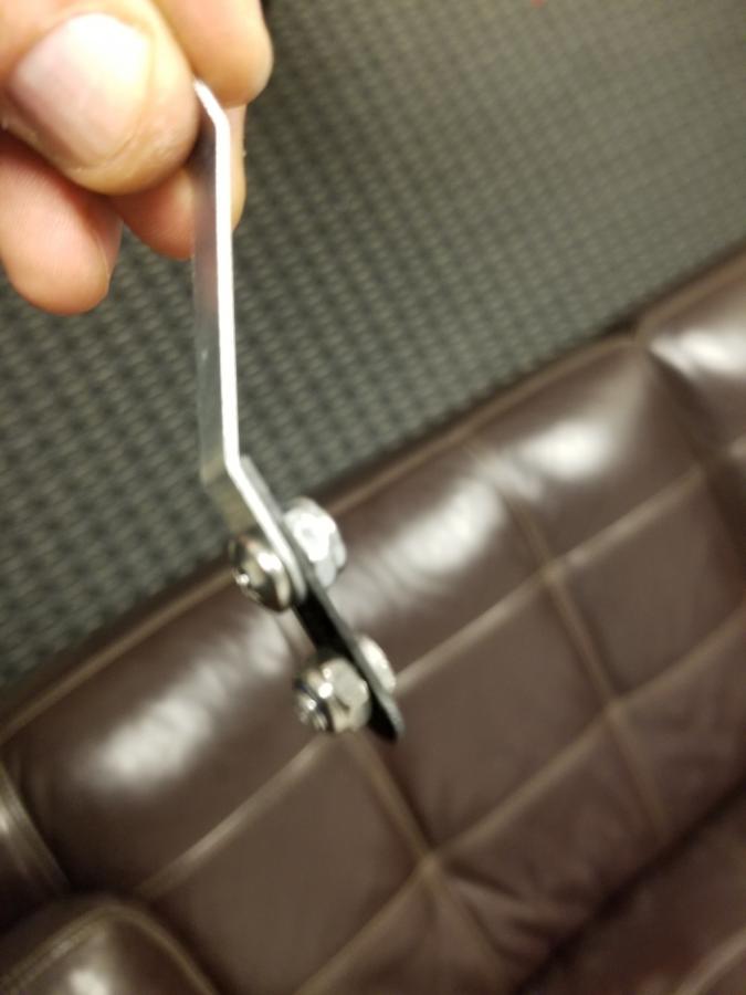

                      • Very weak tailwheel springs. I can hardly turn one way or the other. Tried shortening the springs to apply more tension, I may have attached them wrong or cut them too short...really not sure because I still can't get the tail wheel to turn much at all. Any suggestions or alternatives?
                        • Originally posted by skiervh View Post
                          Im fairly certain looking closely at it with smaller springs, that that answer will be to drill new holes for the srpings closer to the center of the wheel pivot.
                            2much2do's suggestion may work...I'm going to use stronger springs, but to be honest for my last several flights this week I've been just lifting the tail with down elevator and some power and getting the tail around tightly that way. It's pretty easy to do with this plane because of the high angle of attack with the tall main gear. The tail doesn't have to come up much and with full rudder she comes on around...looks like a real bush pilots plane when you do it too! I realize thats a technique fix not a mechanical fix, but it's fun...

                            • You know the best answer is probably actually to make a longer tailwheel stinger. That would give the springs from the rudder a better pull angle. I might make a carbon one since I can't finish the plane.
                              • Originally posted by 2much2do View Post
                                Now that idea I like a lot. Easy to do too.

                                    • 2much2do I'm going with your idea and making the stinger longer. We will post an update vid first of the week and I'll show how that works among other things.

                                      • Originally posted by Starck Mad View Post
                                        Rapid-fire proof of concept, I just moved the tail wheel pass-through back s bit with a small bit of carbon plate, and attached that through the original hole with a 10/32 machine screw.
                                        I should note that I had tighter springs on it already, and that didn't change much as far as wheel travel. This actually seems to make it much more consistent at least.
