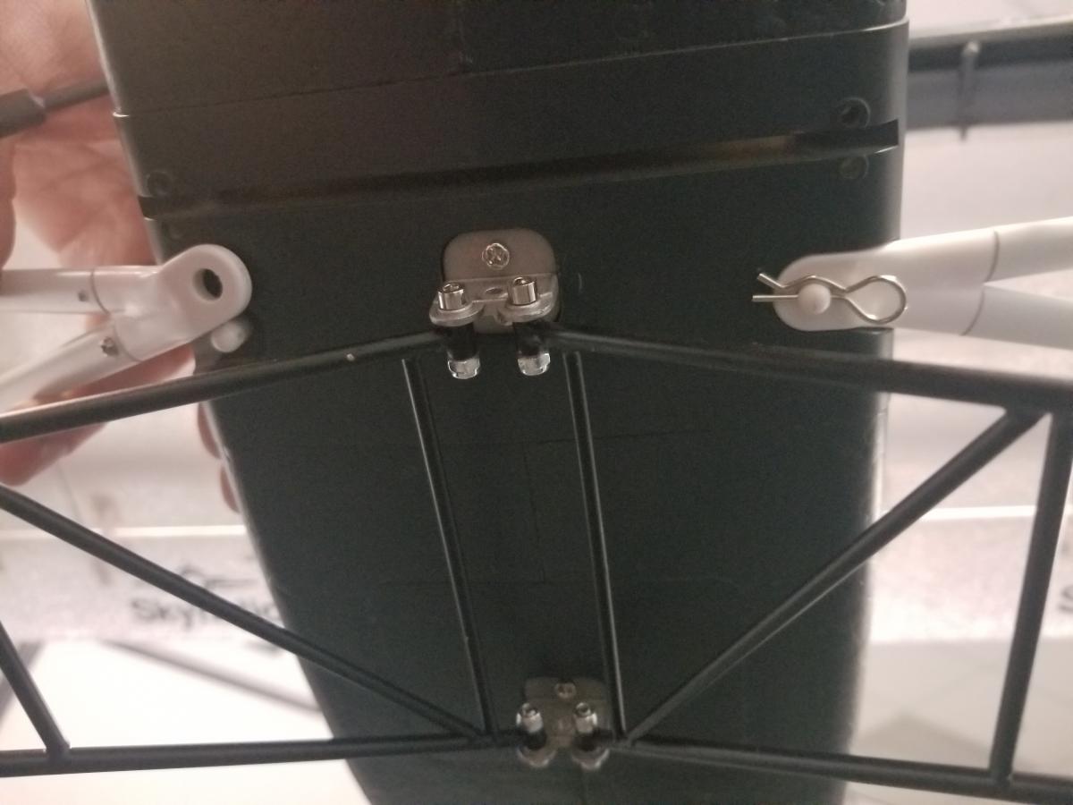

                  Finally got the airframe together - not like Freewing is it? Turns out the left wing has the wrong slat on it. The plastic atach points do not line up with the actuator wires. Anyway - i opened a ticket and will try to fly with no slats? I hear it flys ok that way?

                      OK, so no screws came in my tail wheel assembly bag eigther. Did anyone get screws in here for the tail wheel like the instructions say? Are they the 2.6x12 screws?

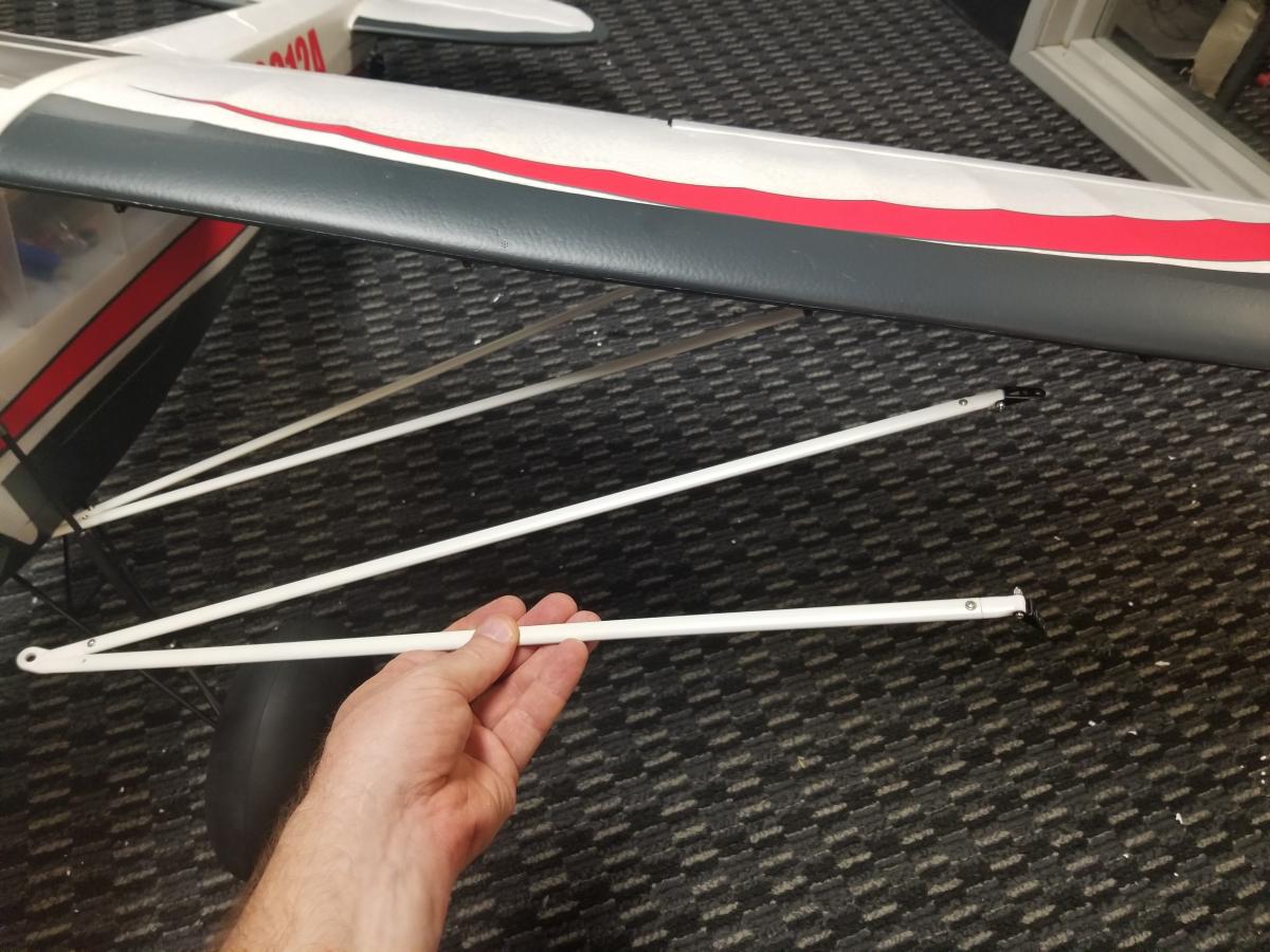

                        My kit came with 2 left wing struts.....they can't be built upside down...wtf
                        I even tried to flip one by re-tapping the plastic parts, the angles on the plastic do not fit with the bottom of the fuselage.

                          #152
                          I see this kind of thing and my experiences with the plane really reminds me of dynam, but without the discounted price tag.
                          This isn't about modeling and making modifications to suit a particular retract or motor selection. The manual reviewers failed at their job. Missing parts, parts improperly connected over heating controllers have all been reported and not as one off issues. These are not something fixed merely by modeling skills. This is poor quality control.

                            Well, I dont think this is flyable like this, the spar isnt long enough to just not have the struts, so we will see what they say when I call them in the morning.

                                My kit had two right hand struts, not mirrored, but i got it to work by having the screws on top for the left hand side. I chalked it up to a cost savings measure, but maybe it's a mispack?
                                I normally would not care too much, but I am still looking for the source of why I need a lot of rudder trim, maybe there is a weird torque on the wings because of mismatched struts?
