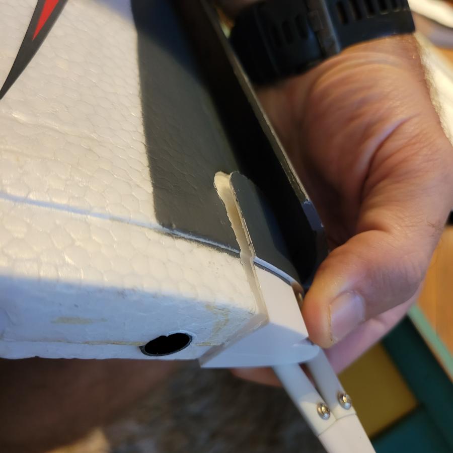

                        My wings have been pretty tight when installing and removing from the fusalage. On my 7th or 8th time removing wings, noticed some separation here. Easy fix but just something for others to be aware of.Click image for larger version
