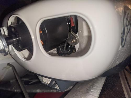

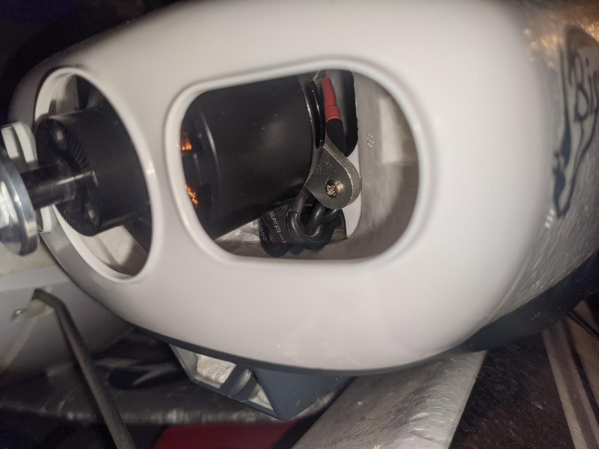

      Originally posted by JT83
      Ok I will check that. Another thing the esc I've checked all possible locations in the battery hatch area and there really is no good place to mount it I was thinking to just strap it down with the battery probably not be a good idea esc would probly over heat.thanks!!
      There is a slot just below the motor mount where I routed the motor wires and placed the esc.

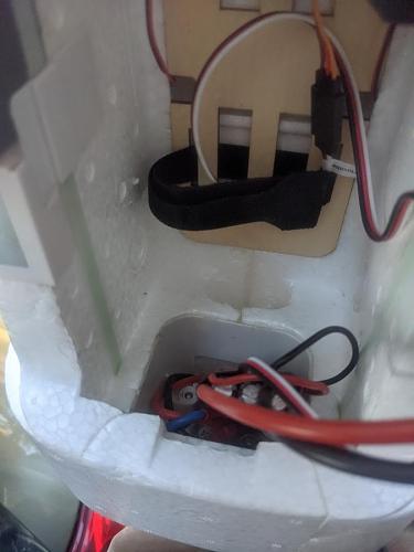

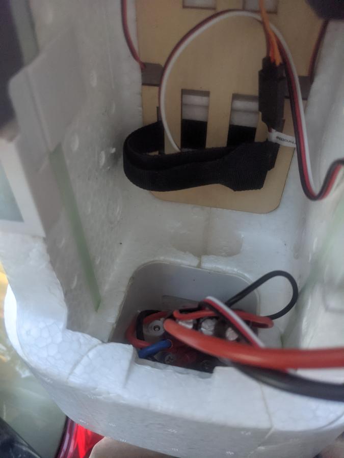

          #244
          Can you post an inside view please?

              #246

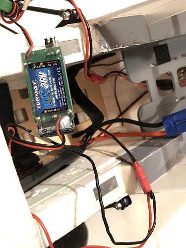

                                    Originally posted by JoeofDeLand
                                    For those of you having light controller over-heating issues, I installed UBEC in between the ESC and the light controller and all is well now. See attached photo. Using 6S5000 battery.Click image for larger version
                                    Was looking for a little advice on the UBEC. I installed all the lights with the black and white wires plugged into the gear position on the receiver, used a three way servo lead since I'm using a 6 channel receiver, fired up the radio, attached a 6S lipo and all worked well with the lights. Gear switch on radio turned off and on all the lights. But man did the light controller heat up to the point it was untouchable!! I have a UBEC like the one you pictured but I'm not real well versed in the install. Does the jst plug on the UBEC plug into the jst from the ESC and the two wires with no jst plug get connected to the light controller? the output wires are of a heavier gauge which has confused me a bit. Is there anything else I need to know? Can I still keep the white and black wire plugged into the gear position on the receiver. I have read that if you install a UBEC you need to disable the internal BEC by cutting the red wire, or is it ok to run both the BEC and the UBEC together. I'm new at this aspect so any advice would be very helpful.........
                                    • Denc23@comcast.net
                                      • Sep 2021
                                      • 8
                                      #258
ID:	327802 You only disconnect the red wire on the throttle ch3 if you power the receiver with a external BEC. If you use the ubec to power the lights you just install a red jst connector to connect to original lead from esc for the light controller, and remove the ubec out put connector, usually s servo type connector to Rx, and install the correct jst connector to light controller. I’ll post a picture of mine later. Make sure your UBEC will take 22v input. Mine goes to 26v. Then set the output jumper to 6v, or what ever the out is. Mine is 5v or 6v. Lower right connector from esc, middle to the right of ubec goes to light controller.
