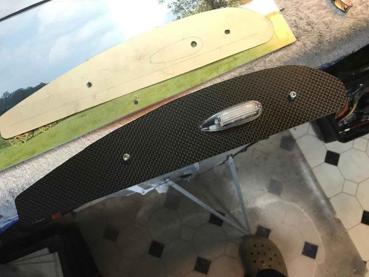

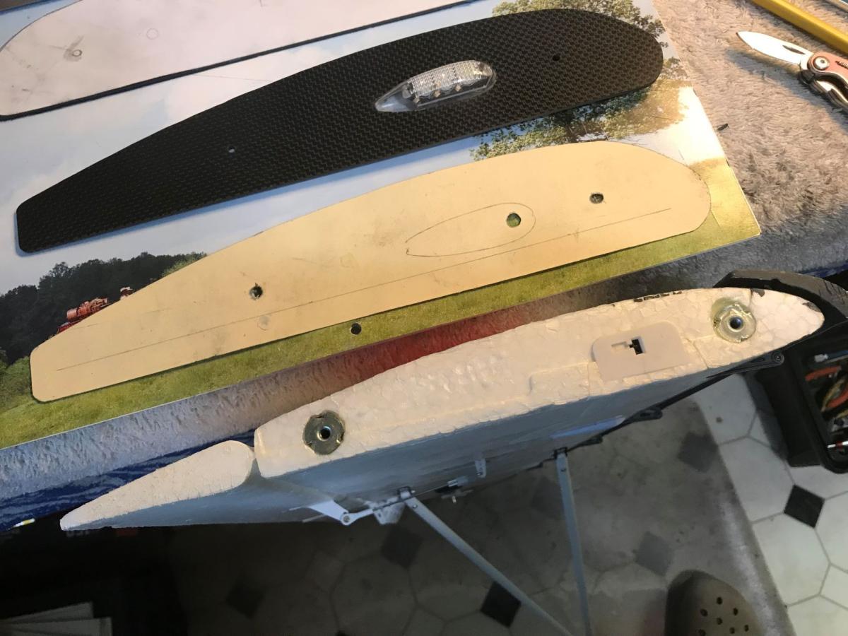

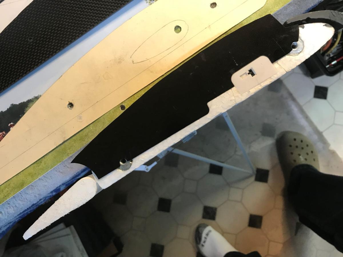

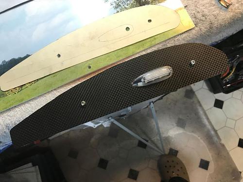

                            Have noticed in many of the posted videos lots of wing tip strikes in less than perfect landings; and since I do lotta that I came up with this mod:
                            Thought the exposed wing tips could be improved with drop tip "winglits" to protect the exposed wing tips and ailerons. Found carbon fiber sheet/plate 2mmx200x300 on ebay; made a template 1/2" larger than the airfoil top and bottom. Counter sink 6-32 blind nuts and epoxy into wing tips; but the trick is getting that done with no epoxy in the threads! Could also use screw in threaded inserts in 6-32 or small M sizes. Next I foam tacked on the stock black winglets in the recess. I cut the carbon fiber with a Jig saw with fine tooth metal cutting blade just outside the line and final sanded to shape with just sand paper on a block. Do use a good respirator since you don't want to breathe the fine carbon fiber dust. The cut out for the wing tip lights was with me old Dremel jigsaw with fine thread blade and a hand jigsaw. And the finished look:
                            Looks great and might even help knife edge flight (like I can even do dat). I haven't flown it yet 'cause it's 34* F outside and I don't have a suitable 6S batr'y because I spent all this months

                                    This is a great mod, but I have a question regarding the pictures you uploaded. What happened to your other Crock?

                                      • Narly
                                        • 52
                                        • Wunderful Wyoming
                                        #339
                                        @ebrahimijohn:
                                        The 6 mo. old Cavalier KCS that I was doggie sitting f/ 3 days ate it, along w/ 1 hearing aid & the ear & nose pieces off my glasses ....... while I was concentrating on Bison mod 🙄
                                        Xpensive lesson learned ..... 'bout 2 Bison's worth ......
