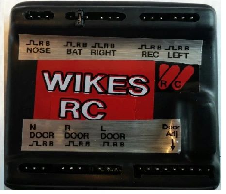

    Well bummer. It turns out I can't get the custom Robart landing gear to work with any controllers...Ed said he can get the gear to cycle with the Down and Locked sequencer that Brad ordered but the gear doors don't function and have been frying servos. I bought a Xicon controller but it appears the gear is 15 years old or so and therefore doesn't appear to be compatible. The controller needs the motor amps from the retracts but we have been unsuccessful in finding that info.
    So I am officially raising the white flag. Ed is going to put the old D&L controller back in her so I can at least cycle the gear but the gear doors will be useless. My only other recourse is to purchase new Robart gear which is about $700 bucks and change. Ouch. So I am pretty bummed. I am picking her up As Is this Sunday. For now she's going to remain a very expensive Hangar Queen.
    If anyone has any suggestions I am all ears.

                  So the latest is Ed has talked to a guy named Ron who owns wikesrc.com. Apparently Ron was Mitch's partner and the one actually responsible for building these controllers. They had a falling out I guess and he started his own business. Ed spoke with him and Ron said his controller will in fact work for us. It appears it had to do with the end point adjustments that was frying servos. His controller is not cheap ($300! Ouch!) but it includes the EPA programmer which we have. So he said he could give us a deal since we already have the programmer.
                  He's on vacation at the moment so as soon as he's back we can order it and HOPEFULLY that solves this final aggravation, lol!
                  Here's the controller:
                  RETRACT CONTROL BOARD WITH SEQUENCER & PROGRAMMER - Direct replacement for BVM and DOWN AND LOCKED retract control board with built in sequencer and Gear Door END POINT PROGRAMMER. END POINT PROGRAMMER is used to set the open and closed position of the gear doors and the door configuration when the gear is down. The control board can be setup at the factory to run the high amp motors used by Down and Locked and Century Jet. Use the contact form to discuss your project today. Please note the Cover and label has changed. s RETRACT CONTROL BOARD WITH SEQUENCER & PROGRAMMER - Direct replacement for BVM and DOWN AND LOCKED retract control board with built in sequencer and Gear Door END POINT PROGRAMMER. END POINT PROGRAMMER is used to set the open and closed position of the gear doors and the door configuration when the gear is down. The control board can be setup at the factory to run the high amp motors used by Down and Locked and Century Jet. Use the contact form to discuss your project today. Please note the Cover and label has changed. Made to order 4 week lead time

                    OK so apparently the D&L motors are high amp and he sets them up for that at the factory before shipping it to you. Glad your at least getting a discount for having the programmer. //////sheesh!

                                        I picked her up today. Ed did a fantastic job making sure I was happy with all working components, controls, power...While the main electrical section looks like something out of NASA, she's good to go. The gear door issue was resolved thanks to Ron formerly of Down and Locked who created a special device for the old analog system that came with the model to talk to the modern day digital servos.
