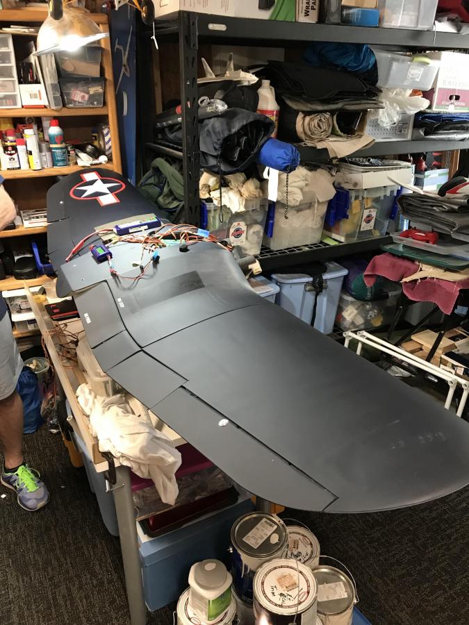

                Spent some time over at Chris'...The wing looks great..Flaps, ailerons are in perfect working order. The hold up is that Chris thinks we need 2x 2S 3000 mAh's to run the flaps and ailerons. Static it is pulling over 2 amps. The sequencer/control board is a bit old and there is no real decent documentation for it but we will make it work. We agreed that the gear will need it's own battery as well. So in total there will be 5 LiPos in this big bird, each having specific rolls to play. We won't know the AUW until the end of course but we both guess 25 pounds is probably in the ballpark.
                He has some fine tuning yet to do with the gear doors and then it's time for the fuselage. Progress.
