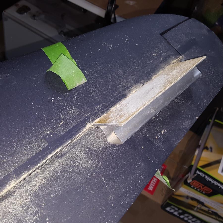

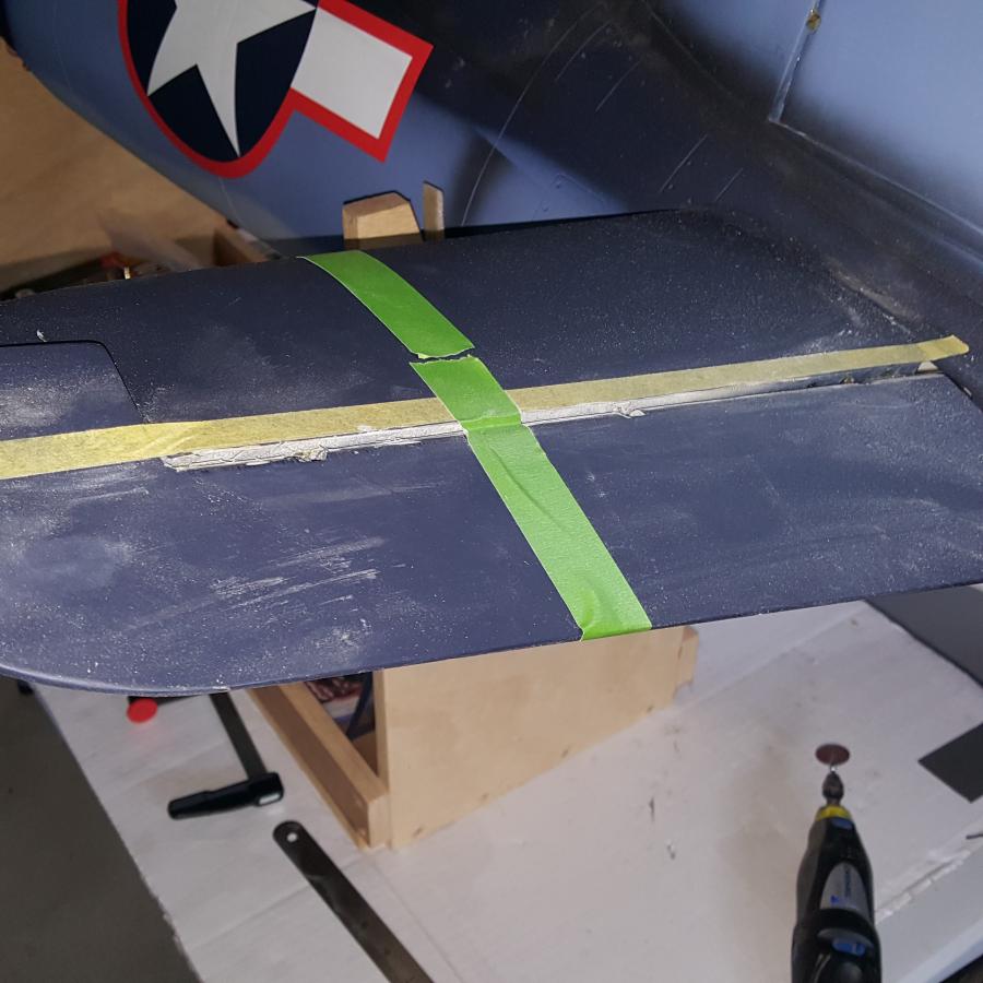

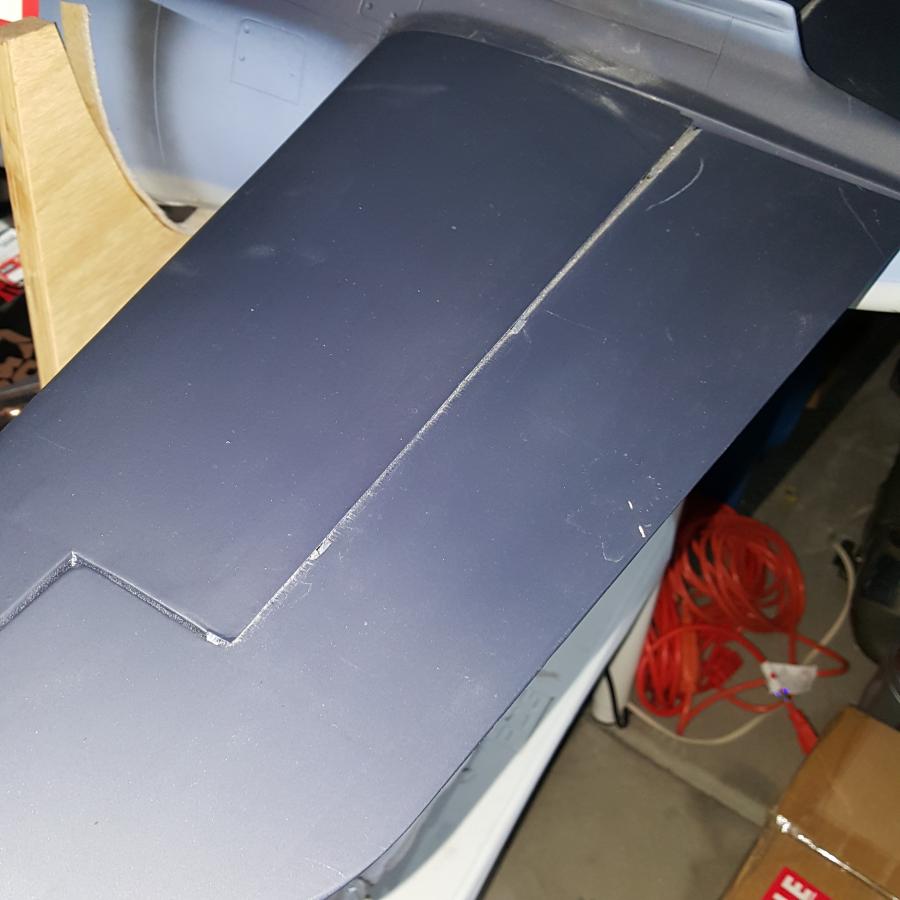

                        Updates on your Corsair. I trimmed out the Horizontal stabs about 1.5mm to give it a straight edge and sanded down the edges evenly rather that goes through the skin and gouge out the horn hinges. I believe this is better done since it will not affect the aerodynamics of the stabs.
                          #772
                          Looking good Ed, thanks for the update and pics! I was going to post them too...The canopy rails are coming along too so thank you!

                            Hi Ed, so was the sanding of the trailing edge of the horizontal stab in place of drilling out the hinge points? I assume that gave the additional needed travel? If so, great!
