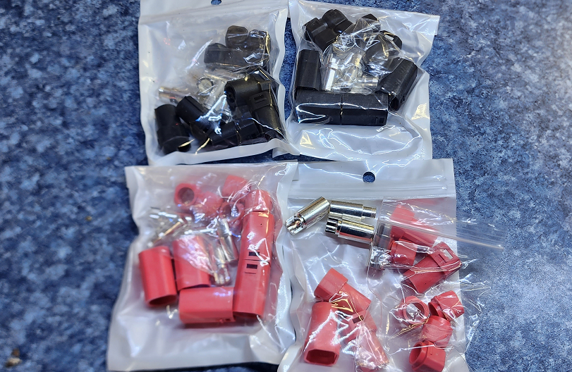

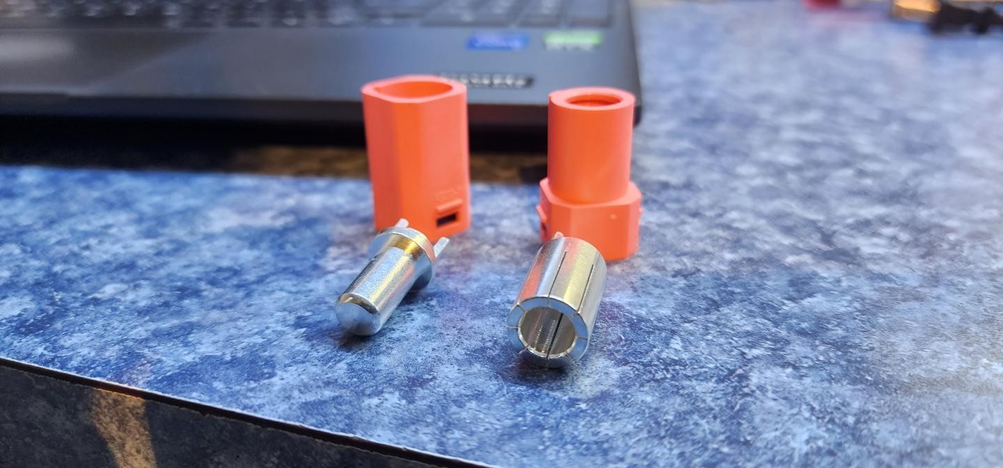

    • You know you can send the esc cells etc here with the connector and I can solder everything up for you. What size and brand connectors are on the motor. I also don't remember but what ESC?

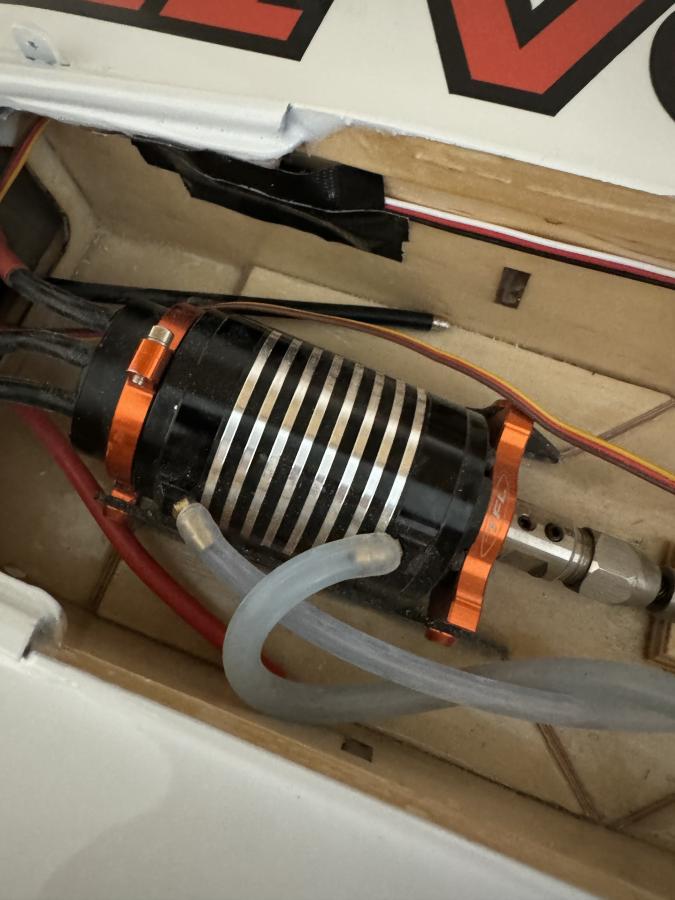

          My motor is 850Kv and the ZTW 200A ESC is rated up to 8S.
          Motor:
          ESC:

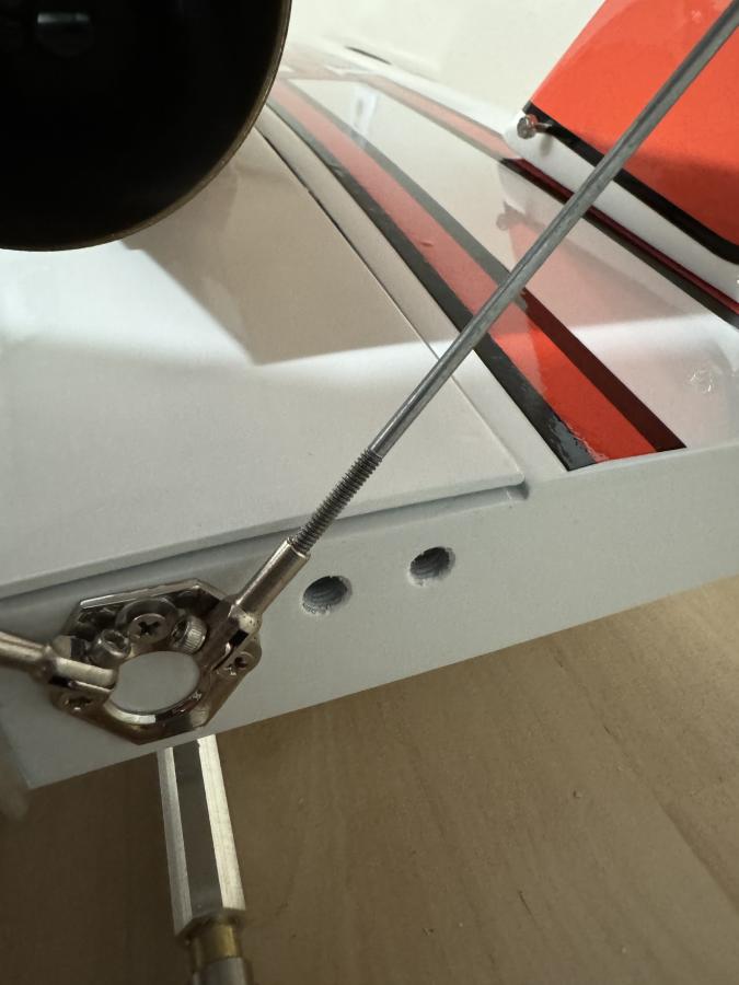

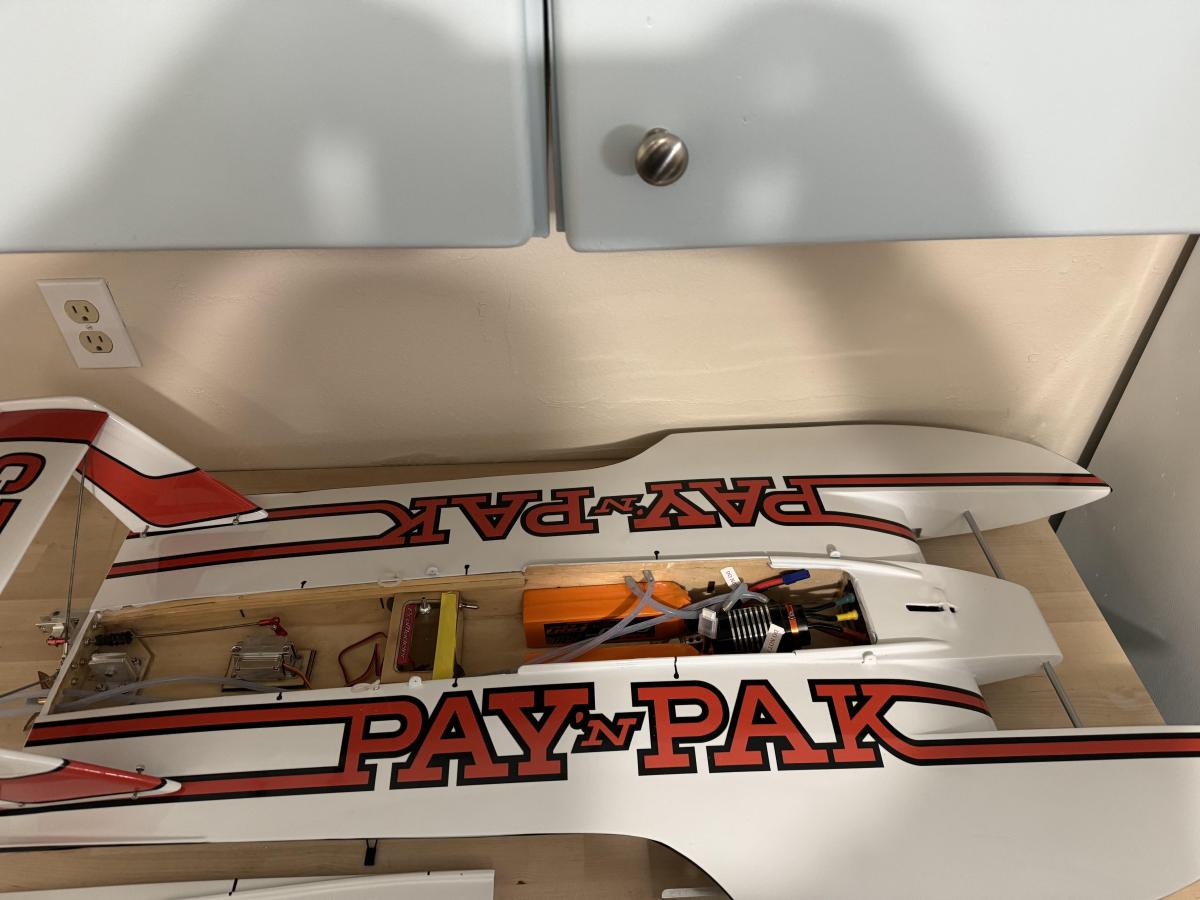

          • Here’s some more pictures showing the outlets and other doohickeys haha…
            • You'll be fine. You can set 2 more of the same identical pack in the same orientation aft of the first set and the cg should be okay. The motor and esc combination should be fine. Let me see the rudder. I think you must have a dual pickup. Also do the 2 water lines run beneath the radio box. The esc sports 10 AWG so castle 6.5mm should be fine. The esc is 200 amperes continuous it should be able to peak at least 282 amperes. You need to configure 4 packs in a parallel-series configuration that will give you 8s @ 6000 mah.

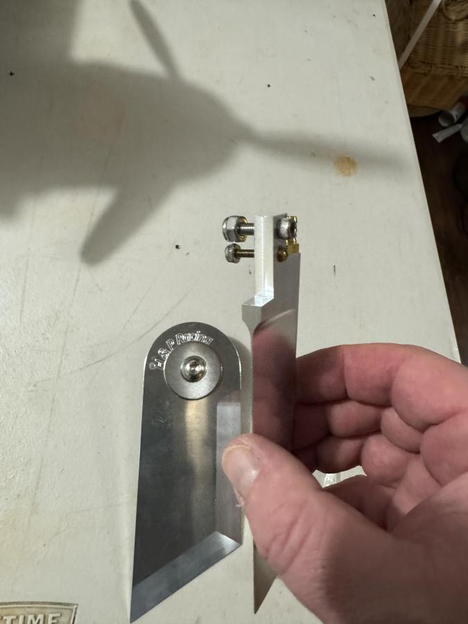

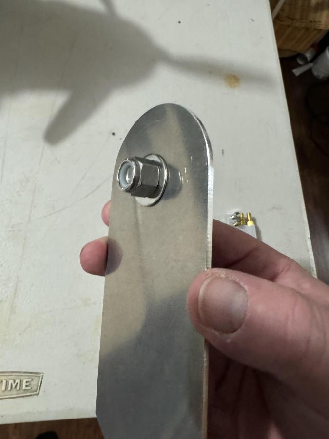

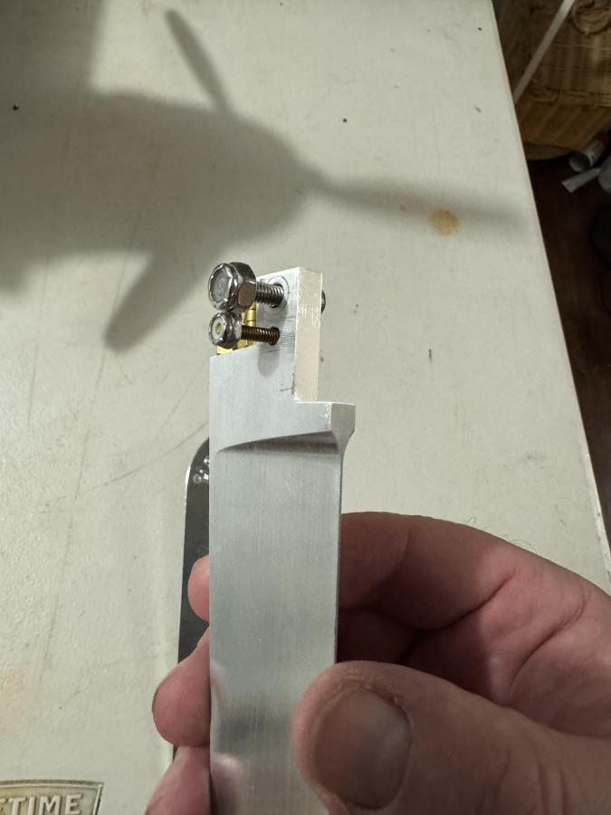

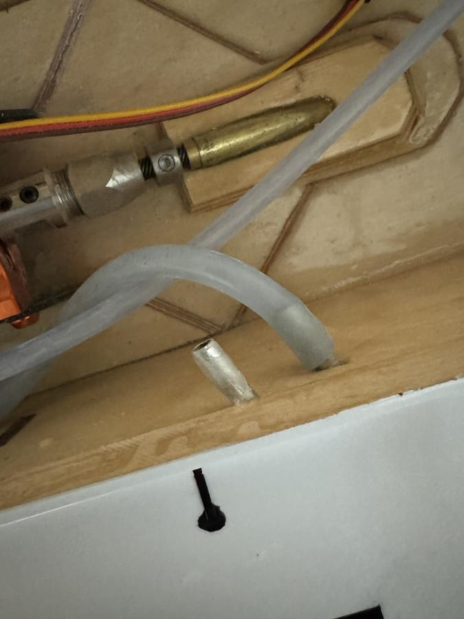

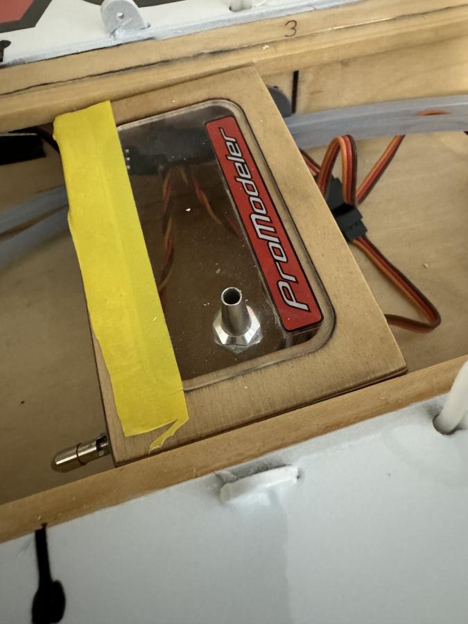

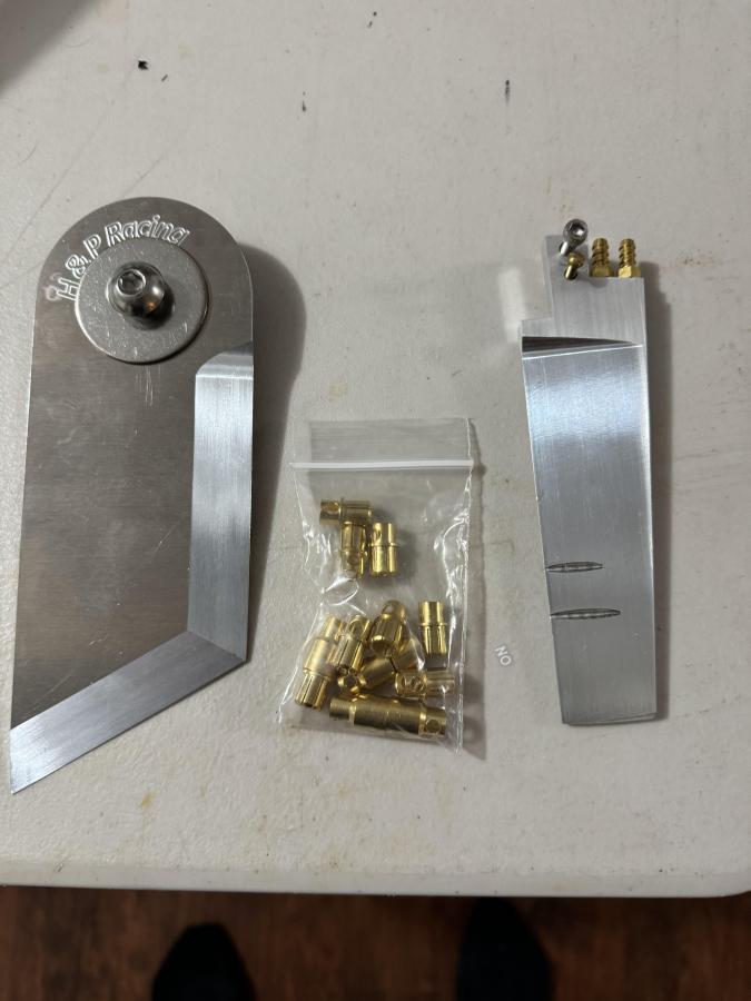

                    • Here's some photos of my rudder and turn fin...
                      • Originally posted by Aros View Post

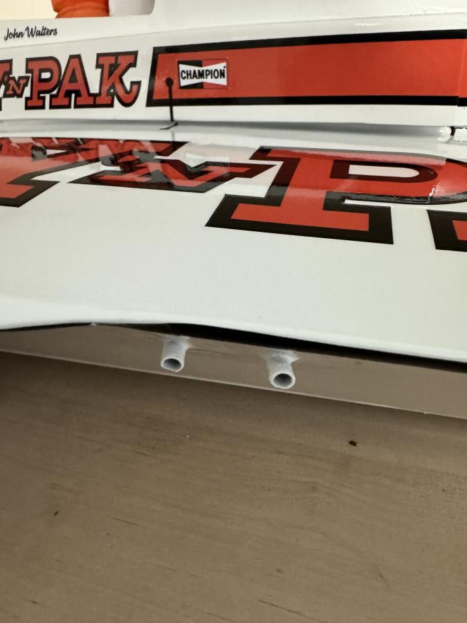

                        Okay so the two water coolant lines start off the nipples of the rudder and enter the boat through the transom. One input feeds the lowest input of the water cooling jacket and the line coming off the jacket goes to one of the exits lines on the side of the boat. The other input line from the rudder feeds the input of the esc cooling the exit line goes to the other side exit.
                        • Okay great, thanks! I'm sure I can figure it out. The tubes going out to the rudder are easy enough and I have that open port that one of the lines can latch onto...Process of elimination!
                            Frow what I saw all the allotments are already in place. What are you speaking of opening up?
                            • I think what is left is the line to the ESC?
                              • Im not sure what you mean but you have two totally separate systems fed off the rudder. One feeds the motors cooling the other feeds the esc. The exit for each system is the 2 exits out the side of the boat.
Name:	coolant routing.jpg

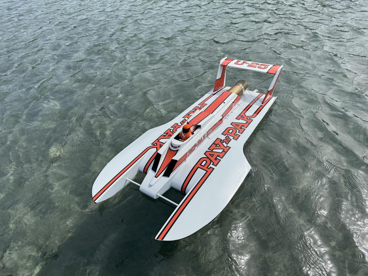

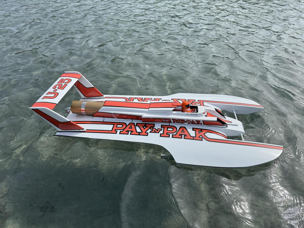

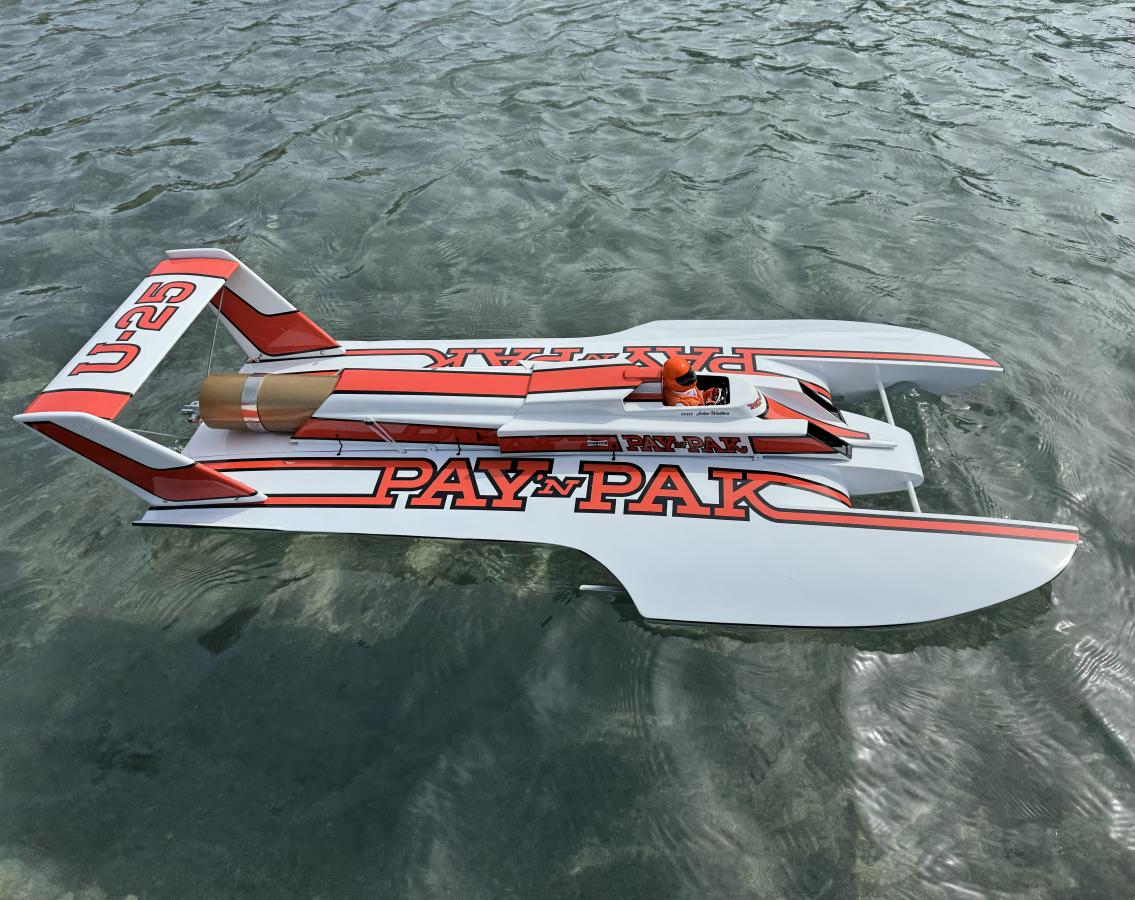

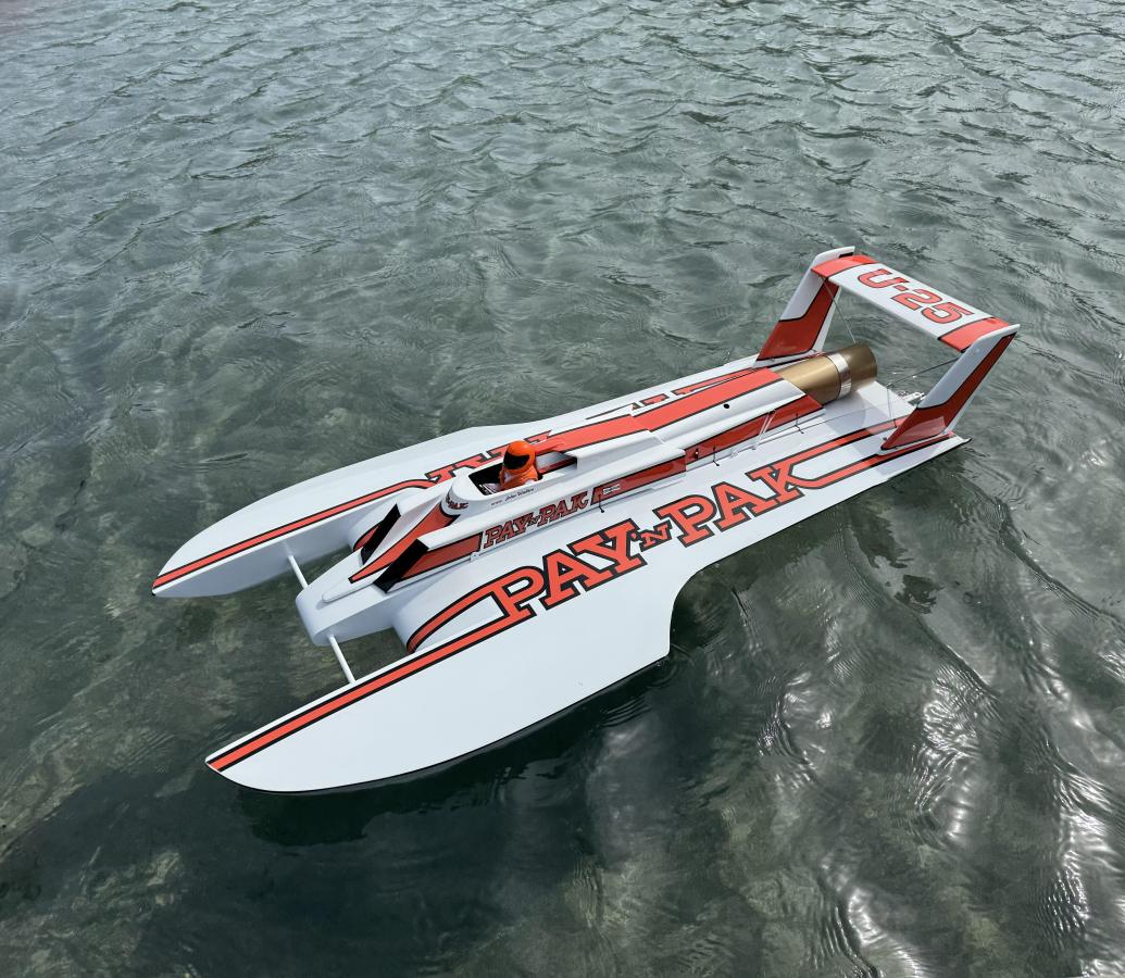

                                    • Took the girl out for a photo op at the local community pond...
                                        The community pond has some beautiful clear water to sit that girl on........
                                        let me see the connectors on you old and new batteries when you get the time. I also think you should order a 2nd pair of your 3000 mah cells for back up. I really like the way they fit. with the first pair. If you can spare the coin go on and do that. I'll send you all the connectors like you have pre wired for serial and parallel connections.

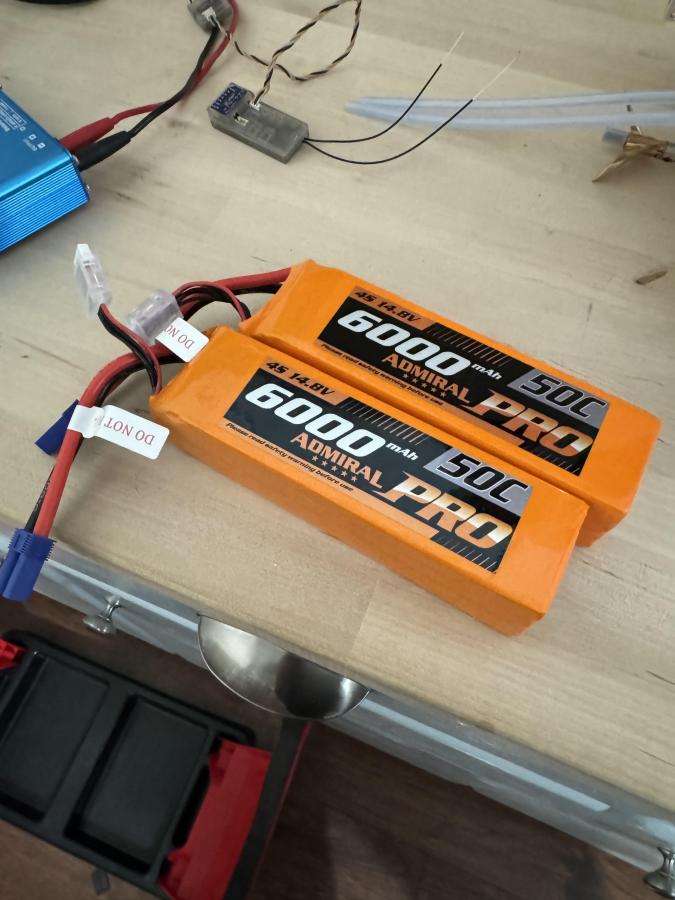

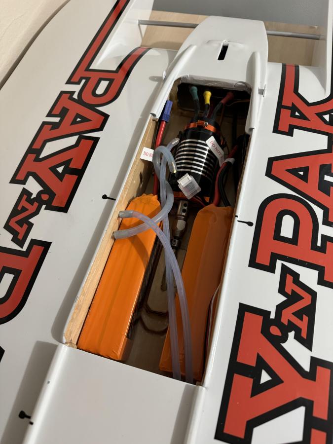

                                        • I got my batteries today. 2x 4S 6000 mAh...They don't sit flush by the motor like the smaller batteries did so here's where they sit. Hopefully I can CG with these at this location?
