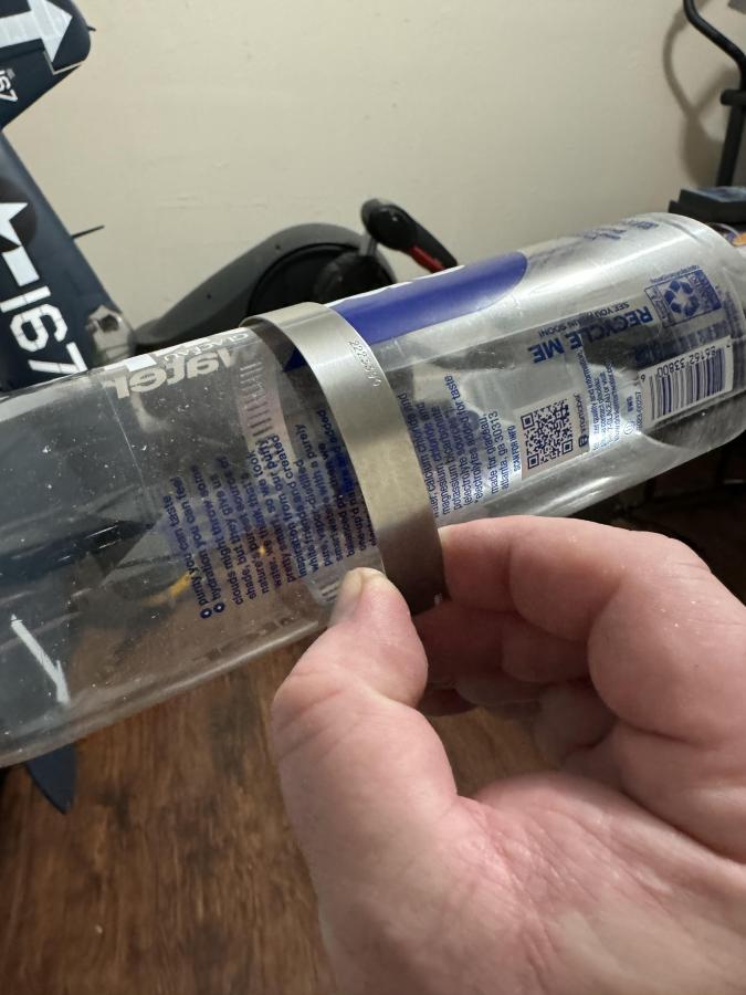

      So I bought a real aluminum tube with the proper size...It's as scale as you could get looks-wise. It's thicker than I prefer and ultimately heavier (0.7 lbs). However since this is a leisure hobby and not planning on racing it shouldn't matter. Now I have to figure out the ring thing in the middle and it should work!

          Guys why not buy a light thin sheet of aluminum from Lowes and roll it. The last thing you want with an 1/8th scale hydro is it tail heavy. Its a fast electric boat weight only drives the amperage up to push the boat. You do not want a heavy tail because the super cavitating surface piecing prop has to work harder to lift the transom of the boat which should be well out of the water on plane.. Don't make this harder than it needs to be. That thick pipe is truly too much. Its not just about speed to run well the CG is important for it to run correctly as a hydro PLANE.. It flies across the water with the front sponson trailing edges . and just the tip of the prop in the water.

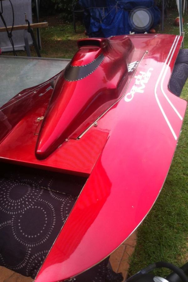

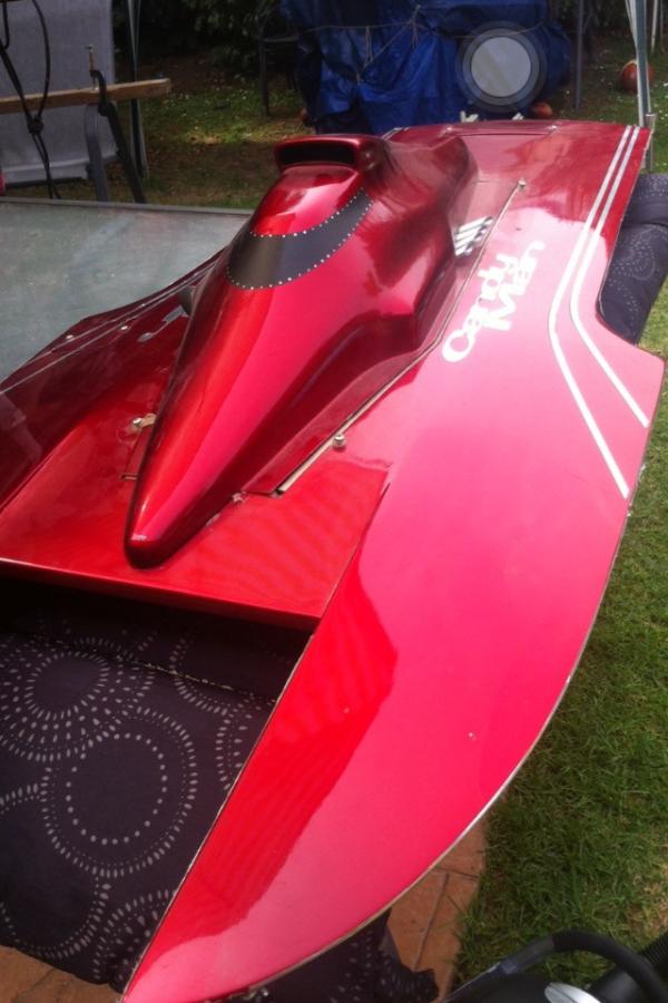

                      #90
                      Pics Click image for larger version
ID:	397176 Click image for larger version
                      • f4u ausie
                        • 1240
                        • Melbourne
                        #91
                        I painted this maybe 10 years ago

                          Very good points Clugh. You are 100% correct. That's just way too heavy. I'll go the aluminum roll route or paint the Smart Water bottle aluminum. It's a perfect fit.

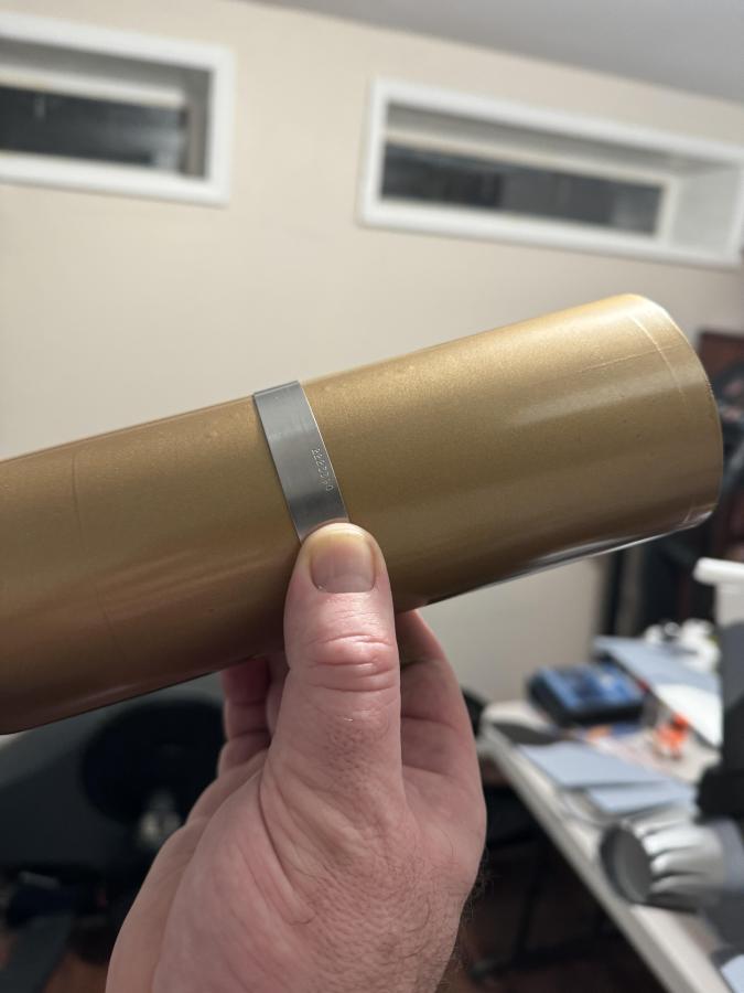

                                      First off, the length of the Smart Bottle (including lip) is just over 10". I truly appreciate your thoughts and commentary and in fact expertise on the matter. Your info and input has been invaluable! Before I read your post I had already spent some time today gathering the pieces to make it as scale as I can. The photos below will document my progress. One thing I LOVE about the Smart Water bottle is it is the EXACT size I need. I cut off and sanded the bottom. The lip piece sticks inside the cowl where you wouldn't see it and the plan is to glue it to the cowl so it becomes one piece.
                                      I went to Home Depot and found a part that will work brilliantly as that center ring piece. If you notice the first photo, you will see the mistake many Pak owners make is that they mistakenly think the turbine tube is chrome or silver (or don't care). It's actually a darker bronze. I have checked multiple photos of the real thing and indeed it is of a darker bronze shade not chrome or bright aluminum. Scale appeal matters to me as I am sure it does you too.
                                      I'm super pleased of how it's turning out but I am certainly still open to something as an alternative if it can be even better? As for the decals, the painter will be turning the boat over to me this week for me to lay down all the decals, then I will return it to him for the clear coats, and then she's done! So here's the photos...

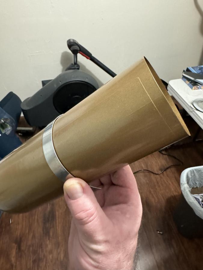

                                        Well that went over like a lead balloon.

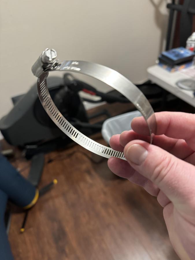

                                        When I tried to epoxy the ring to the tube it made a huge mess and I had to throw it out. I will need to re-sand the tube and repaint. I found a new ring to try out which might work better:
                                        Click image for larger version  Name:	IMG_5589.jpg Views:	0 Size:	47.2 KB ID:	397396
                                          • 8233
                                          #100
                                          If it doesn’t slide onto the tube like a ring on a finger (as it’s the same diameter as the bottle diameter) I can dremel a cut to expand it slightly to fit and then it should be easy to apply a couple of small points of glue to keep it in place.
                                          If that doesn’t work I’m at a loss, lol.
