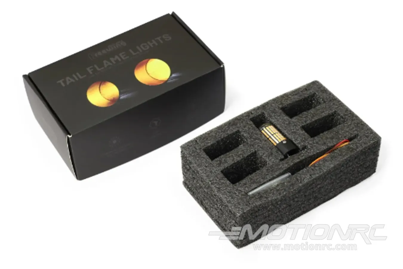

You could also add this small afterburner kit $16.99 for realism which might actually be a points event out your way .
