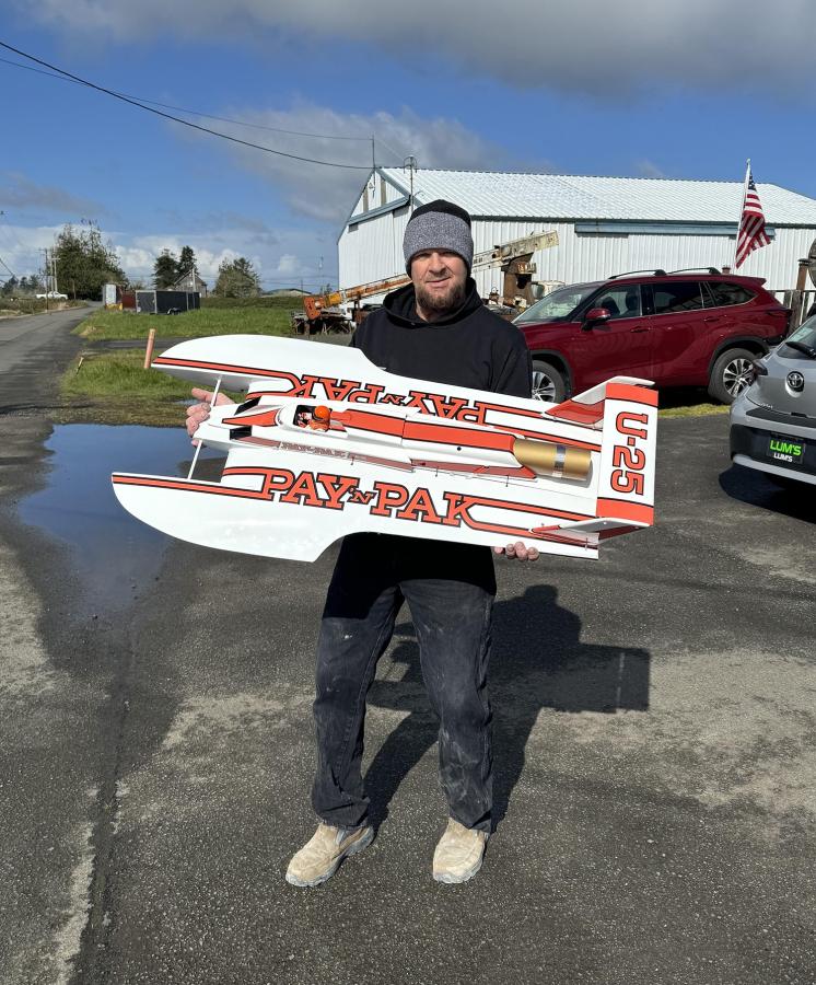

              • Got some pics of my painter holding my boat...He said he can't wait to see the maiden vid and I said that makes both of us!

                • U both have done an awsome job.. that first rooster tail just a little closer
                  • Thanks Ausie, can't wait!
                    • Aros SWEET! Looking forward to seeing it in action!

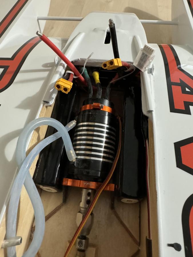

                      • What did Mike tell you for the COG? Most times It should be right around the turn fin. Have you looked at the dimensions for your batteries and the boat? Is everything going to fit like you want?
                        • Originally posted by Clugh View Post
                          I haven't asked about the CG yet but I was going to soon as I was just thinking about that. I haven't begun the process of figuring out the batteries/placement/receiver/radio yet. Once I figure out CG I'll look into what mAh LiPos I will be getting...I'll have to solder the right connection on to the ESC as well. There's only so much room with the motor taking center stage and the front section where the ESC is too small for batteries...It will be interesting for sure.
                          Oh, yes, and I still need to get the right prop for it.

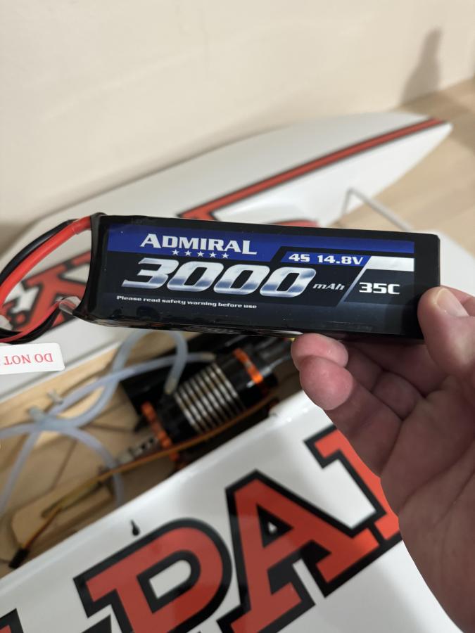

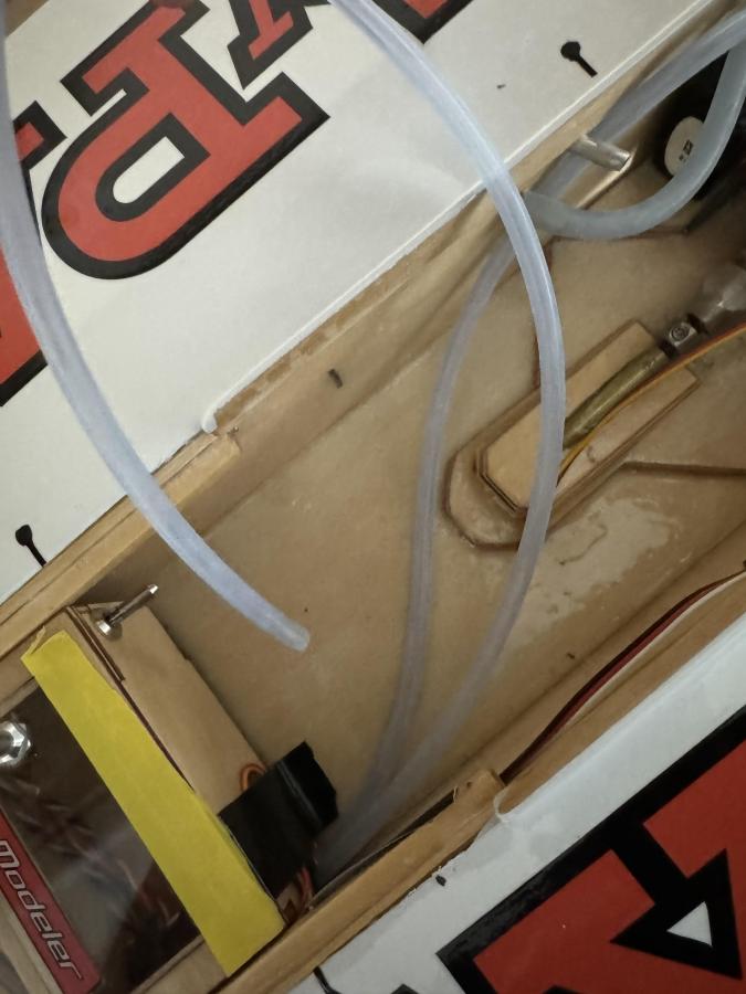

                          • I had some Admiral 4S 3000's lying around so I placed them besides the motor and it was a perfect fit. Which tells me I wouldn't be able to go much higher than 3000 mAh. I am confused where all these tubes go?
                            • Originally posted by Aros View Post

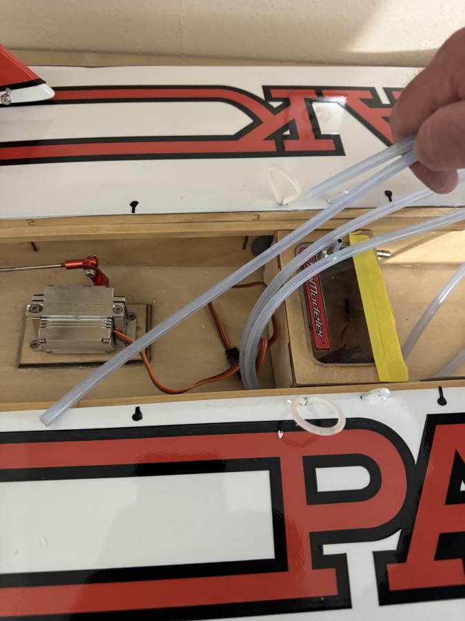

                              The water lines should start at the rudder pickup and in one way or another routed through the esc and motor then exits the boat somewhere..
                              Looks like u have plenty of room for batteries since another set can load aft of those for another 3000 mah in parallel. Id run as much as I could without adversely affecting a good center of gravity.

                                  As far as routing the cooling lines we can work through that here on hobby squawk. You have a good thread here. keep going...You wont hurt her... She is beautiful I know how you feel ....
                                  All we need is photos of all the bare nipples in the boat where water lines connect.

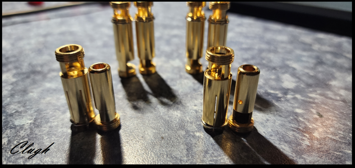

                                  • Thanks friend! I will take all kinds of photos tomorrow. I am going to heed your advice and go Futaba. Do you have a precise receiver recommendation? Also, there’s a hole for an antenna. Where do I get that antenna and does it somehow mount to the receiver in the waterproof box?
                                    Finally, those ESC positive and negative wire gauges look large. Can they solder to an XT60?

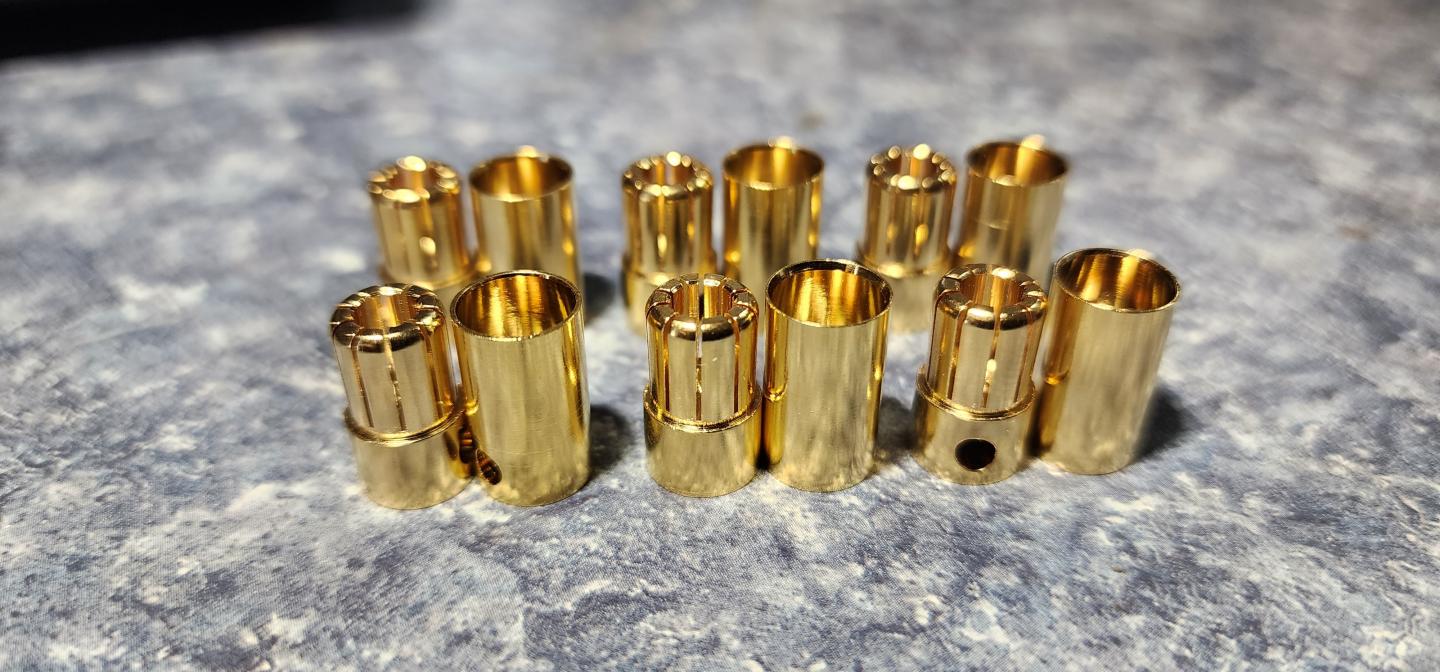

                                      XT 60 is out go ec8 or castle 6.5 or 8mm, If you really want nice go with AMASS
                                      • Click image for larger versionName:	20230309_144012.jpgViews:	0Size:	148.7 KBID:	400671
                                        Castle 8mm
                                        • A MASS 7mm
                                          Click image for larger versionName:	AMASS 7mm.pngViews:	4Size:	1.33 MBID:	400673
